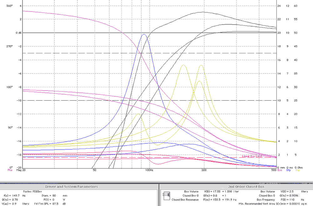

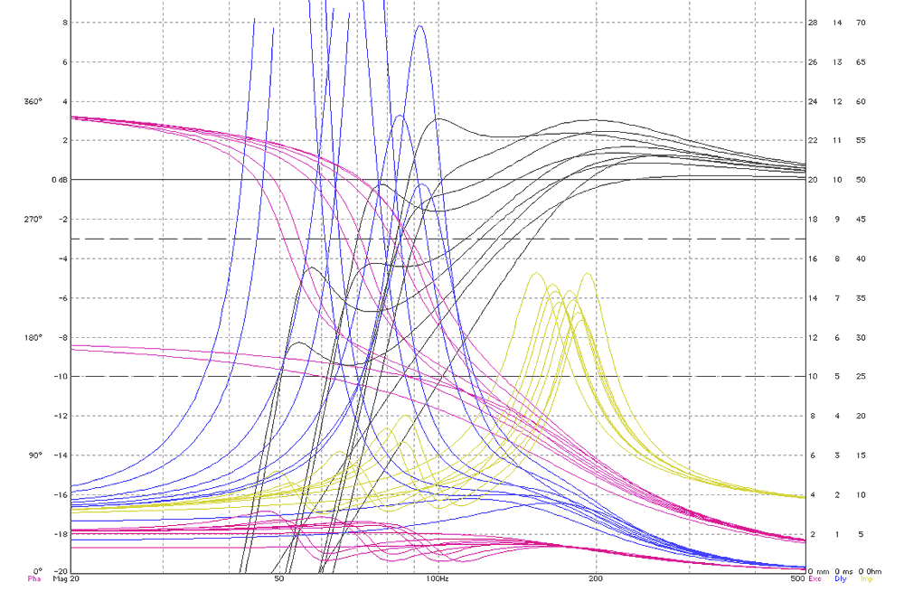

I’d say not suited to vented at all.
A series of sims: sealed, 5/2.5 litre reflex. A lot of ugly sims.
For clarity the sealed, and a not as bad as the rest vented.
Looks to be a good candidate for (big) sealed, or better yet midTL out the back.
dave

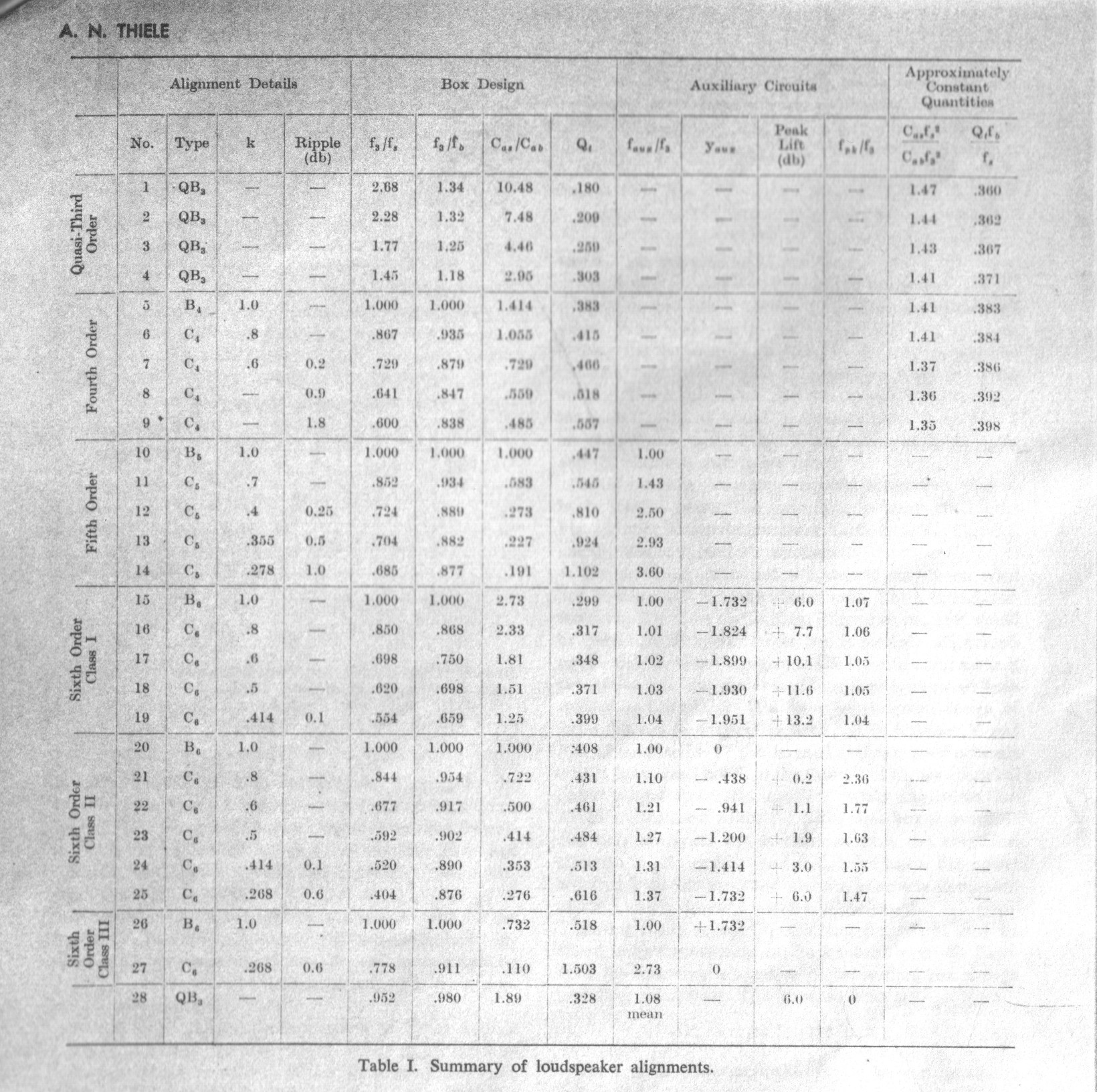

Do you know what BB4 stands for or where it originates? If it really stands for boom box, it is exactly what Thiele and Small tried to avoid.
This is Thiele's famous table of loudspeaker alignments with reasonably flat responses:
The fifth- and sixth-order alignments require a first- or second-order electrical high-pass filter somewhere in the signal path.
He also found a way to interpolate between the alignments (see the last two columns), so in that sense he did explore the continuum of alignments, and didn't even need a computer for it.
