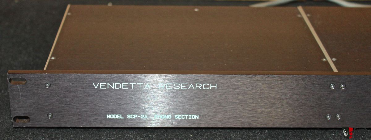

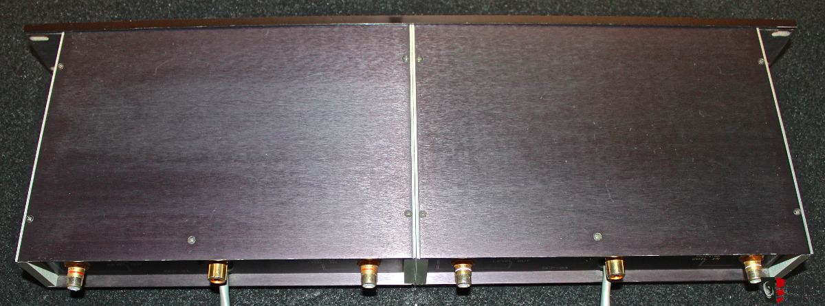

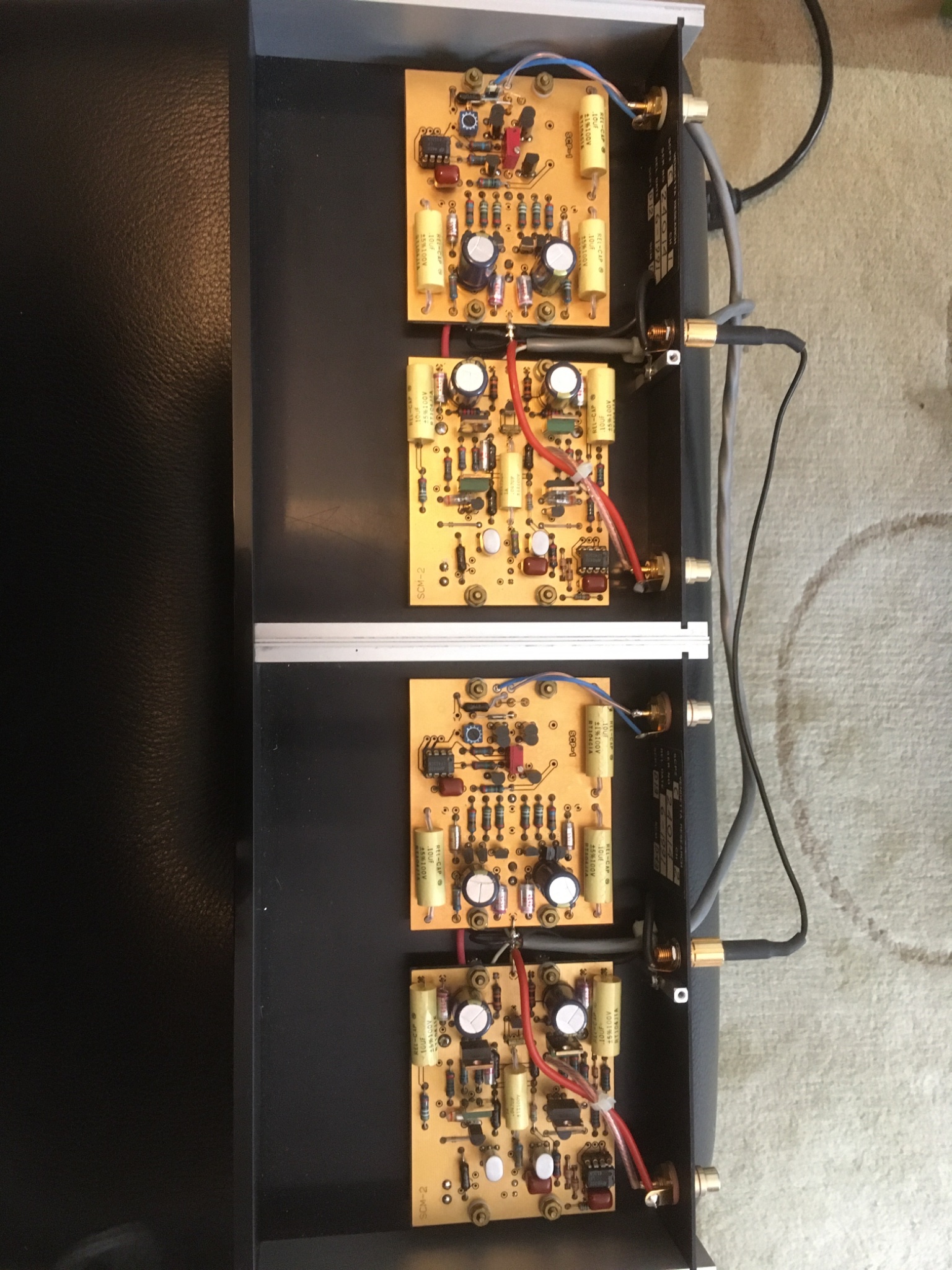

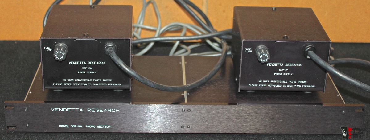

After 20+ years of searching, I finally found a Vendetta Research MC Phono Section. This is the SCP-2A variant in 4 boxes. I will show modifications / updates in this thread. My plan is to stay true to John Curl's original design while updating caps to get decades more life from this unit.
Current plans include:
  • Replace all electrolytic caps. This looks like it will cost about $30 + some tax and shipping
  • set loading to 100R (same as my PassDIY Pearl 2, Pearl 3, and RS Xono 2019)
I may get a single faceplate fabricated sometime in the future, that's not top priority.

I recall reading somewhere JC himself suggested to a user to not mess with anything unless absolutely necessary… looking at the components they are all the very best of the day and quite likely could not be improved upon. Did he also say that certain bits were tuned/tweaked to each individual build? I don’t remember, perhaps.
Your idea of taking a very light restoration touch to this almost 40yr old example of the most cutting edge engineering is a sound idea.
Reactions: rayma and mhenschel
It looks it might be improved from an EMI perspective - no RF suppression caps on the inputs and a large loop area on the input wiring to pick up magnetic interference. The former is likely to be an issue these days with all the mobile phones around - given this is an MC preamp perhaps 500pF ceramic to ground on the input and output connectors, and a ferrite toroid on the power supply cable might be useful additions?

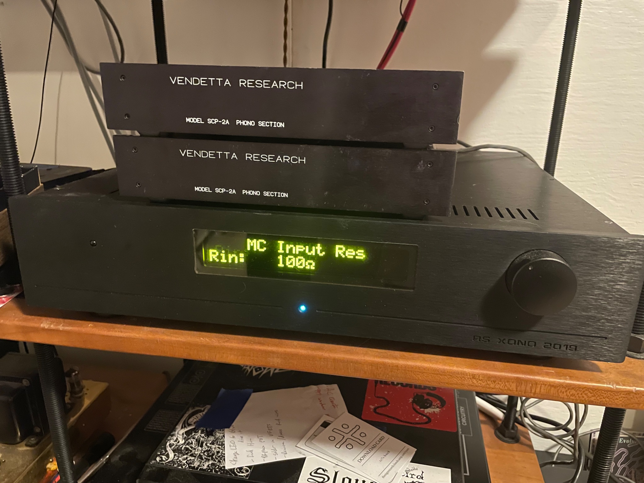

Quick update. After a few road trips and general business I finally got into the Vendetta. I set the MC loading to 100R (was 46R) and checked the power supply voltages. Everything looked good so I put it into my system without any mods. Long story short - WOW. All of the flowery descriptions I've read about this are true - quiet, black background, 3D, huge soundstage, organic. That confirms the approach I'll take to tweaks when I get to them - new electrolytic caps only.
I started a faceplate layout in FrontPanelExpress. I'm on the fence about getting it fabricated or not. Time will tell.

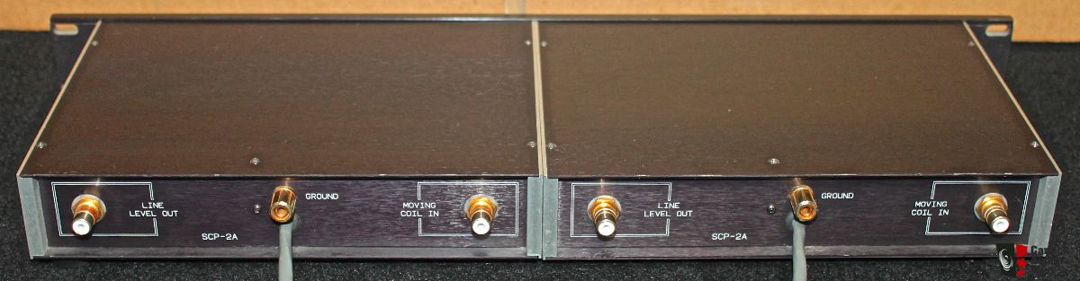

Vendetta PSUs are transformer, bridge, caps, standard 317/337 setup. I'm not sure about ground lift, that's one I'll look at when I re-cap.
I know when you don't tie the 2 ground posts together on the RIAA boxes it makes a nasty hum at the speakers. A short run of scrap wire fixed that right up.
The PSU umbilical cables are fixed on both sides, and appear to be unshielded. There are no switches, LEDs, or disconnects.
I don't know all of the what is employed in the RIAA boxes for low noise. There appears to be a star ground at the phono ground post. Similar to Pearl 2, 3 and Xono philosophy.
Does it use Cap multiplier(s)? I'm not sure. I do know a key element is hand matched and hand selected low noise JFETs. As I understand it the semis for this preamp are impossible to get now.
My Pearl 2 and Pearl 3 each use a single PSU. I'll likely go for 2x PSU in the P3. Maybe 2x regulated. Will it make a difference - time will tell. I see positive reviews on the P3 thread for going dual.
My RS Xono 2019 PSU is over-the-top crazy using fully dual-mono CLC then CapMX to other box with CLC to Reg. Far more complex than Vendetta, Pearl 2, Pearl 3, etc. Xono also has carefully matched JFETs and RIAA caps.
I suspect the magic of the Vendetta is the unobtanium hand matched actives (and other bits) and the circuit design itself. The power supplies appear to be pretty vanilla regulated units (good), but dual mono (great) and in separate boxes (good? great?).
Congratulations on a super-rare and super-desirable find!
Although it's economically unwise to modify a museum piece in any way, you might give some thought to replacing the rectifier diodes with soft recovery devices, and perhaps adding transformer snubbers in the power supply cabinets.
