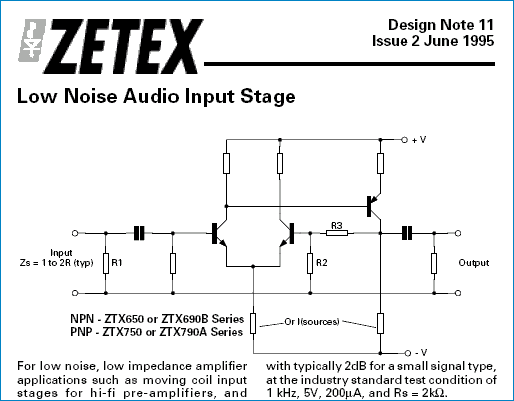

AndrewT said:try Zetex for low Vbe and low Vcesat
sandyK said:lineup
Have a look at the LM194/LM394. I understand that they are actually multiple transistors in parallel in both halves. They have a lower than average VBE, and VCE sat. is quite low at 1mA collector current.
Collector to Emitter IC e 1 mA, IB e 10 uA 0.2 typical
Saturation Voltage IC e 1 mA, IB e 100 uA 0.1 typical
SandyK. Thanks for info.
But as I think, the LM194/LM394 are very hard to find transistors.
Maybe even obsolete ...
But they are no doubt high class. Super Matched Lownoise Pair .. as I recall.
AndrewT.
Thanks. I will try some of my ZETEX transistor spice models.
And see if they compare lower VBE.
🙂 What are the Lownoise or General small signal transistor devices from ZETEX?
TO-92 standard/higher gain.
Suitable for low level audio circuits?
I see in this
ZETEX Application note from 1995
they use ZTX650 npn and ZTX750 pnp
Low Noise Audio Input Stage
http://www.zetex.com/3.0/appnotes/design/dn11.pdf

You were absolutely right about ZETEX small signal transistors.
For example when running low voltage simulation,
ZTX689B has got only VBE = 0.505 Volt at 0.5 mA
... this is low base-emitter voltage!

Maybe your model is wrong, as the datasheet shows 0.59V at 0.5mA.

my copy of the 689B datasheet (may'94) goes down to 1mA. Tc=25degC &1mA Vbe~=0.5VbeAndy L. Francis said:Maybe your model is wrong, as the datasheet shows 0.59V at 0.5mA.

AndrewT said:my copy of the 689B datasheet (may'94) goes down to 1mA. Tc=25degC &1mA Vbe~=0.5Vbe
AndrewT.
ZTX689B is the device I have put into my low voltage opamp.
It now has been simulated to work rather well at +- 0.500 Volt supply.
The VBE drop is like you say 0.490 - 0.505 Volt.
At least in the spice models I have.
Of course I run my transistors at low currents:
150 uA and to max 500-700uA for the output stage
It is a convential basic opamp =
1. Input differential NPN LTP, two ZTX689B, fead by CCS
2. Current mirror on top: Two ZTX718
3. PNP VAS=OUTPUT .. right now ZTX718 .. fead by CCS number 2.
Of course use Output from Collectors.
To achieve output like +- 400 mV peak at PSU 1.0 V Battery.
4. Both current sources uses ZTX689B with that low VBE drop
