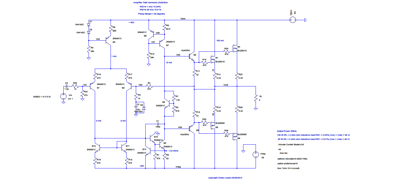

Hello everyone,
I've made this design that is based on one MOSFET amplifier by Bob Cordell, but I've a question to do, the transistors Q7 and Q4, seem to have a high power dissipation, this type of package (TO92) are intended to operate with powers near 0.6 W, but the dissipation required for Q7 and Q4 is about 0.45 W which is near to 0.6 W, this could damage the transistors, I should replace those transistors or there is some measure to prevent transistor overheating?
Thank you very much for your attention,
Best regards,
Daniel Almeida
