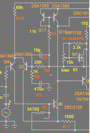

Hi all. I am searching for a transistor pair faster than MPSA42/92 which can handle 250 volts and at least 10mA. I think the 2N5401/2N5551 are good to 150 volts, and I don't know how fast they are. Actually, I would like a pair to replace those 2N's as well in order to speed up the differential input stage, hmm.

Thanks for your answers. I am also considering the 2SC3334/2SA1321. Those are two 250 volt types I have since found to exist. But they may be a little slow, I am not sure. If I go with 160 volt transistors, the power supply has to be less than +/-70v. Actually, only the NPN on the lower rail should have to swing the full power supply voltage plus an extra 12v.
Edit: No, the complement comes close to swinging as much voltage as the NPN one. The PNP one needs to handle as much as only several volts less than the NPN one on the lower rail.
Could you post a simple schematic of your input stage?
I couldn't imagine why an input stage should have such a huge voltage swing

I happen to be using some floating supplies, but more for the purpose of supplying more current more efficiently. I have included the first half of the amp circuit which is not too extraordinary topologically, I think. The PNP transistor on the right is for the CFP output stage. It must swing the full power supply voltage as well as Q6.
Depending on the output stage topology, Q6 and Q16 may have to swing the full |+Vcc|+|-Vcc| range, but there are classic solutions like using fast 50-60V transistors cascoded with BF871/872 or similar
You could place two couples of series antiparalell 1N4148 or similar across C2 to prevent the capacitor and the input stage to track te output in DC and blow in case of any amplifier failure causing the output to latch to positive or negative rail
You could also place a simple capacitor in paralell with a zener, a resistor or a Vbe multiplier, or a cascode, in series with collectors of Q3 and Q4 to reduce its working Vce allowing to use fast 50-60V transistors
Using a big capacitor requires the supplies to rise slowly to prevent overvoltage across Q3 and Q4 so this has to be handled with care
Beware of cascoding, it's an evil technique since it allways adds some delay to the signal path and reduces phase margin, independently of possible THD reduction or higher bandwith due to less miller effect

It seems, the possible solutions are well explained already.
If you want to go without increasing the number of transistors, you essentially can't get high beta and high VCEO.
For high VCEO devices with still fair beta, I'll suggest KSA1381/KSC3503 or (2SA1381/2SC3503).

Thanks. I think the 2sa1381/2sc3503 are going to be the best option since that makes a simpler circuit with lower parts count and should ease construction. I may try them as input devices also to see how the operation of the circuit is affected. The problem of over-voltage in case of amplifier failure, never thought of that one either. DC output from shorted power transistors reminds me of the days with the old Tiger amp.
