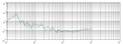

FWIW, here you have the distorsion graph of the 3 way dipoles. The mid driver is a 38l Vas. Don't trust the bass part, as I suspect the active filter is to blame of the most of it. I still have to check if there is interstage clipping. I don't have a calibrated mic, but the volume was double than for normal music.
