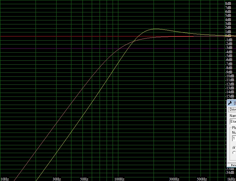

Hi....I have a question...how to calculate Enclosure volume when we use lets say 4" fullrange with VAS 2 liter and 6" sub with VAS 8 liter in same enclosure.
Does a VAS of FR change when we put a high pass filter on full range driver?
Hormilo, you shouldn't share the volume that way.
You'll end up with the smaller radiator becoming a passive radiator to the woofer and vice versa. That is, imagine a low frequency signal. 20 Hz to 40 Hz coming out of the 6" driver. That signal will end up coming out of the 4" driver as well, without much control (using common alignment techniques) of the delay or phase of the output.
You must put each one in it's own enclosure to maintain any sort of predictability or control over the design with commonly accepted practices. I read (briefly) the link GM posted. It seems you can do this, but what a bunch of additional work, for what seems to me a purely academic, and not very useful, result. I mean, cool, but who would want to? Among other things, the additional radiated output will eat into the Xmax of the individual drivers, reducing your maximum output. I could see this reducing the midrange's maximum output by half or more due to the excursions required as frequency decreases. Not a compromise I'd like to make. 😀 😀
Sreten's commens are correct. If you can electronically cut off the 4" high enough, or use a high pass filter to compensate for the rising FR bump the actual volume of the cabinet may be greatly reduced from the ideal.
I use WinISD as a quick way to examine driver behavior in different cabinets. Here is a couple of exmaples with the Eton 5" 5-200/A8/25 driver, the box sealed box WinISD recommended box is 3 Liters. However, if I force the volume to 1 liter, the response isn't much difference until around 800 Hz. If that's going to be my low frequency cut-off, then I can deal with the amplitude rise in the Eton's high pass filter.
attachment.php
If you use XSim, and circuit blocks, you'll use a high pass filter with a Q less than 0.7 to compensate for this, rather nicely.

While I think we all get your question, for the record I wanted to be complete.
Vas is a speaker driver parameter. As such, it is independent of a cabinet, crossover or other drivers. It is the volume of air that the suspension equates to. To quote Wikipedia:
the volume of air which, when acted upon by a piston of area Sd, has the same compliance as the driver's suspension:
So really the only way to change the Vas is to alter the driver itself, or get another driver. Your questions were not about altering Vas but calculating the cabinet volume when multiple different drivers are used.
