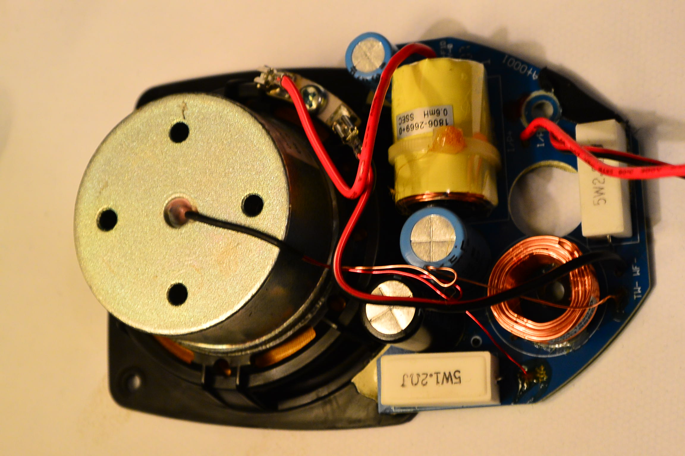

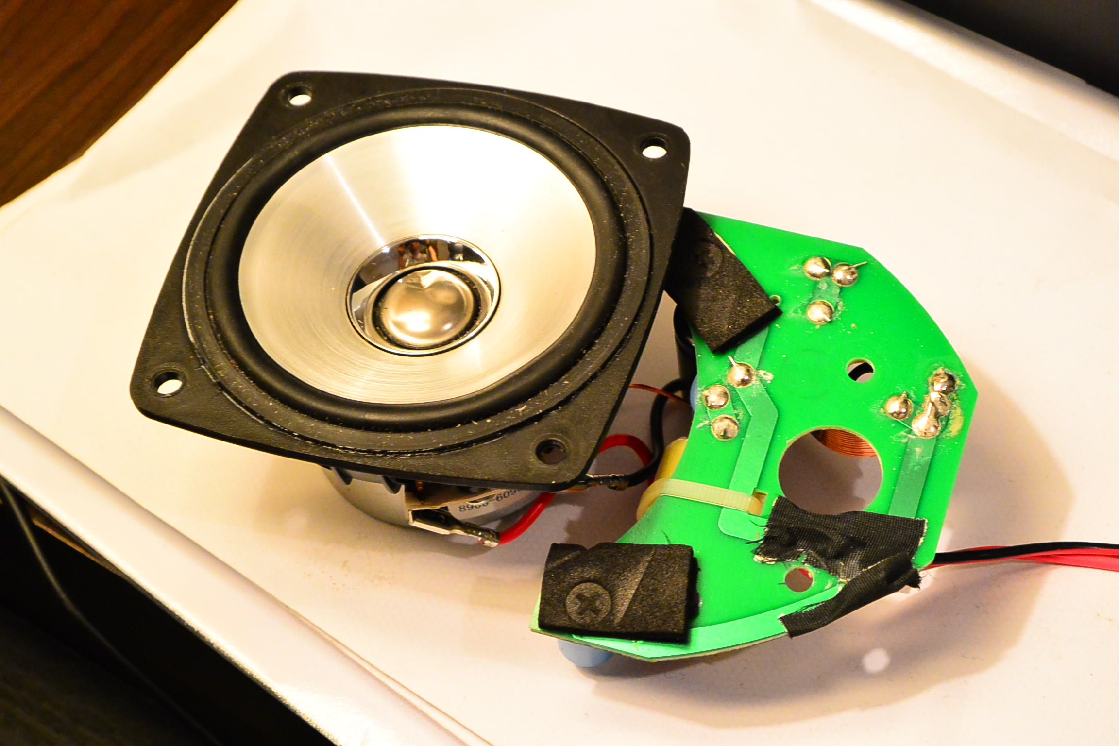

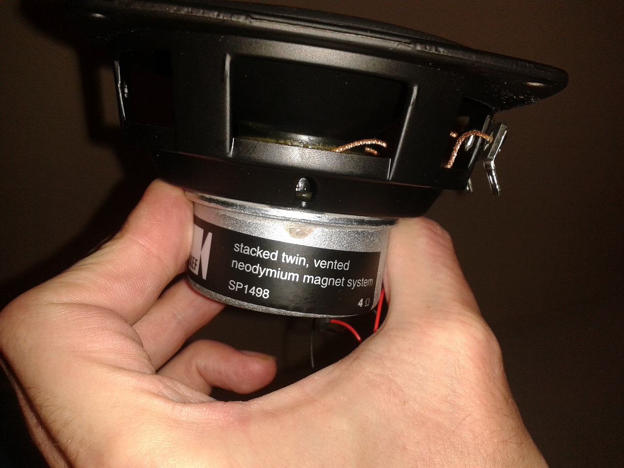

KEF UniQ SP1498
Here are some pictures of the KEF 'Egg' 2001 dismantled and close up of the SP1498 drive unit.
These drive units are also available in Black enclosures and the drive unit has a black cone - I've not managed to find any for sale as yet.....
These 'Eggs' can be found on Auction sites for as little as £20 ex postage, I have seen them for sale NIB as singles for £75 / £80, 'Bang for Buck' is high even at the upper end, shame about 'That CHUFFING pipe'.

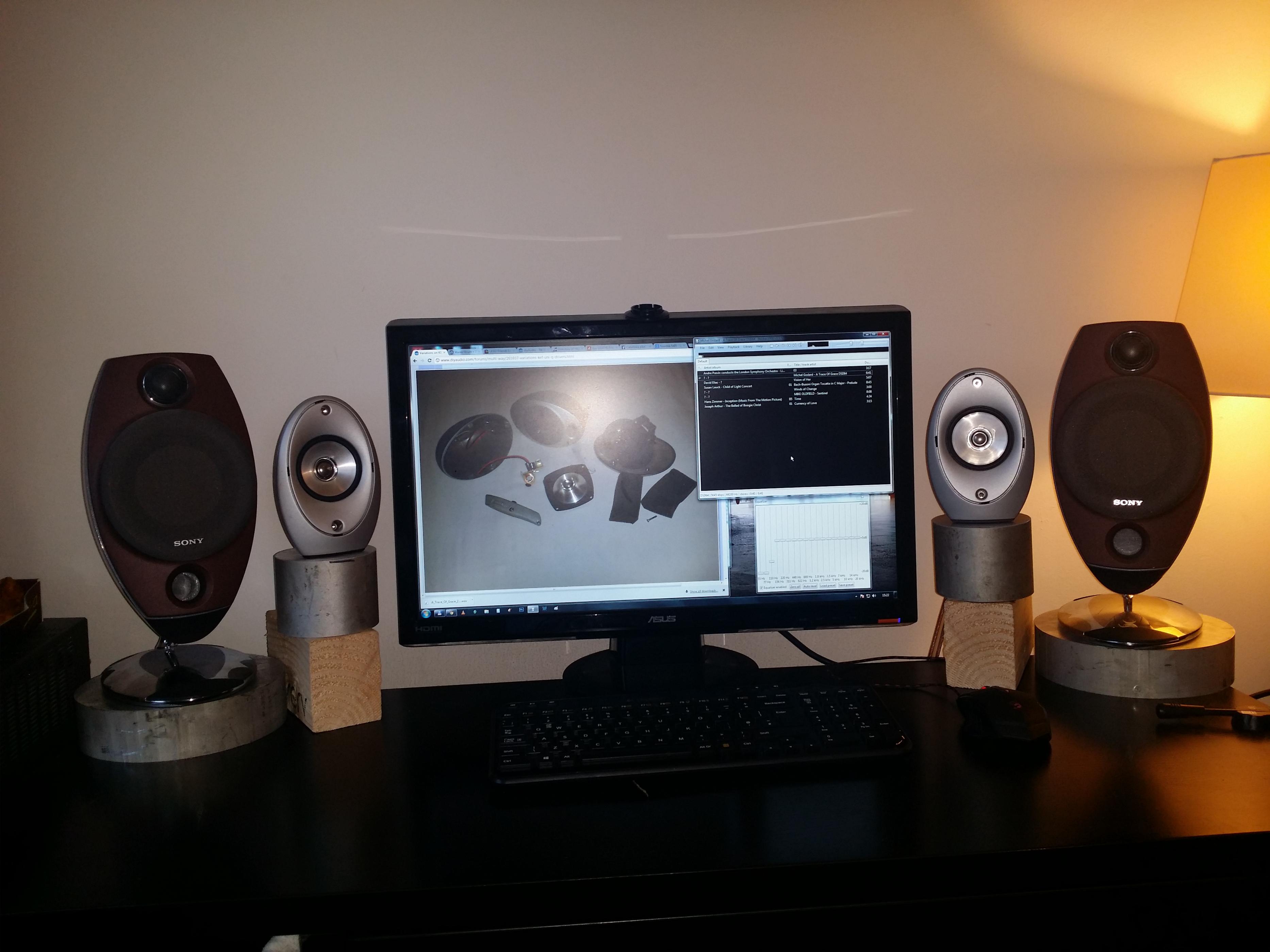

Of course its OK with me Sippy, them more we share the better.
I will stick to the "uni-q up front+side firing woofer" concept of mine, want to keep it narrow for placement near the pc monitor, and will keep probably the 75mm unit. I think I end up buying new units from KEF (45 punds per one unit) as new is new isnt it 🙂
Picture shows you how near they are, the table is not so much deep as normal pc tables. Honestly not missing that much bass, I know when it will be there it will be different, but the imaging is pretty spot on, depth also...
Note the "higher-end" speaker stands 😀 both alu discs for the egg enclosures to be used later + the wooden block courtesy of my work place scrap bin 😀

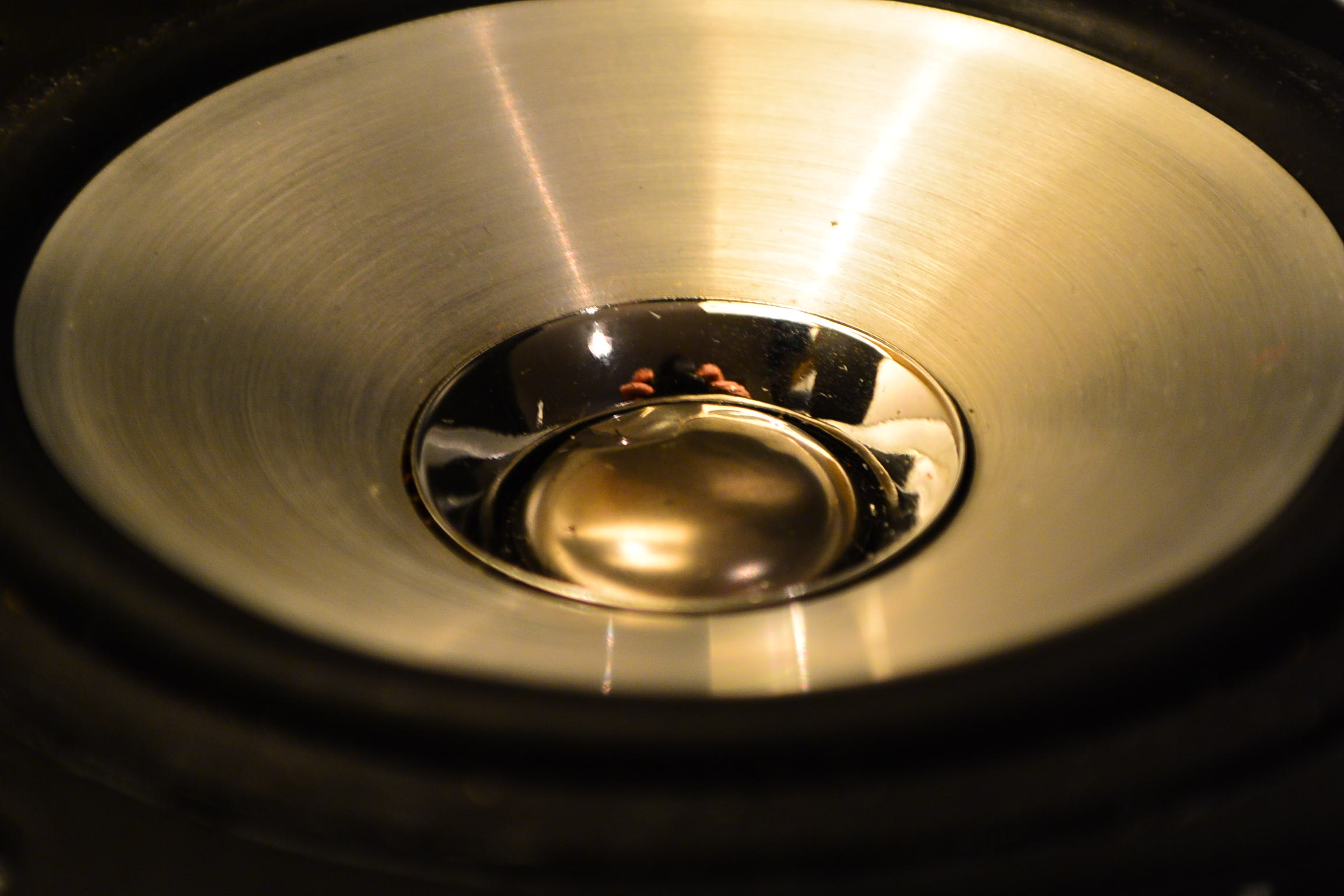

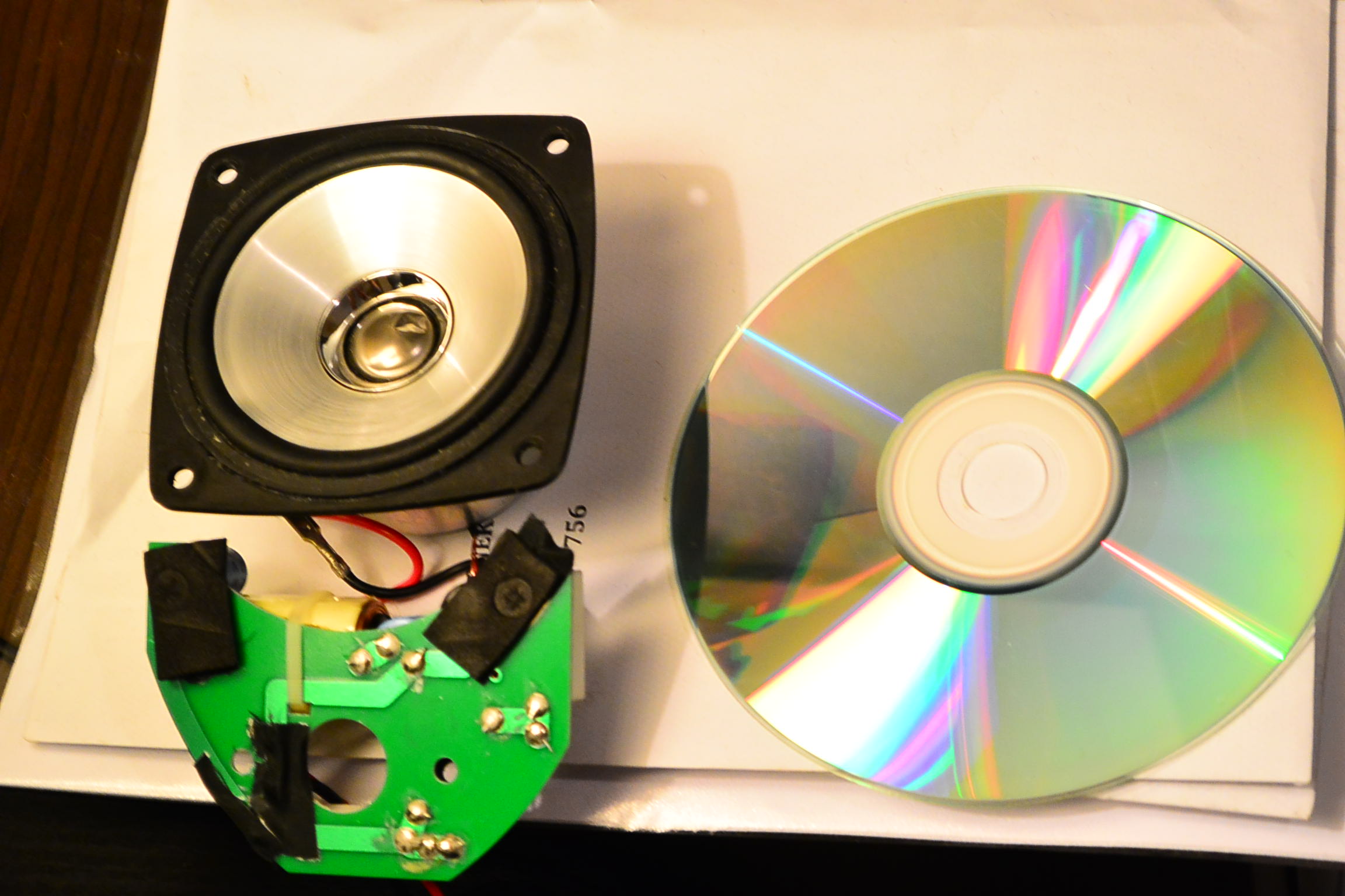

To show of the naked driver....
here you go 🙂
Yes I know there is a dent on the tweeter....thats why I asked KEF if they stock the units...
Danny
here you go 🙂
Danny
Apart from the dent in the tweet, they look like they have had a very hard life, I say this because of the step between the mid cone and the tweets metal surround.
Would be interesting to see a fresh run in unit's response curves v's well worn unit of either size.
They's pretty looking things, I find I get quite mesmerized by mine 😀😀
I have the same opinion. They had a lot of "smokers mush" on them when I got them. Thats why dirt cheap. Took me 30min to clean up the cones. Only got them to see whats all this "Dual-concentric" and "Uni-Q" rave is about 🙂
