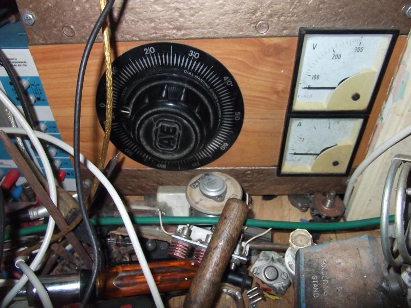

I'm about to build a similar unit as soon as i source an enclosure. My parts list is a dual pole toggle switch for the output, a neon indicator,two panel meters for voltage and current, and a fuse.
I am also pondering the idea of being able to switch in a current limiter, but i already have an inline lamp contraption for that.
It is well worth fitting meters and fusing on the output but don't worry too much about the input.
The neon indicator is on the isolating transformer this being the best safety feature you can add to a Variac.
The bench needed tidying when the photo was taken😱

Without a current meter, a variac is crippled,, in my view.
The dial is close enough, but it only shows what comes out if it is calibrated, AND the input is exactly 120v (or whatever your nominal mains voltage is) A voltmeter showing output voltage is important to me.When I test a circuit, I watch the current as I dial up the voltage. If I see the current ramp on tghe meter, I back off immediately. WIth current and voltage meters side by side, I can see both.
For me having the variable outlet is a necessity, but I also like having a non-adjustable convenience outlet as well. For example, I could power a heater supply on the convenience outlet, and vary only a DC supply with the variac. Both would turn on and off with the variac power switch, but only the one is adjustable. That is just me.

an AC analog current meter is essential * gives fast response in case of faults
voltage meters are useless i usually put a couple of tape marks ( infact you just calibrated it ) on the dial for voltage.
also a resettable breaker isn't that expensive about the cost of a 1/2 box of cheap fuses.
