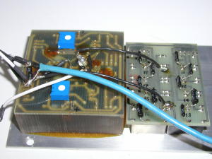

variable gain
Rod Elliott's Project 01
http://sound.westhost.com/project01.htm
has a topology for an active volume control with high input impedance and positive as well as negative gain, that can be used as an input buffer, and here is one by Siegfried Linkwitz
http://www.linkwitzlab.com/images/graphics/preamp1.gif
I have buit the Linkwitz version, using it as a volume control in my preamp, and I like it, I have the impression to get better dynamics than with a passive volume pot in front of a gain stage or buffer. Also this is the only "gain stage" in my preamp.
An inverting stage as by schematics above can take a variable source impedance (to control gain in the feedback) without much penalties - the only one I can think of is that you need an inverting buffer at the other end, that can conveniently be your output buffer. I never quite understood why the topology of a passive divider (read, volume pot) in front of a non-inverting op amp is so popular when at the same time for any other non-inverting op amp stage you're supposed to match source impedance to the // Z of the feedback R's - so you do all this adjusting with your circuit and then at the input of it all there sits this volume control pot with variable Z(in) of say, 0-20k in front of a non-inverting buffer.
With an inverting stage, varying source impedance to adjust gain will get you less distortion and less bias current mismatch compared to a highly variable source impedance in front of a non-inverting stage. Or so I read in various application notes, op amp data sheets, and all.
These above topologies can be adjusted to your needs in terms of gain spread. Just recalculate. Other gain adjust circuits:
http://www.linkwitzlab.com/filters.htm
look up item 10.
The sound quality differences due to variable loop gains, at these gain spreads (say +/- 6 dB), and for an inverting stage, I would doubt you can hear it. I certainly can't hear a change other than volume ;-). I think you gain much (sic) by having one input buffer with a defined input impedance and a later, inverting active gain control for level matching. I think this is a much better trade-off than using a passive divider.
