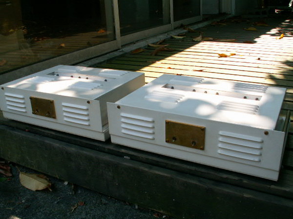

GRollins said:like something
Dieter Burmester's 828.
Damping factor altered from 200 to 100 with a back row toggle switch, see picture.
828 = 82-8 = august 1982. The updated MK-II is from 1986.
