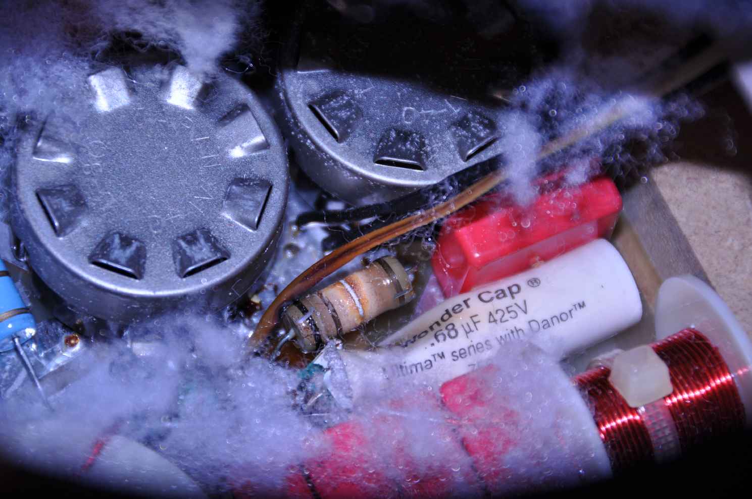

I'm trying to repair the crossovers in a pair of Vandersteen 2ce's. I'm trouble identifying the value of the resistor in the attached crossover photo. Does anyone have a working crossover for these speakers that they could look at and let me know what the resistor value is? Any help would be appreciated.

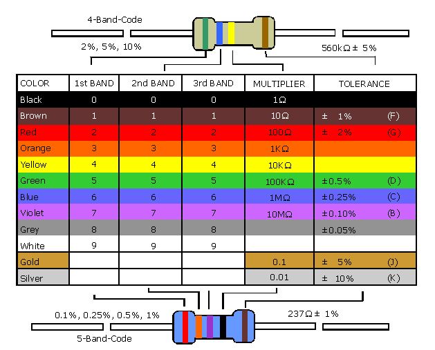

Either you read between the lines of what Ray Vandersteen is saying and fit 10 ohms and hope, or trace the schematic where form follows function. Hard to say if this is 1 or 10 or 100 ohms since the multiplier on black-brown-?-brown is discoloured.
Certainly a 10 ohm-0.68uF would make sense as a tweeter Zobel shunt. Replacement with 7W wirewound would make sense too, unless this 1W resistor is designed to act as a fuse.

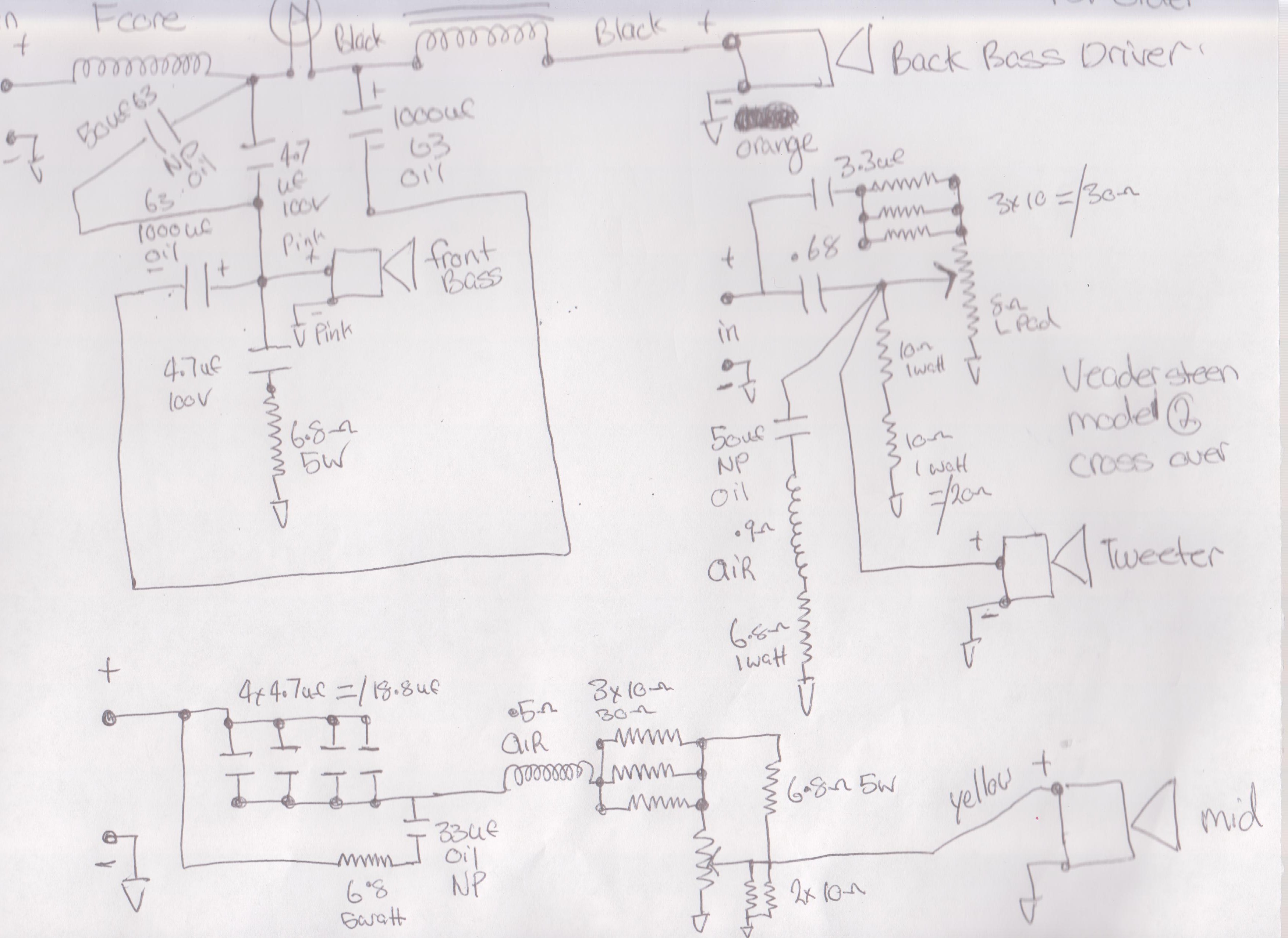

I ended up using a 10 Ohm resister on mine as well. Both crossovers had the same burned resister so I couldn't determine the original value from either.
I ended up prying the board that the crossover is glued to off of the back of the speaker. Then carefully pried the crossover off the board. That took a bit of force and time as it was really glued on there.
I'll post the circuit diagram later since I don't have it available right now.
Once I was able to trace out the circuit I discovered that the burned resister was not what was causing the speakers lack of bass.
The thermisters for both crossovers were activating at very low value levels and causing the bass to get attenuated and the LED's to flash. There weren't enough markings on the thermister to determine a replacement so I just bypassed it (eliminating the protection circuit). I also replaced all the caps with better quality but similar values and replaced the burned resister with a 10 Ohm one.

Thanks for the schematic of the Vandy 2Ci woofer circuit. Unfortunately we cannot see the whole thing, the photo cut off the top of the schematic. You mentioned a thermistor, is that the yellow round thing? I am also rebuilding the crossover and that is the only thing that I have not been able to identify.

The photo in post #1 is of the crossover and not a schematic. Forgive me if I over describe it, the two silver round things with vents are the backs of the potentiometers that adjust the crossover frequencies, to the far left in the photo is a blue cylinder that is a resister, in the middle of the photo is a brown cylinder with a blank, brown, white and gold bands on it, that's another resister, the red rectangle to the right is a capacitor, the white cylinder with the words "Wonder Cap" on it is another capacitor, to the lower right is a white spool with red wire, that is a coil, bottom middle under the fuzzy insulation is a row of red rectangles that are all capacitors and bottom left is the white from the spool for another coil, and running through the middle is a wire that overheated. I don't see the yellow round thing you mentioned. The thermistor is not visible in the photo on post #1.
