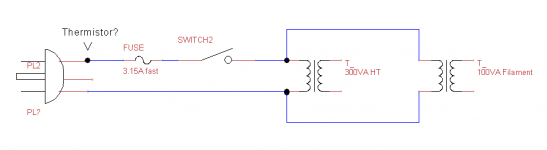

I have just finished my new valve amp and I am now aware that there is a large inrush current.
Here the HT is connected to a GZ34 and then CLC, and the filament supplies a Rod Coleman regulator.
The question I have is, can I just add a thermistor straight after the plug (as shown above), and if so, can someone tell me exactly which thermistor I should use?

Only if the inrush is too high, usually tube circuits doesn't require such a limiting current devices.

I think the culprit is the second transformer as the gz34 takes care of its own current. The second transformer is about 0.2 amps but I think the inrush is around 3 amps. I am going to try a CL-60 on the second one and see if that reduces the current.
If you amplifier uses a rectifier tube, then there is no inrush problem to worry about because the tube's slow turn on time eliminates that, 5U4's included. If the amp has S. S. diodes for the rectifiers, then some inrush limiting is needed. A PTC thermistor or a timed relay shorting out an inrush current limiting resistor are the usual fixes.
400VA of transformers may result in occasional current peaks of 50A or more, mostly for the first 1/2 cycle, depending on the phase of the AC at turn-on and the amount and direction of any remnant magnetism in the core from its last shutdown. Your lights will flicker, you'll hear a thump, your 3A fuse will blow! An inrush limiter (CL-60 is good for 5A continuous) and a slow-blow fuse of 1.5 times the actual current will take care of this. Transformers of a few hundred VA have enough DC resistance that this isn't a problem; transformers of 500VA and up will do this, even with no load. And charging a 40 uF to 400V takes about 3 Joules of energy; 50A (half-sine) x 240V x 10 ms = 60 Joules, so this dwarfs the power supply inrush, though it only occurs perhaps one of twenty turn-ons.

Thank you all for your patience. I have learnt that the GZ34 will mean that the first transformer should not have a big inrush current, whilst the second that drives the heater regulator should also not cause one. I was using a fast blow fuse which I now understand to be the wrong choice, so I have some slow-blow fuses on their way.

Tube circuits don't need usually fast blow fuses because there is always a normal initial pike current because: 1- heaters are cold and their resistance is low, 2- transformer is demagnetized and 3- (eventually with ss rectifiers or short heating time of the vacuum rectifier like 5U4) must charge the filter caps.

Heaters are usually limited by the max transformer current.
This is fine so long as the transformer isnt grossly over rated.
