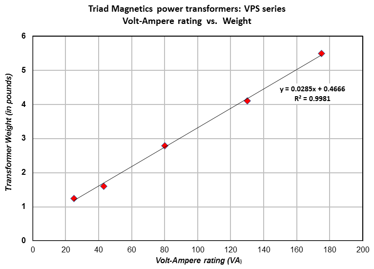

In a different thread, (this post) presented some data showing an excellent correlation between weight and VA rating - at least, among different transformers in a single product line from a single manufacturer. I copied its plot below. You could add more datapoints from other mfrs and other bobbin arrangements, if you wanted to get a feel for the variability of the relationship.

Obviously, they are always approximate, because you have no way of guessing the insulation class, or the quality of the materials and other factors.
In those conditions, it is better to stay on the safe side.
