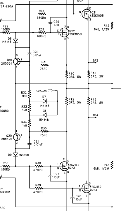

I have a few 'noob' questions on the attached schematic part:
1) How to allow for larger voltage swings before the limiting comes in : enlarge R31 & R35 a bit I guess, that's what I figured out by myself. (act on higher voltage)
2) What are the purpose of C20 & C21? What happens if I increase the value? (if they're put in to prevent oscillation locally then I'm clear 🙂
3) How can I make this limiting circuit allow for large transient peaks? (add a time delay, not the same as 1).

lucpes said:2) What are the purpose of C20 & C21? What happens if I increase the value? (if they're put in to prevent oscillation locally then I'm clear 🙂

V/I limiting can affect sound quality, depending on the implementation...
As people pointed out, it will oscillate when active.
But, when inactive, it acts as a nonlinear shunt capacitance.

What was the previous value of C20 and C21?
I think that the basic flaw found on these simple current-limit circuits is that when one side reaches current limit threshold and the current limit transistor is turned on, the base drive of this side is shunted to the output and this means the base drive of the other side is boosted since the Vbe reduction applied to one side gets copuled through the Vbe multiplier [or bias reference] to the other side
This may effectively make the output swing in the opposite direction for some time causing obvious oscillation, and may also cause cross conduction if the other side turns on before the current limiting side had enough time to turn off. Osciillation is made worst by adding capacitors and because the output current varies very slowly due to loudspeaker inductive behavior
In these circumstances, I recommend shunting both upper and lower base/gate drives to the output at the same time independently of the polarity of the limited current. This just bypasses the output stage and leaves the VAS driving the load directly so unstability is less likely to happen. VAS should include local current limiting and output stage must include freewheel diodes to prevent it swinging past the supply rails when limiting complex inductive-capacitive loads
Another flaw is that there is no easy way to prevent excessive dissipation during short circuit and to know if the current limiting is being activated or not, so you may end hearing unexpected distortion without knowing where it's generated. To prevent this it would be a great idea to use a timer to maintain the base drive shunted for 250ms periods [or so] trying to return to normal operation at the end of each period and lighting a LED while limiting is on
The current limiter may end having as much complexity as the rest of the amplifier

@Eva: C20 & C21 are 10nf. Basicly, I'm limited to the same three questions in my previous post, I don't have the abilities to alter this drasticly.
@Angel: To do it in the PSU seems to be a bit tricky (at least for me), I have 3x10.000uf per rail and 1KVA trafo in hooked up with large gauge wire. Flyback diodes are present on the output as far as I can figure.
@thanh: Don't take it personally, but your posts are sometimes too short - be more specific 🙂 Did you simulate/are we talking about the same circuit, etc...
The limiting circuit is from Randy Slone's OPTI-MOS v. 04 amp (I have a mail from him allowing me to post the schematic so here it is). I did not include the part for 'overload' which connects to the part of the circuit in question.

I have simulated this protection circuit . The sim say that it is all ok. And I built it ,my amp has "aw aw...aww" sound. Can you understand? .I removed these capacitor and the hell sound is hide😀 . I see that if you built these capacitor and you're not lucky , your amp will not failure instanly . When you increase vulume very much , your amp can die or nor die😀
