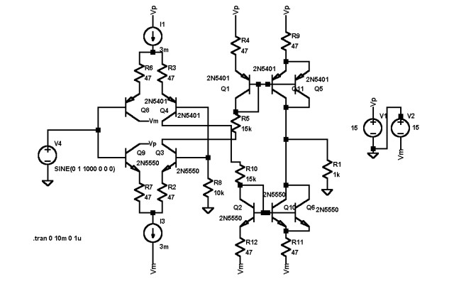

Hi Simon,
Any differential pair is actually a voltage to balanced current converter. The only problem is that the input voltage range is very limited without emitter or source degeneration. The link gives an overview of several techniques to increase the input voltage range and the linearity of voltage to current converters.

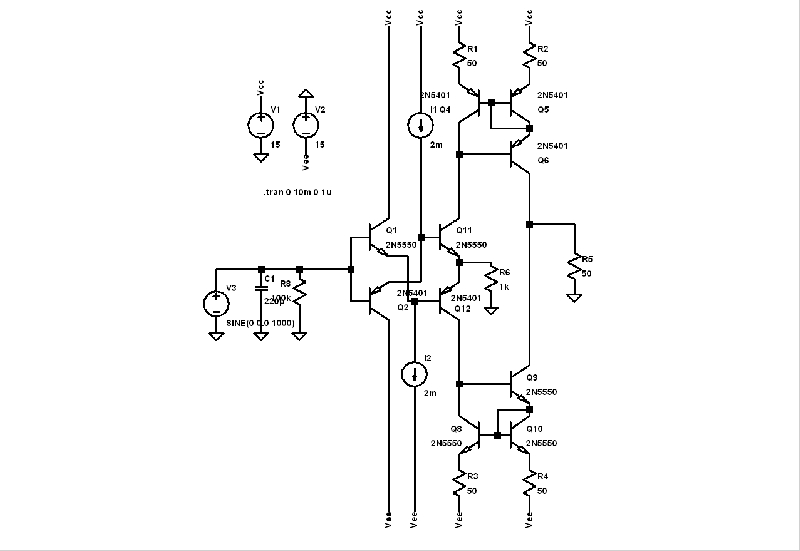

yeah, i had a look at the lm13600.
Performance is awful.
I realy need a hi-fi type.
The goal is to see whether audio can better be transported via an normal buffer (Vin/Vout) or transconductance amp (Vin/Iout).
I did some simulations on 2 types of circuits. topology is quite the same , and so are the result (disappointing).
Circuit is realy working perfect, but the 2nd and 3rd harmonic are a disaster.

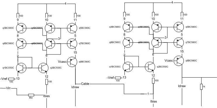

If it is for current signal transport between devices i have seen a discrete version in a Swedish hifi magazine (High Fidelity) many years ago.
It included a "transmitter" and "receiver" which was in fact a V/I and I/V converter respectively.
Cannot remember if i have the article still, will check but i promise nothing.
In fact if you take the Yadis in the digital thread and terminate the input voltage via a series resistance. Remove the parallel output resistance. Take the output to another yadis input stage with normal configuration you would have a working setup.
This is just to show an example.
What happens if you use a high quality nmos transistor on the output as an emitter follower and a current sink. The other end is terminated in a opamp based IV stage?
If this is not what you are looking for then i am sorry.

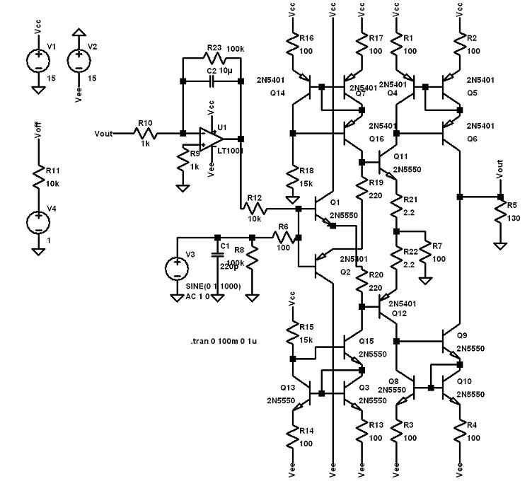

I've seen transcoductance amp, current conveyors and etc etc on my search for the VI converter.
The current conveyor is most promissing i think !
Unfortunatly i can not get the bias right. Any one ?
Most worrying to me is what to do with the input where R6 is connected to !
grtz
Simon

Hi Simon-Thijs,
If this current conveyor is your transmitter, then leave out R5 to get a nice current source output with high impedance and good voltage compliancy. R6 is the voltage to current conversion resistor and should be connected to ground (as shown). This will give you a bipolar single-ended voltage input to bipolar single ended current output. With R6 is 1k (as shown) 1V rms in gives you 1mA rms out.
For the receiver you can use the same circuit but use the other input. That means making R3 zero and applying the signal current, coming from the transmitter, to the emitters of Q11 and Q12. Leave out R6. R5 is the conversion resistor from current to voltage. If R5 is 1k, then the output voltage will be 1V rms again.

Simon,
Your post was a very common topology of current mode op called CCII. It's a class AB design with high bandwidth and low noise. But, the problem is low CMRR and low PSRR of this kind of circuit. And, it contain potential unstabilization in high frequency in this circuit due to standard wilson-CC emploied.
In the other hand, this CCII circuit contain potential accurate degrade by input stage.

Thanks Steven , i keep being amazed by your knowledge !
Found some nice documents of the CCI and CCII on the net.
I managed to set the DC output voltage to 0 via an intergrator.
To bad. Its equivalent circuit wherein the Q1 and Q2 are switched (see Per Andersons diamond buffer) the DC offset was 0.
