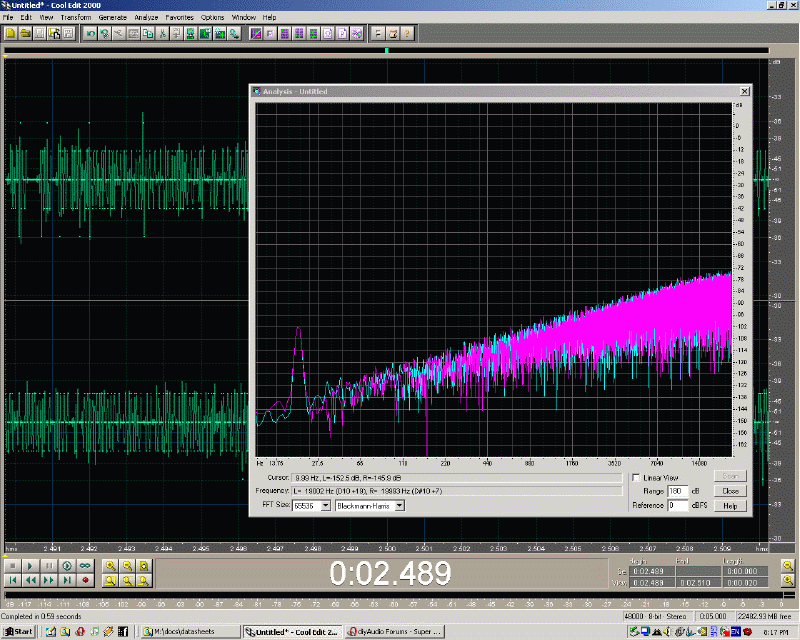

Here is an idea that's been floating around in my head for a while, and I would like to get your comments on it.
The idea is to use one of the many video-DACs that runs at more than 100MHz with resolution from 8 to 16 bits. The 24-bit audio would be oversampled by a very large number, say 1024, from 48kHx to 49.152MHz. Then dither would be added, and the result truncated to the DACs width of say 8 bits. The dither would need to be noiseshaped, but since the oversampling-ratio is so high, the noiseshaping function could be first-order. Now all you need is a first-order analog filter after the DAC to remove the noise above the audioband.
This approach is different from a multi-bit delta-sigma DAC (PCM1792,AD1955), since these DACs often use very high-order noise-shaping.
Pros:
-Video-DACs have high output current, 20mA differential, ensures good SNR.
-Video-DACs are designed to be used with a simple resistor as I/V converter, no need for fancy op-amps.
-Video-DACs have an externally adjustable reference current, this can be used for volume control.
Cons:
-The extreme oversampling would require an FPGA which is expensive and not DIY friendly.
See here for an example of a video-DAC.
I used a 20Hz sinewave sampled at 48kHz to illustrate what a 20kHz sinewave would look like when sampled at 48MHz. A sinewave was created at -100dB with 32-bit resolution, then converted to 8-bits with 1-bit TPD dither with noiseshaping-function A. The result is over 130dB dynamic range in the audioband. This would improve even more if a 12-bit DAC was used.
What I would like to hear is: Do you know if somebody is already doing something like this? Have I overlooked something that would make this not work?
What I don't want to hear is: "Why don't you just use a PCM1738,TDA1541,<insert favorite chip here> instead?" 😉

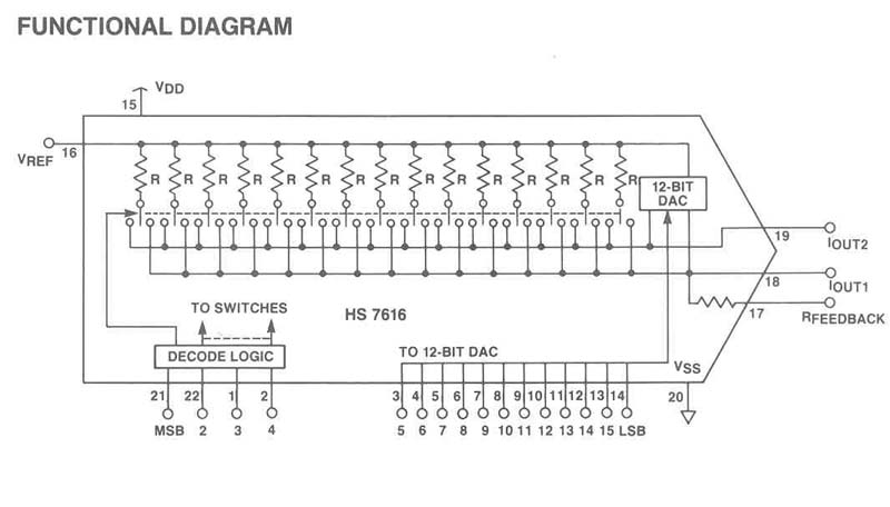

This is actually what dCs does in their Elgar series. The digital signal is oversampled a lot, noise-shaped, and fed to a 8 bits or so DAC which is (I think) implemented in discrete parts.

peufeu said:This is actually what dCs does in their Elgar series. The digital signal is oversampled a lot, noise-shaped, and fed to a 8 bits or so DAC which is (I think) implemented in discrete parts.
While the dCs ringDAC does oversample it is at a relatively low 64x and the dac is only around 5bits and the current sources all have the same weight unlike a normal multibit dac.

A normal multibit dac has a bit weight that scales with the position of the bit i.e. the weighting of the lsb of a 16 bit dac is 1/65536.
As the wordlength increases the values required for the current sources get increasing smaller and more difficult and expensive to fabricate.
The dCs ringdac has unitary weighted current sources ie. they all have the same value. The output current is formed by selecting the appropriate number of current sources and this is governed the control software.
And the used current sources are "rotated" hence the name "ring-dac". With 5 current sources, you can make any value from 0 to 5 (by activating 0 to 5 sources), but the value 1 does not always correspond to the same source because of the rotation. This helps balancing any inconsistencies between the sources.
Anyway, this still is around 2.5 bits (=log2 (6)) times 64x oversampling, and I find it hard to believe that it can reproduce the full information contained in 16 bits samples...

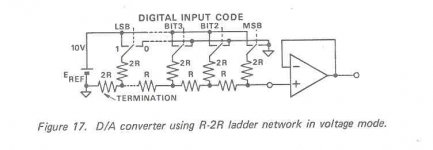

If your looking to build a accurate high speed DAC you can do this discretely using the R2R ladder approach. I have found the controlling charge injection and current source to limit the accuracy in the design of Delta Sigma DAC.
The problem with building a R2R DAC is scaling the R2R ladders and producing a voltage reference that is stable with very low noise and low impedance. However, with S102 Vishay resistors the ladder not a big deal it just becomes costly. So building a DAC in this method is normally out of the question for the Burr Brown and Analog Devices due to cost, hence cheap Delta Sigma converters. There use to be several companies that made Hybrids DAC but they seem to have bit the dust; Hybrid Systems, MicroNetworks and Analogic were some of these companies.
In addition, there use to be a number of resistor companies making R2R network on thin film substrate. Anyway, I have found during design and testing that the accuracy of these DAC's to be far superior to the Delta Sigma's since low level accuracy is compromised. So with a little effort multiple R2R DAC’s can be series together with a summing junction.
Could you post a simple schematic for a R2R dac ? I know I'm looking stupid, but I don't know whats that 🙂
I know it's a ladder with many times R and 2R, I saw stepped attenautors like this, but what is used for switching ? CMOS switches as usual ? (charge injection etc) or something else ?
