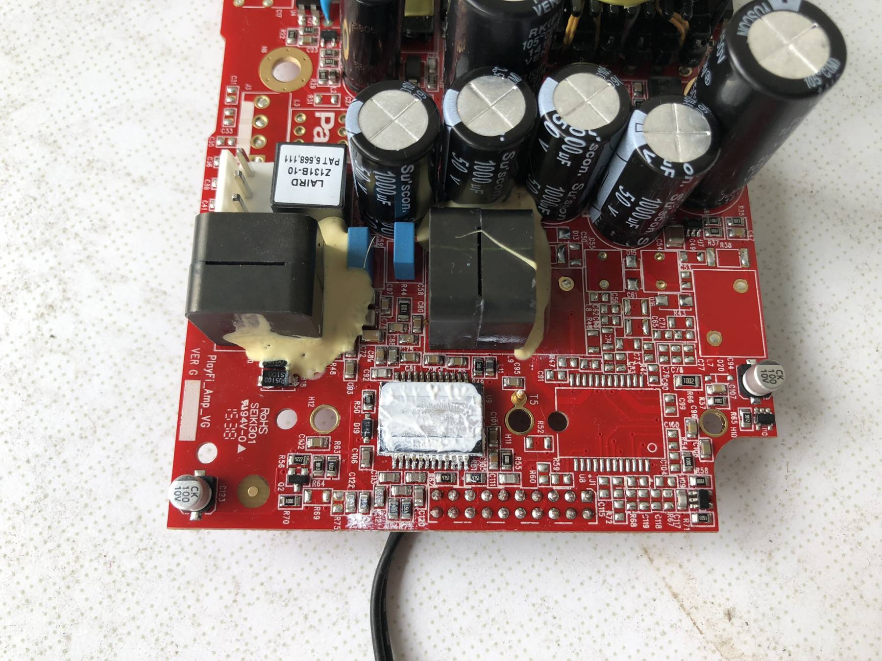

The Amp has two boards - An upper board which has the SMPS and a TDA8954J Amp

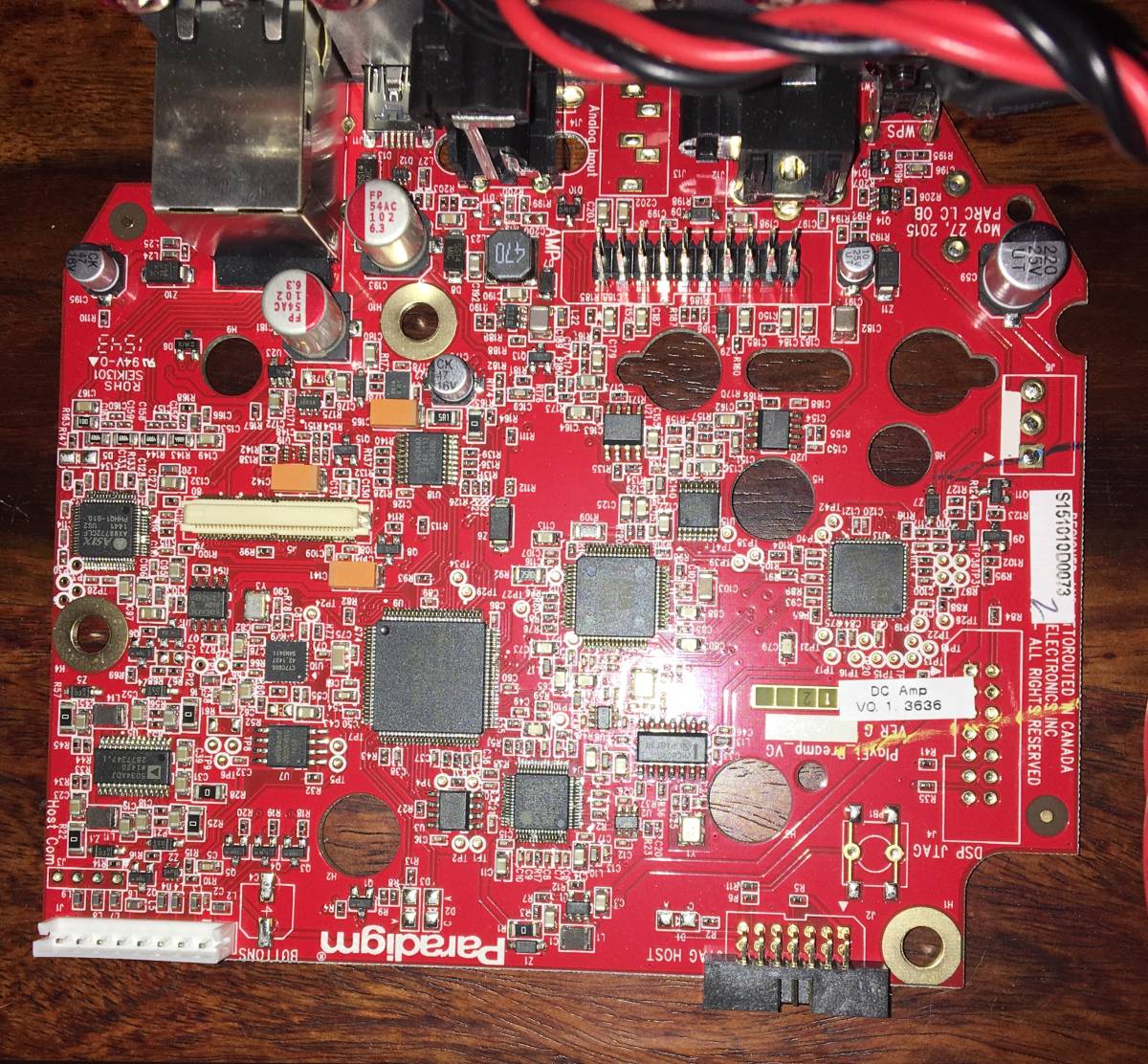

The lower board (Pre-amp : see attached) contains the bits which are more valuable to me (play-fi streaming, Anthem Room correction etc)
The boards are connected via a 20 pin connector (see attached)
I was able to power on the Preamp with an external power supply and it works fine.
I then identified the Pre-amp out connectors by tracking back the TDA8954J IN1P, IN2P, IN1M and IN2M pins to the connector (IN1P = input 1 positive)

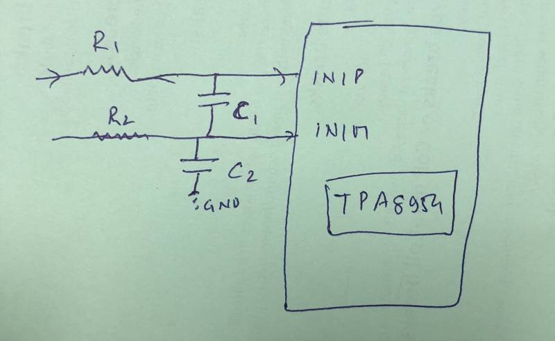

The only components on the track are 4.7K resistors in series and two unidentifiable capacitors. (See attached)

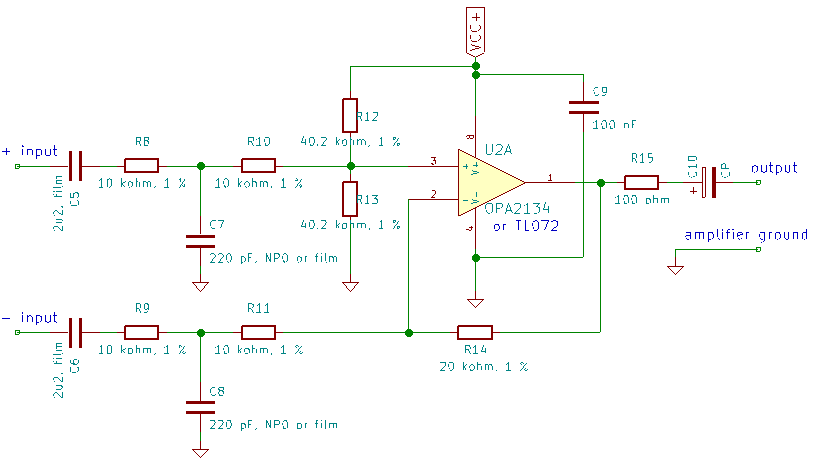

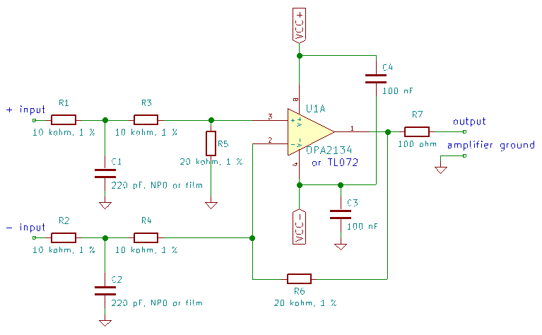

As an alternative, you could consider making a simple differential amplifier plus low-pass filter with an op-amp, six resistors and two capacitors per channel, and feed the output into the amplifier board you already have.

It could be some kind of quasi-differential connection, where the negative signal line is connected to the best available ground point via an impedance that mimics the impedance of the positive signal line. Then again, the schematic you posted in post number 1 is asymmetrical for some reason or other: C1 is between INIP and INIM and C2 goes from INIM to ground.
I posted post number 6 before reading post number 5.
The schematic (which is the schematic from the datasheet of the TAS5630).
It seems Paradigm may have deviated from that.
For now, I have grounded the INIM line via a 10K resistor (to mimic INIP) and the device seems to be working fine.
