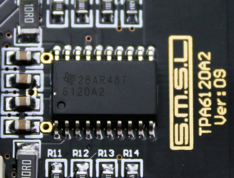

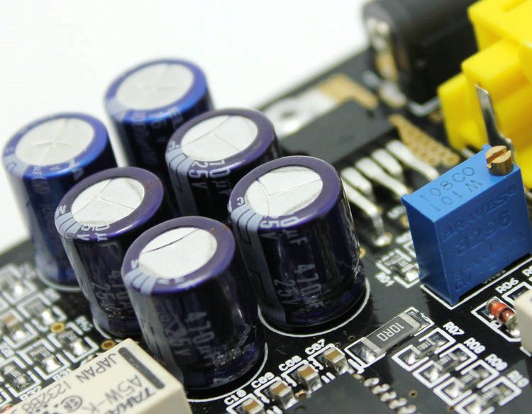

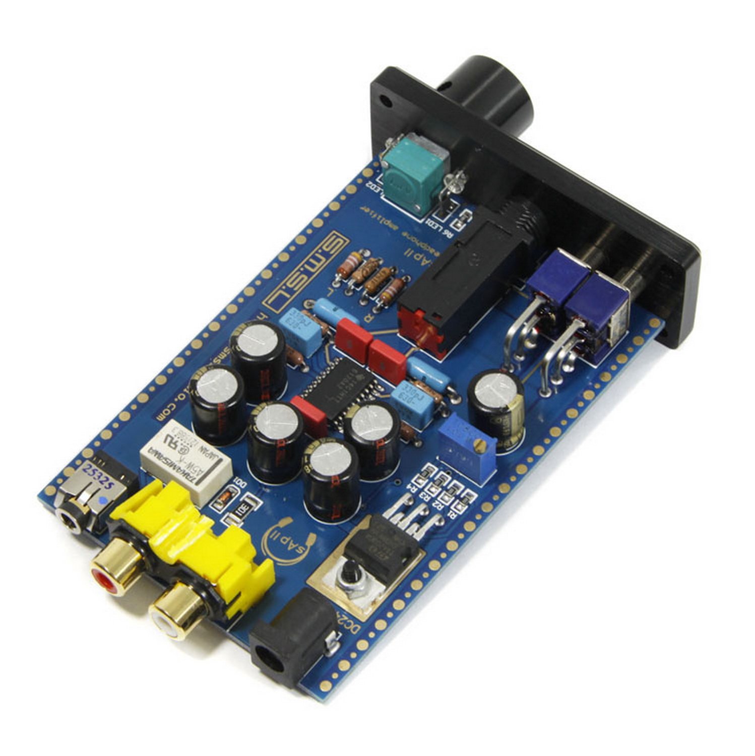

Do you have a close-up pic of your amp showing the OPA2604 and surrounding circuits? I looked on Taobao but the SMSL amps they're showing there don't look to be 'Pro' variants. Your pic doesn't seem to show any OPA2604 so I'm a tad confused.
No, if the power supply output voltage was 10V that only affects the maximum possible output level, not the gain of the amp (which is set by resistors, not by the power supply voltage).
I'd just realised myself that the photo I took from Amazon is wrong - they still seem to be using the old photos for the newer version. The newer version is called Pro and that's the one I have been given- apparently it has a black PCB I have read and I've posted another photo below from the internet - many apols!
I don't have a camera!
http://www.ebay.com/itm/SMSL-sApII-PRO-TPA6120A2-Big-Power-High-Fidelity-Stereo-Headphone-Amplifier-/110889315357
That's better - those pictures match the ones on Taobao.
Do you have a multimeter which could be used to check for continuity? Since the PCB's black there's no way to understand which resistors go to which pins of the OPA2604 without checking for continuity. The resistor we want to remove is one going from pin2 (pin6 on the other side) to the ground (0V) as then the gain will go down to unity - effectively the OPA2604 becomes a buffer with this resistor removed. My guess is its R18 so check that one first.
