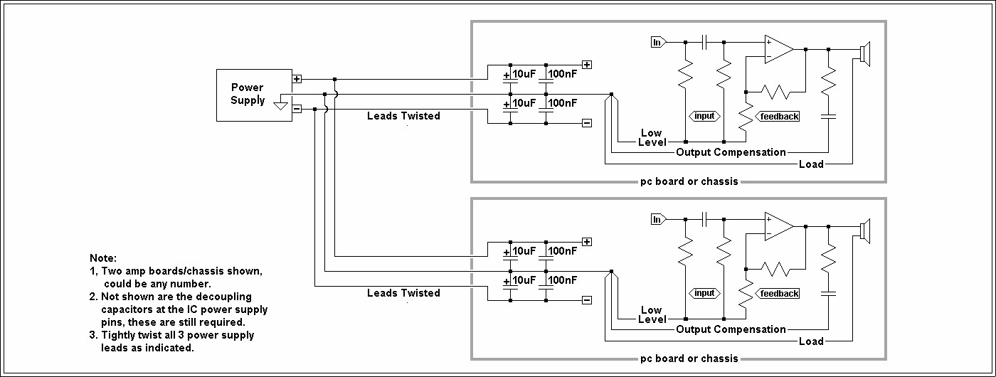

Hi everyone,
Newbie question here: I'm working on a small 2.1 console and would like to use 2 amplifiers -- one stereo amp for a pair of FR drivers (Hifimediy T2 Mundorf), and one mono for a subwoofer (Hifimediy T3 mono TK2050 amp, MCAP)...
I plan on using a Grayhill rotary input switch (Grayhill Selector Switch + PCB | Chipamp Electronics) and would like the amps to receive the same signal, use the same volume control and share a power supply.
Can anyone explain the simplest, most efficient way to accomplish this?

I was hoping to not use a DAC. Is not possible to split the signal by connecting both audio inputs to the same L&R RCA connector?
I was hoping to be able to take both supplied 2.54mm connectors and solder them to the rca jacks, similar to this:
but from both amps.
Also, can two amps be connected to the same volume pot and power switch?

Exactly right, a traditional 2.1. The 2.54mm connector goes to the amp board. My source will be a phone or MP3 at most times, and a turntable with a built in preamp also.
<< would like the amps to receive the same signal, use the same volume control and share a power supply. >>
Posted is a multi-feed power supply. The principle is that the capacitors decouple (electrically separate) the amp boards from the power supply, and from each other.
Although actually it's not unlikely you could just plug your multiple amps into the power supply and be done. If you get noise or distortion then use stronger methods as shown.
The second illustration is a signal splitter formed with two buffers. The outstanding features of a buffer are unity gain, very high input impedance (here in the megohm range), very low output impedance, and very low (3 decimals or better) distortion. Buffers give absolute separation between the input and output(s).
The 100R (100 ohm) resistors are a belt-and-suspenders arrangement that can help protect against overloading and/or oscillation under some conditions.
By the way, this same setup is used to drive a balanced line, except U1b is inverting.
<< use the same signal >>
Are you sure? You'd want to be able to control the volume of a subwoofer arrangement separately from the main volume control.
In any case, one way to do this would be to hang a volume control on the input side of the splitter.
Possible yes, first class no. The reason is that you don't know what the input circuits on the amps you're connecting might be, and they might interact to cause distortion.
Oh the other hand, it won't damage anything to just hook up a Y cable and see what happens.

Thanks so much for this. Very helpful.
I figured there may a distortion issue. Thanks again for the help.
