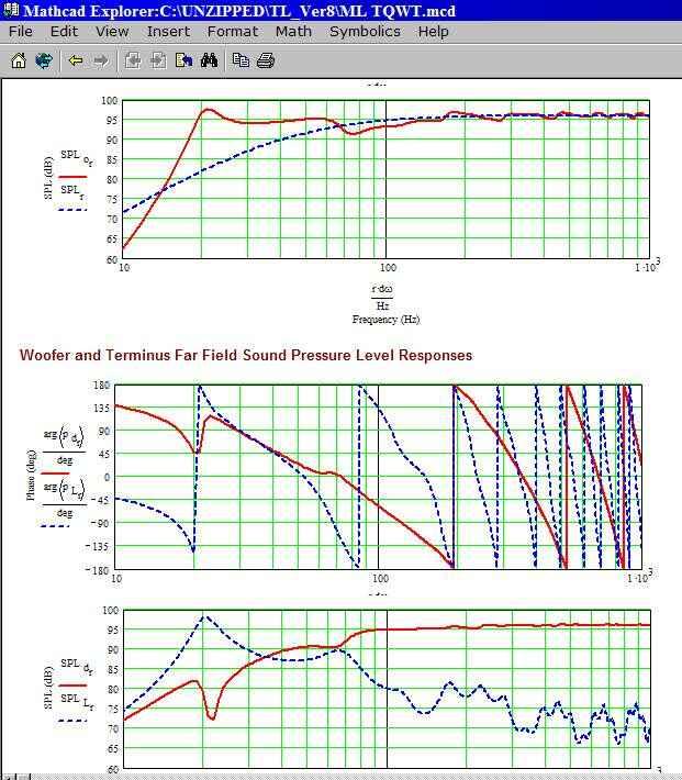

what do u think??
after reading about '' the acoustic wave cannon'' thread.. it made me bring up the mathcad files..
im using jbl2226h
1st question
The port diameter,does this need to be large like a ported box to prevent chuffing//
2nd question
Can i presume that 'area at large end of ML TQWT ' = the driver end?? because normaly he talks of Reducing area tlines..
also experimenting with Driver position ratio..
that image=
S0=1Sd
SL=7sd 880cm x7 = big hah

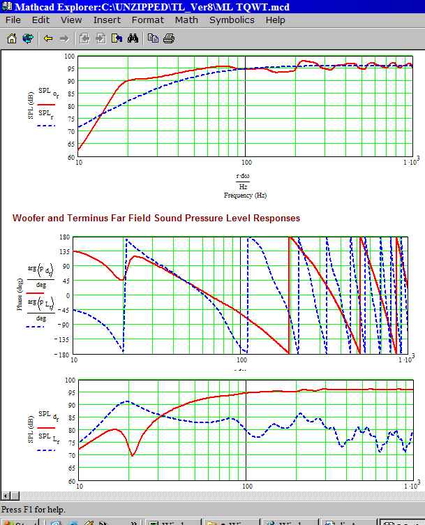

ah i fixed the peak,, i made SL=4x Sd so its flat unlike the image..

mikee12345 said:what do u think??
You say you've smoothed out the bottom a bit from the posted pics... can you post that simulation?
Looks like you can afford a bit more stuffing. this will reduce the rolloff and give you a little more roll-off in the bottom (which will help compensate for room gain)
dave
yep i reducd it to 3x Sd,makes the peak,flat otherwise the same.
also,3x Sd makes it more 'pipe ish' in my opinion,where as 7x Sd is basshorn size :-D
and i cant fit a basshorn,or only a 40hz one anyway-this is another possibility,but only if i could make a nautilus shell style one to cram it all into small space.
.is that all a tline is------a small volume/area pipe basshorn
i have LOTS of wool if i decide to build this :-D

1st question
Yes. As frequency decreases, more of the output is from the port. I like to use 0.5*Sd as a minimum port size.
2nd question
If you are using one of the ML TQWT worksheets, be careful. MatCAD doesn't care about "small end", "large end". So is the driver end, Sl is the port end, regardless of your taper.
that image=
S0=1Sd
ah i fixed the peak,, i made SL=4x Sd so its flat unlike the image....
You don't want flat to cut-off. It will boom like H...! Make a guess at what your room lift is going to be and reduce the output at the bottom end by the amount of room lift.

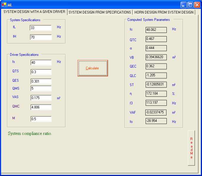

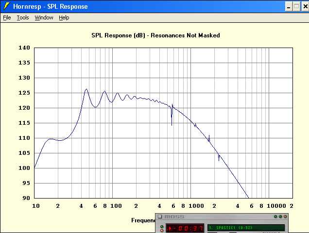

Hey Mikee, What specs did you use? There's no way a driver with a Qts = 0.31 and a ~3.27% eff. is going to have an IB slope response like shown on your graphs. It's going to be off the plot before it hits 200Hz.....
FWIW, this driver doesn't have specs suitable for a low tuned ML-TL or TL for that matter, except with some serious digital EQ, so a standard ol' golden ratio 6.2ft^3 net tuned to between 18-20Hz with a pair of 18" PRs will net you ~5-6dB/20Hz over the same size sealed. Considering the cost of the PRs, that's a fairly expensive extra few dB.
Really, since it has good basshorn specs, a bit larger BP with a large, long damped vent tube might be your best bet for simple Vs SPL.

i used Qes=0.301 and Qms=5.5 they are approximate values since i lost the pdf
yes i do expect it to reduce a few db,in winisd it prefers an enclosure tuned above resonance and small box,highly efficient.where as my 175litre 33hzFB usage is not so efficient .
http://homepages.paradise.net.nz/quadroph 'tline'
i actualy prefer the basshorn but it seems to unload badly.
mmm efficiency.
mmm efficiency.
OK, here's the averaged specs I have on the 2226H:
Fs = 40Hz
Vas = 175.58L
Qms = 5.0 (8ohms)
Qes = 0.33 (0.528)
Qts = 0.30956 (no need to input, the spreadsheet calculates it)
Le = 1.75mH
Pe = 600W
Re = 5ohms
Sd = 883cm^2
Xmax = 7.6mm
B*L = 19.441N/A
Cms = 1.5951e-04mm/N
Mms = 0.0993Kg
Plugging these into MLTQWT and Hornresp should give you a bit more accurate sim. Not as good as measuring yours, but should be in the ballpark.
Mass loaded pipe (MLTQWT, or ML-TL) designs was one of my stocks-in-trade so to speak, though they were usually called tower designs until MK's spreadsheets became popular, and quickly found that increasing the Re to 8ohms and using a straight pipe tuned to ~34Hz appeared to be about the best trade-off between BW/efficiency. It's a T/S max flat alignment (Vb = 10.36ft^3), so if too boomy in-room can be tuned lower to better blend with the room and/or lower system Q somewhat, though I don't recommend tuning below ~25Hz without heavy stuffing to damp the Fb peak 'ringing'.
I don't have a website to post stuff so to see the response, input the above driver values using those in parentheses, then pipe info:
L (in) 47.32
S0/SL mult. 2.7373 (this is the multiplier if Sd is the reference)
X0 (%) 0.5146 (this is how far down from the top the driver should be (L*X0), or a little below the midpoint in this case)
S0/SL (in^2) 374.63 (this is the cross sectional area of the pipe)
S0/SL (width) 24.62
S0/SL (depth) 15.21 (these two are based on the golden ratio, but somewhat flexible in a midbass/sub app)
X0 (in) 24.36
Vent radius (in) 4
Lv (in) = 4
stuffing density 0.25lb/ft^3
Answering your website Qs:
>I presume that the port must be sufficient in size to prevent chuffing from high air speeds.
Correct, these are no different than a standard reflex in this respect.
>What is the Tline doing then/? Just simply resonating like an organ,not impedence matching,because it is not 103db efficiency like the basshorn…
Correct.
>I wasn’t sure which M number to do,so I copied the labhorn and did M=0.5
M, or flare rate, is determined by the driver's specs, desired BW and efficiency. To effectively use any horn response program to sim high efficiency horns, you'll need to find a Marshal Leach horn analysis spreadsheet or on-line calculator (not sure if one exists yet). Or get his JAES papers and do your own excel spreadsheet.
>Notice how the horn loads well at Fc,but unloads like a ported box in the 55hz region but with ripples,and below Fc excursion dramatically goes up,this is the part I am not fond of,as the input power is only 100watt rms,and my Xmax=7.5mm.
Horn's are 1/4WL resonators and this one's too short, with too small a mouth, hence the 'sinewave' excursion plot.
>But also,why is it loaded at 40hz,but the response continues flat to almost 30hz,where excursion is high.
Because the excursion is high. In-room, if a corner or something doesn't load it down it will be excursion/distortion limited, with a very ragged response.
HTH,
GM

>theres the response with the ml util specs
That looks more like what I expected. That ML Util program, where did you get that?

http://melhuish.org > sound, software, ML UTIL
ive had it for ages but didnt realise its use lol
it doesnt give me a nice response ,, why is it so low in response? it reccomends a tiny throat! :-S
i realise you tell me the Qes number,is that to compare to the normal JBL Qes number/? to see the nice roll off

Ah, Michael Zhang's program. He lives near me, but I've never downloaded (or seen) his program since it requires another MS app to be able to run it.
No, and it won't, for the reasons I gave. Small throat means a very long horn/large mouth to get best performance from it. Load it with a autoformer to raise its Qes and it will calc a larger throat/higher 'M', ergo shorter horn/smaller mouth required.
Right, do two different sims, one with the specs and another with the revised to see the difference in performance, especially WRT transient response.

- using ML TQWT ,20hz jbl
