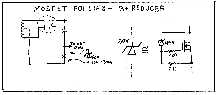

If you need to drop volts, here's a way to do that: MOSFET Follies It's at the bottom of the page. This should give much better regulation than a series dropping resistor.

Maybe mixing your advice with the MOSFET Follies proposed by Miles would lower the B+ to the voltage of the 5F1 (maybe the aa764) I just want a smaller amp that the Princeton Reverb I built. I don't understand "Just make sure that the series plate resistance in the rectifier input is equal to or greater than 135Ω " Do you mean to place a resistor before the rectifier tube?
