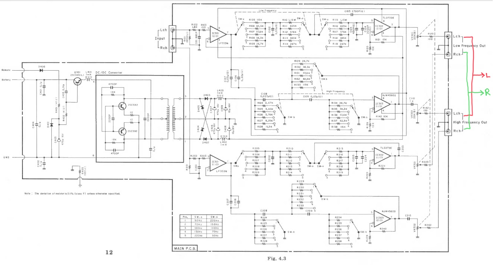

I’ve been experimenting connecting the outputs of Nakamichi EC-200 electronic crossover in different way by tying low and high frequencies outputs together via Y-cables. The objective is to use it as a bass boosting that is splitting low and high frequencies apart for allowing level adjustments independently and merging them again before sending it to a single amplifier, see attached. The unit was inserted at tape minitor loop of the preamplifier section of the integrated amplifier. Normally, the high frequency level will be left at fully clockwise (maximum position). And the low frequency level will be used alternately from min to max positions for adjusting bass level. After experimenting, I found an issue that the signal cancelled (output decreased) against each other when the low level knob was set at fully clockwise (max) and fully anti-clockwise (min). But it summed at around mid-rotation. I’d like to ask if there’s a potential to modify the unit to completely perform as desired description earlier.
The outputs of that unit should not be shorted together, that will overload the opamps inside it. Sum the outputs with some 1k resistors.
Crossovers may have 180 phase difference between low and high outputs.

I’ve tried connecting them as assumed earlier, low and high frequency outputs directly meet each other, and it worked. It wasn’t harm anything.
However, I noticed there were cancellations on level adjustments at almost min and max positions—the level knobs had to be set at approximately between 9 am and 15 pm.

I think it's best to set the high frequency level at the midpoint (12 o'clock), which will give the low frequencies a wider range of adjustment.Normally, the high frequency level will be left at fully clockwise (maximum position). And the low frequency level will be used alternately from min to max positions for adjusting bass level.
That is exactly what Mark is suggesting in post #2 with the 1K resistors. Personally I'd go a little higher but try it.I wonder if that problem could be fixed by using an audio summing device such as a multiplexer, a mixer, etc. My friend suggested me to use a “summing amplifier”.
