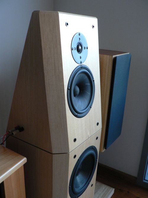

I wouldn't put much stock in this, just bi-amp for the reasons you intend. Bi-amping was kind of a solution looking for a problem and so was often overstated, even when it wasn't necessary.
By the way, the impedance you show isn't that bad. Some amplifiers will be fine with that.
I've bi-amped most of my 2.5 way speakers with separate power amps as well as using the bi-amp option in a HT receiver. I prefer an easier impedance there are amps that do not like low impedance. Amps like the A-S1000 and 840A tended to go into protection mode with a 3.6 min impedance where an old AKSA 55 had no issues. The other consideration is both woofers are different (like mine) so would behave differently unlike a standard 2.5 way using the same woofer.
That EMF statement doesn't apply to your situation as you are bi-amping a TM + W and not a T + M.
