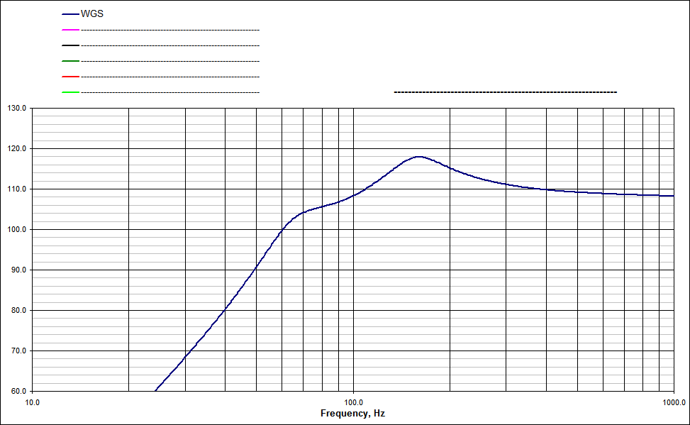

I'm using an existing bass reflex? box with 1.28 cu ft ID & a 5.6" dia hole cut the .5" thick front baffle. Using a WGS Veteran 10" (20W) I'm using this for electric guitar which is a full sounding combination. Wondering if someone could calculate the frequency response, etc. or maybe point me to a program that will. Thanks.
WGS Veteran 10" specifications:
Fs 97 hz
Re 6.7 Ohm
Le .30mH
Qms 15.18
Qes 1.51
Qts 1.38
Vas 1.29 cu ft
Cms .19 mm/N
BL 6.15 T-M
Mms 13.96 grams
Sd 36.61 cu cm
Spl 95 db
