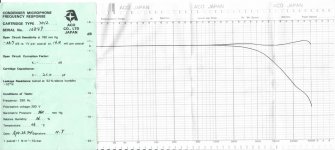

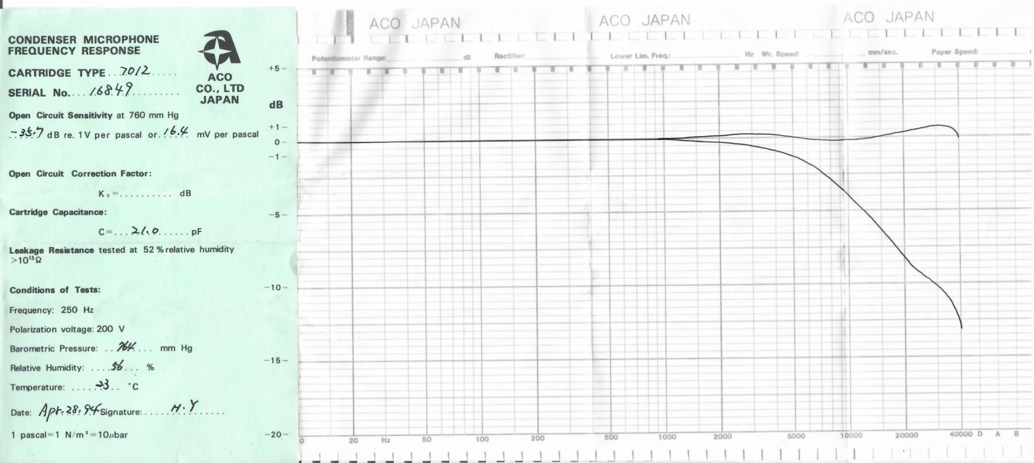

I have an Aco Pacific 70121/2" measurement microphone which I purchased with mellisa back in 1995 is basically flat from 3HZ to 40KHZ. I plan to use it with REW software. Rew needs a Mic. calibration data to be installed. The cal data consists of frequency, amplitude and phase angle. I only have the Mic frq. response graph, no phase response. I need to buy a usb audio interface.
Question 1. How do I get this data into REW?
Question 2. The software called Vituixcad has a spl trace tool that can convert the frq. response graph into a .txt file. Windows 10 or google chrome won't let me install it. For security reasons.
Question 3. How do I convert Mic. sensitivity from dB rel. 1V/Pa into db spl? 7012 sensitivity is -36 dB.
Have not used the 7012 in 2 decades. Not willing to have it cal'd for $135. and not willing to buy a Chinese usb mic.

Lucky man! I had a 1" ACO mic for years, and the FR was virtually ruler flat to 15kHz or so. So I never bother with any calibration. REW does not require it, iirc. Yours is similar, barely a 1/2 dB rise at 2kHz, and the slight deviation at the top is in a range that's mostly inaudible anyway -- not worth sweating about imo. I presume you have the 200VDC phantom PSU they usually require? With that, it is so quiet (under 20 dBA self noise) that your ambient room noise will always be higher. My 1" version had 5~7 dBA self noise. Its noise was lower than anything else through the entire recording/measuring chain.

Question: The 30 years old FR graph is still valid? or is like keeping a leftover in the refrigerator and when later you open the container you discover it has green fuzz on it!

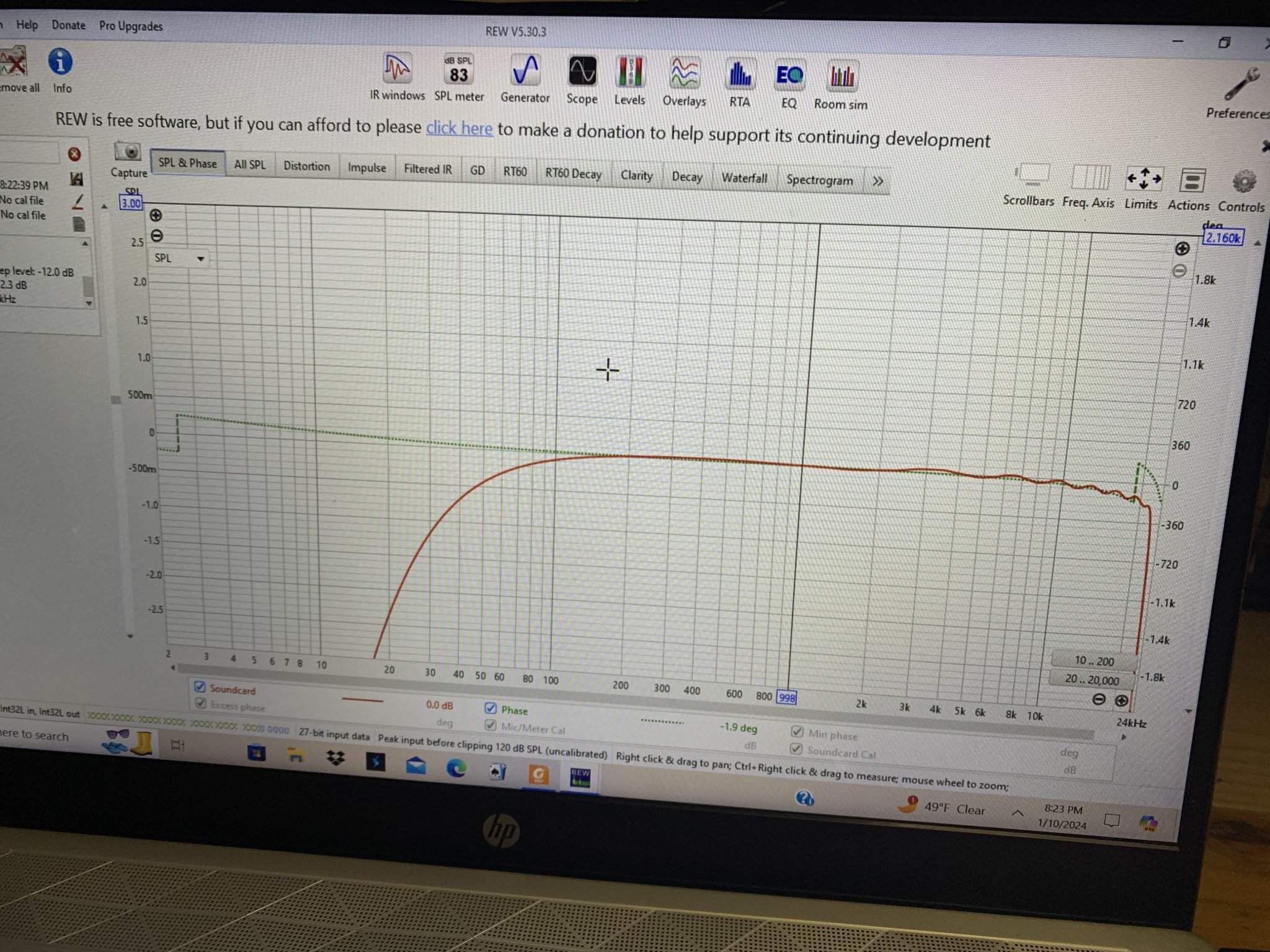

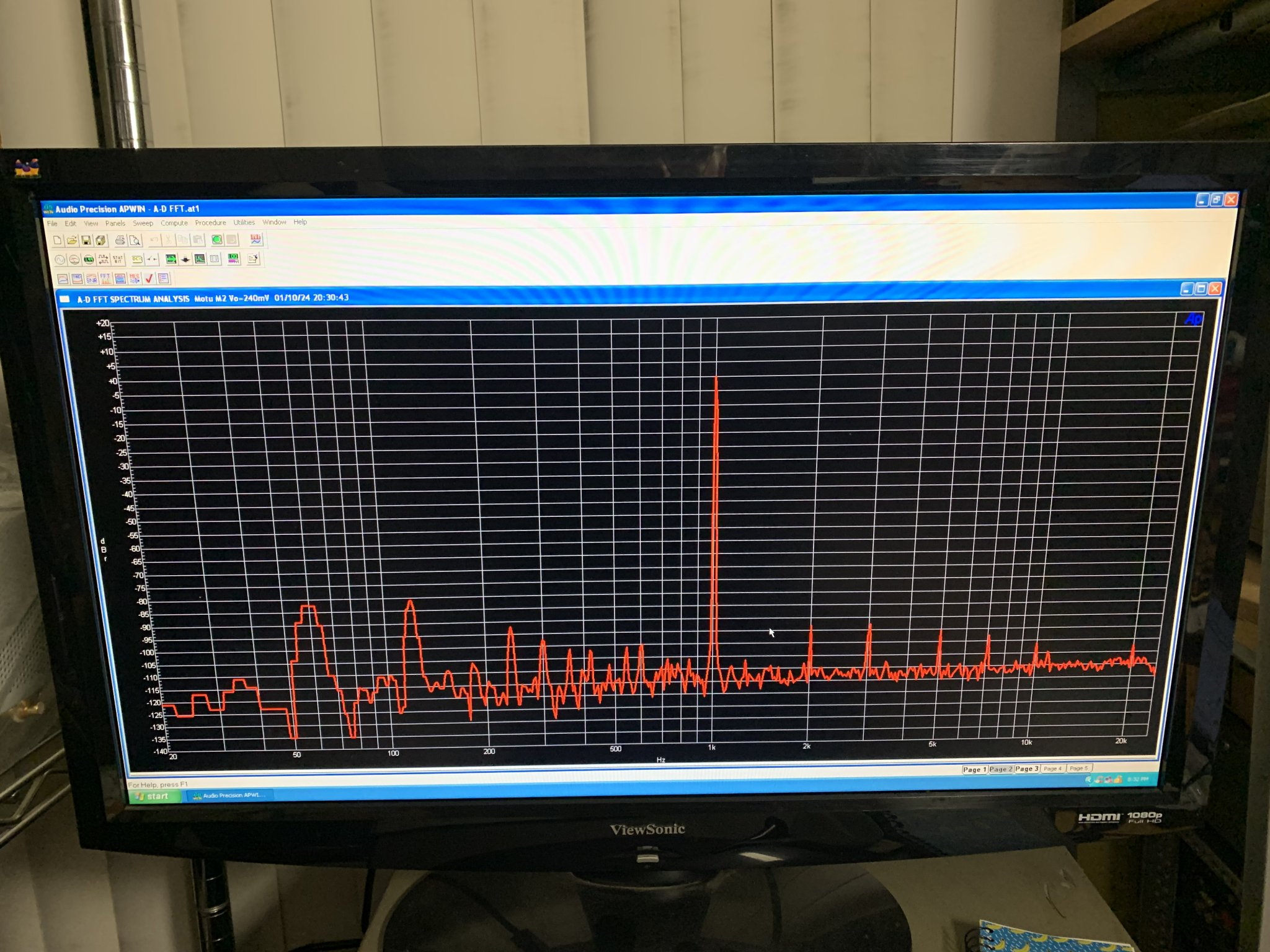

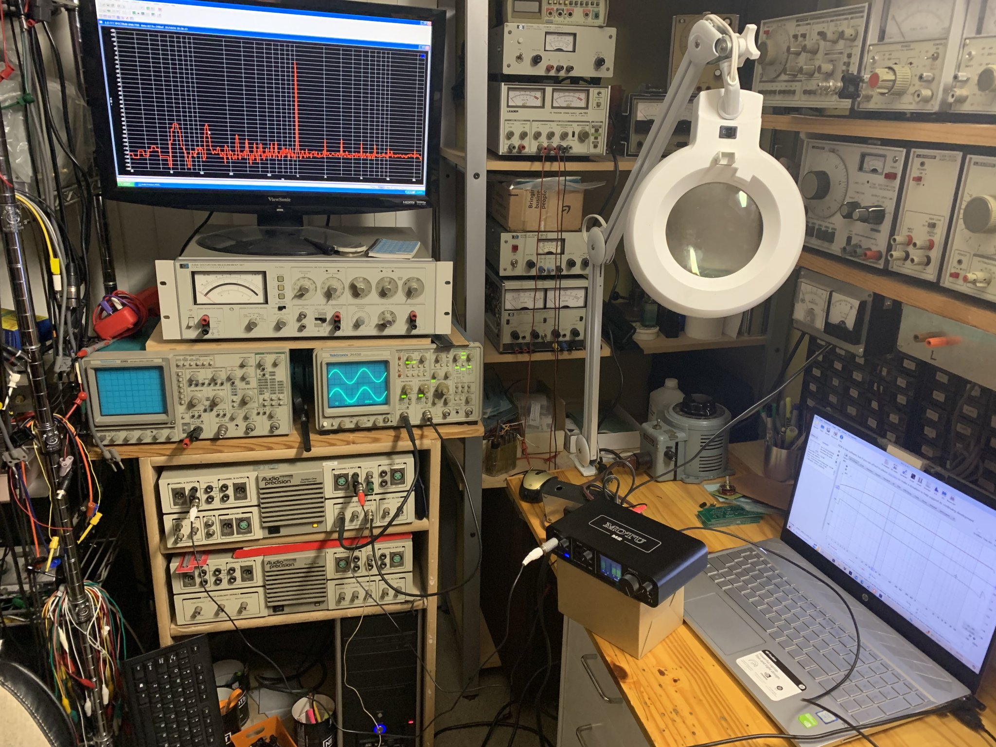

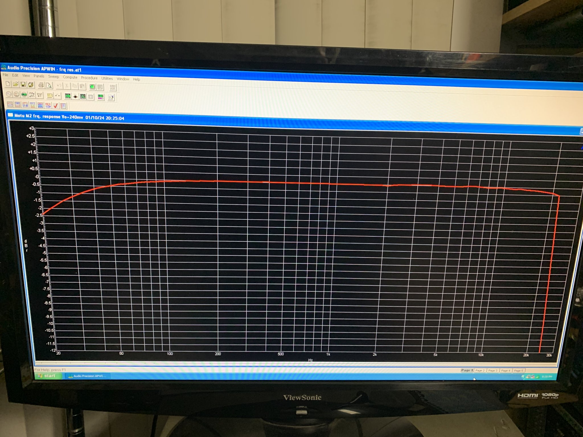

Replaced the non working Scarlett 2i2 with Motu M2 that just arrived. This one works!
Attached are the Frq. response, in both REW and AP, and AP FFT spectrum graphs.
The High level of line frequency 60, 120HZ and its harmonics perhaps coming from my HP laptop power supply.
It appears that I am in business now.

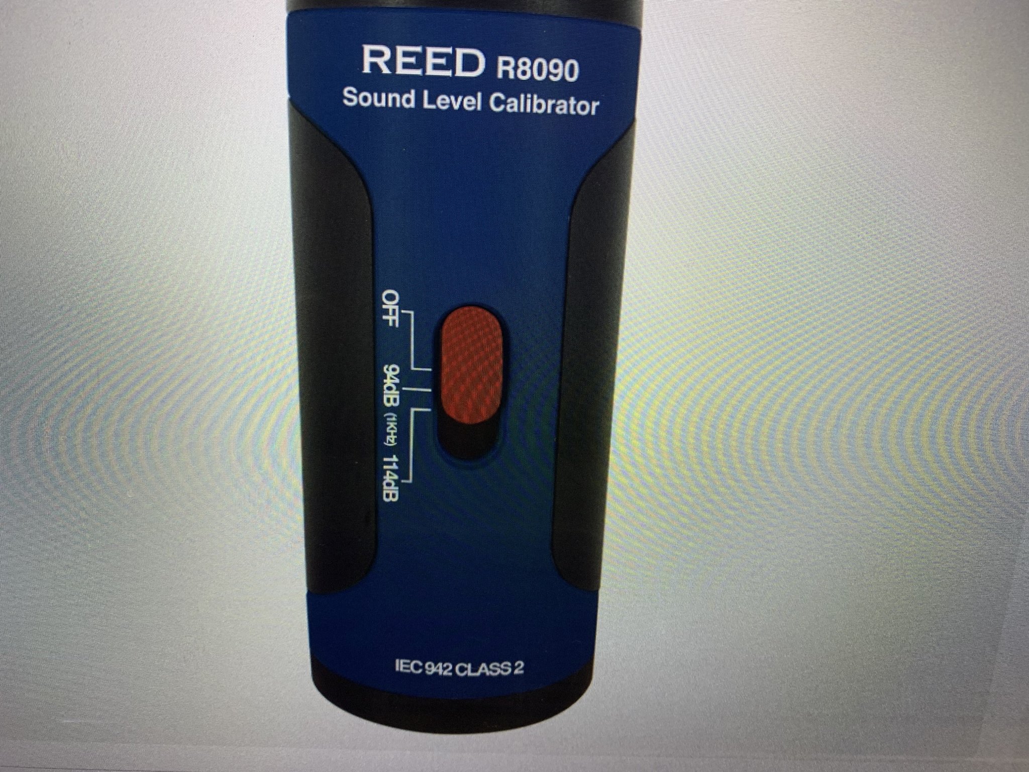

Do you have a microphone SPL calibrator? Sometimes you can get one within reason and it serves nicely as a sanity check for the mic and the rest of the signal chain.
R u talking about 1/2" mic calibrator (94db spl) called piston something (photo attached) or sound level meter?
No I don't have have neither.
Yes, a handy little sanity check if you can afford it. I got a cheap one off the 'bay and even though not exact (out of cal), it lets me know what's coming through and reading out is reasonable.
Mic calibrator: These have been around for ~20 years. They are very accurate. I compared them to Bruel-Kjaer & 2 other reference mic calibrators at the U of BC physics labs & my 2 samples of this "ND9" were within 1/2 dB. https://www.ebay.com/itm/232805516957 Price has gone up but not by much.
My mic sensitivity is -36 dB rel to 1v/PA, meaning if I couple the mic to the calibrator (94 dB spl) the ac voltage at the output of the mic preamp ( a source follower) is 36 dB below 1vrms which is approximately 16mv. Then mic is connected to the mic input of audio interface with some gain then goes into rew. Since the mic sensitivity is known to rew ( u need to enter this I think) and the gain of the internal audio interface mic pre amp is the signal input to rew, and the distance from mic to the speaker (1m) is given (known). Rew is supposed to calculate the spl on its own. Am I correct or talking crap?
