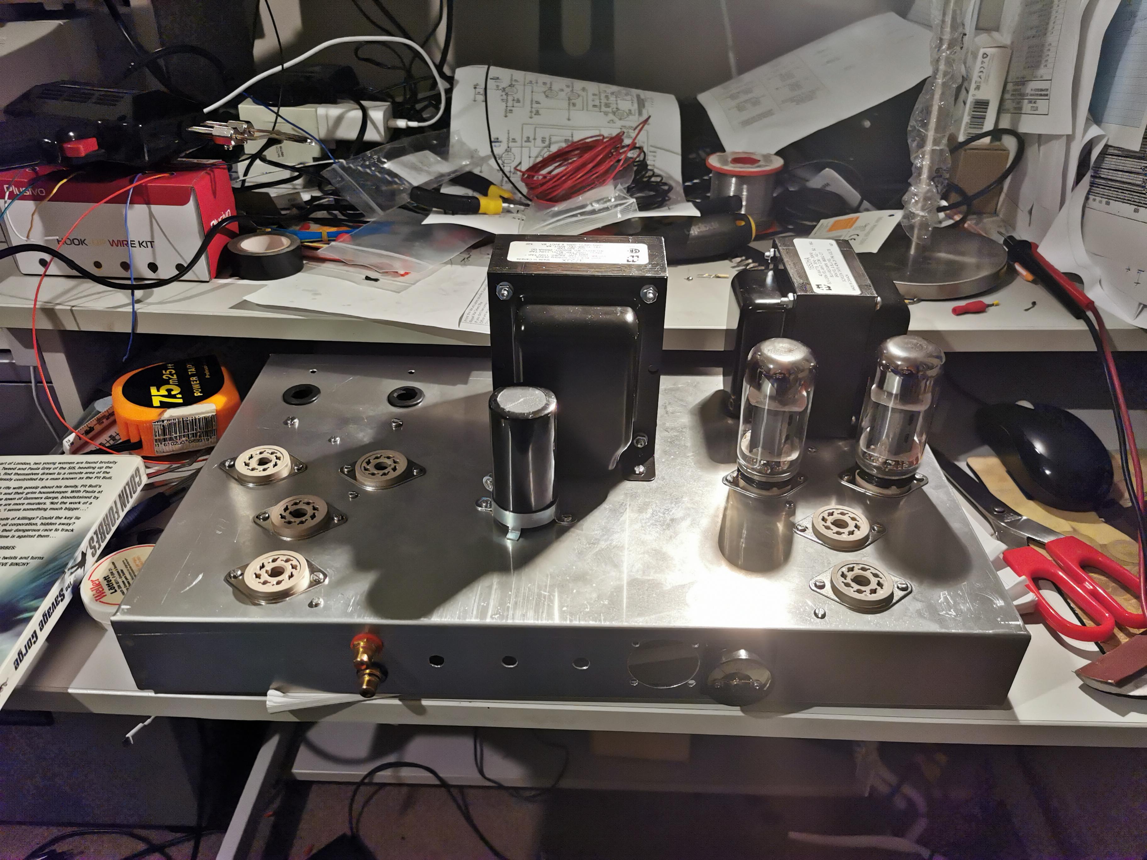

I'm just dealing with a similar situation, having fractured my humerus at the end of August, and I can confirm that at the moment, handling a typical valve amp requires planning. But, as already mentioned above, the chassis itself is the least of the worries. The transformers are.
I even delayed fitting the second OPT to my build to make it easier to handle while tuning things on one channel.
