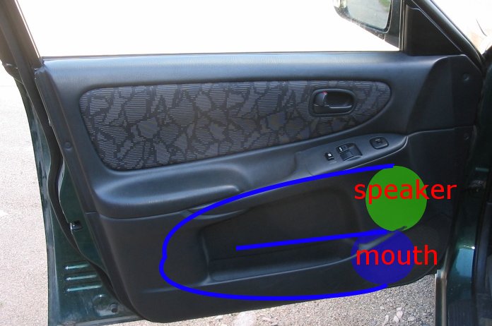

Using a t-line speaker on a car door?
how does the small listening room size affect the sound of a t-line on a car door?
is the idea to use a 4" speaker in a t-line in the car very bad?
It would sound awesome and it isn't a bad idea. As long as the tuning of the TL doesn't go below the longest mode frequency of the car (The longest dimension). I have played extensively with TL's in the automotive environment and the only problem with the TL is finding the space for such an enclosure.
Is that a Nissan Sentra?
Absolutely. All of the work that it takes to figure how the TLs will fit is definitely paid off with the nicer sound of the TL. You'll get even more loading from the TL because of the environment inside the cabin. Since you'll be using this for mid-bass drivers, you'll want to tune the TL near the xo point for the woofer (if you have one).
All enclosures have their pros and cons, but I think if someone is able to use a TL, that it will provide superior results.
In my installs, I typically end up using sealed/ported enclosures because of size constraints. Damn them size constraints!
