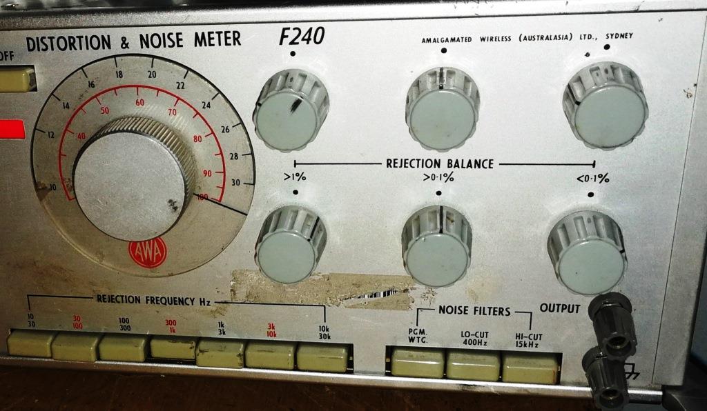

One advantage of this type of poor-man's oscillator is that test frequencies are not limited to a particular instrument (such as the 1kHz models that are typically being used), although the choice of a particular test frequency does imply that a notch filter is available at that frequency. As such, I am about to pull out a circa 1970's boat anchor AWA F240 Distortion and Noise meter, as it includes a very nice twin-T notch filter tuneable from 10Hz to 30kHz.

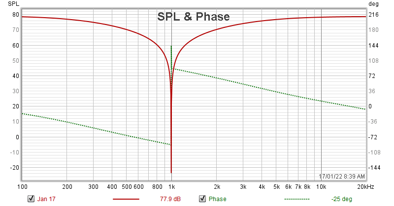

The AWA F240 Distortion and Noise meter allows a custom internal connection direct to the passive twin-T circuit without any circuit alterations. Inserting the notch filter in a simple loopback of an EMU 0404 soundcard, a passive notch to below -110dB can be achieved by first selecting the frequency range (pushbuttons) and adjusting the main dial knob for a minimum (using REW RTA), then the 6 Rejection Balance pots are used in pairs to progressively lower the null level. The first pair of balance knobs marked '>1%' are RV2 and RV5 in the schematic below, and the pairs RV3/RV6 and then RV4/RV7 allow deeper nulling.

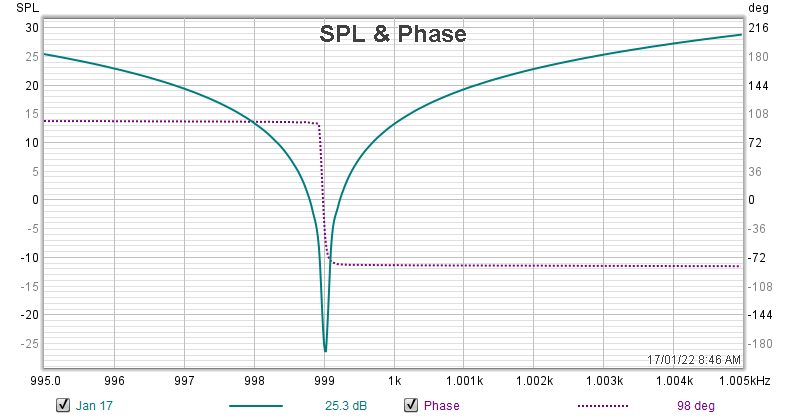

Using RTA with coherent averaging and an FFT of 64k means a commanded 1kHz tone actually generates a sinewave at 999.02Hz, and a spectrum sweep measurement shows that to be the case. The nice aspect of this twin-T tuning configuration is that although there is some slow but measurable drift up in null depth (which can be tweaked back to the same level as the EMU0404 default 2H and 3H harmonics), the exact frequency of the null does not noticeably vary. In contrast, another passive 1kHz notch filter using just fixed (but matched) capacitors and resistors and a trimpot for +/-1Hz fine tuning of the notch frequency only achieved a notch null of circa -85dB, however some slow drift of the notch frequency was noticeable (which is perhaps more problematic).
At 1kHz, this type of notch filter also attenuates the 2H signal by about -9dB and 3H by about -5dB, which needs to be accounted for when assessing actual distortion levels of any DUT added to a measurement loop. The filter is also quite practical out to measuring a 10kHz fundamental as the bandwidth is only down by about -2dB at 80kHz.

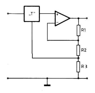

The exact value of the influence on H2, H3 depends on the impendance on both ends of the filter, and is not easy to calculate. To avoid this, I use an active double T filter, with a Q factor of 2.75 and an amplification of 1000x, this way the effect on H2 and above is negligible.

the distortion of the built in amp is not significant, even with 1000x amplification: assume a signal of H0 0dB, H2 -120 dB. H0 is attenuted by 80…85 dB and then amplified by 80 dB, so it ends up at ~0…-5 dB. H2 component is amplified by 80 dB and ends up at -40 dB. To prevent the amp generate H2 to interfere with amplified signal H2 a distortion lower than -35 dB is required. That is not too challenging. I have a OPA 228 in it. The limit is likely noise, not distortion.
That is the topology. This way the filter uses only one amp. R3 must be small, (R1+R2+R3)/(R2+R3) is the amplification, R2/(R2+R3) determines the Q.
You have active feedback to the notch filter (to sharpen the attenuation). Its very similar to the Shibasoku circuit. I discovered that the feedback path to the "T" is quite sensitive. A low impedance drive at very low distortion is required or it will compromise the system. That upgrade produced a significant improvement in the residuals (from below -130 db to more like -150 dB).
If you mean sensitive to pick up hum and noise, i agree. It was necessary to put the whole circuit in a sheet metal housing. If you mean sensitive to the notch depth: in my case the impedance feeding the T-foot is 9 ohm. That seems to be enough to have a >80 dB notch.

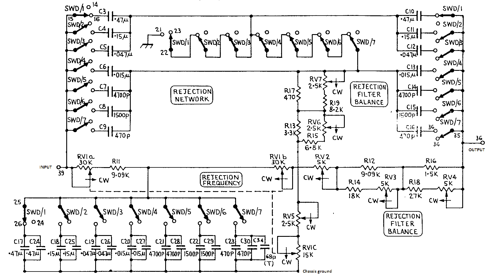

I've had time to try a mod on my vintage F240. The twin-T filter has a ground node that is easily changed to an isolated node, which then allows an op-amp based active notch to be implemented, such as in post #7, or using two opamps and unity-gain driving the bottom of the filter as I did. I just tried it with a TL072 and a Q of about 1.2 and trimmed the notch to about -100 to -110dB. That gives me some confidence to try some OPA134 low distortion opamps, for use as a low impedance drive buffer to the notch filter, and for the active notch rejection amp.
AWA did a pretty good job selecting the capacitors in the twin-T network, as most 'C' pairs were well within 1%, although the '2C' were typically a percent or two out (but I'm uncertain if my meter was somewhat an issue). Matching of the C's and R's is critical for better rejection, so I will have a go at padding out the slight capacitance imbalances on all the frequency ranges. The R's are all manually trimmed, so that then leaves the tempco to manage for notch depth stability, which I will try and gauge (with some simple thermal isolation of the instrument). The F240 has 100ppm/C spec resistors, and the tuning pot is 5W WW, so they had tried. The advantage of such vintage test gear is that internals are very well sectioned and shielded, and uses battery power.
