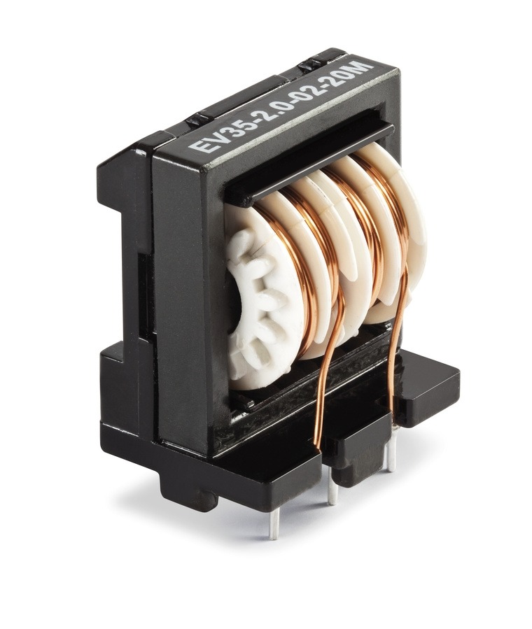

Thanks for replying. Since, the interfering signals are not between the power supply terminals, a "differential" inductance with two coils seems to be the solution. The question is: what value of inductance should I use? I have some ferrite cores which I can use, but the constant of inductance, that is, the inductance with one turn, is very low.
Typical values of commercial CMC's are generally comprised between 2 x 1.5mH and 2 X 47mH, and the value is correlated to the frequencies targeted.
Ideally, you would want a very large value to cover the widest possible frequency range, but in practice large inductors have a large parasitic capacitance, degrading their HF/VHF performance.
A workaround is to use a multisegmented coil former, like this one:
But there is always a limit, and to properly cover the whole spectrum you need to cascade a number of graduated coils: for example just a simple ferrite tube to begin with, followed by a 2 x 22µH, a 2 X 220µH, 2 X 2.2mH, 2 X 22mH.
It is desirable to add some form of damping too, as uncontrolled resonances can have weird effects, like differential to common mode conversion
