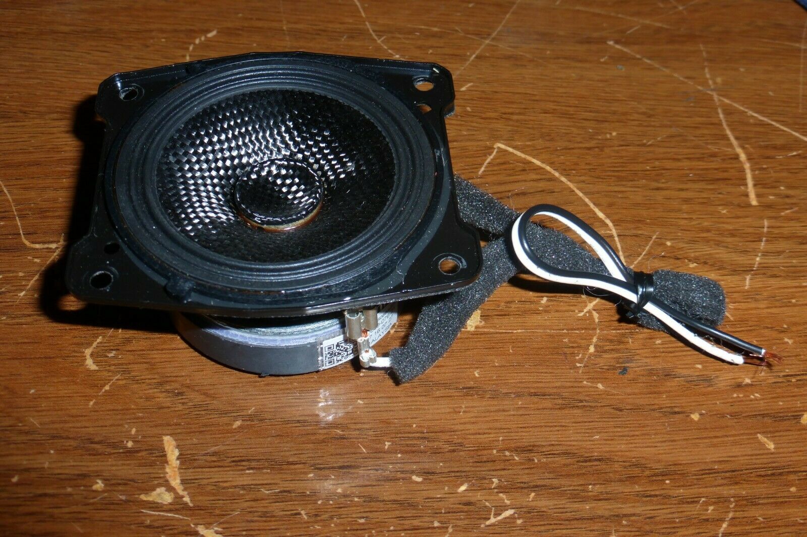

Trying to save space here. I'm deciding what kind of enclosure to use for some Sony 1-859-076-21 magnetic fluid speakers. I cannot find any specs for this driver, so I used specs from a similar sized one to calculate a sealed enclosure volume and resonant frequency. Vas = 0.02 ft^3, Fs = 113 Hz, Qts = 0.44
Qtc Vb (L) F3 Fb
0.707 0.36 182 182
0.6 0.66 186 154
0.5 1.94 200 128

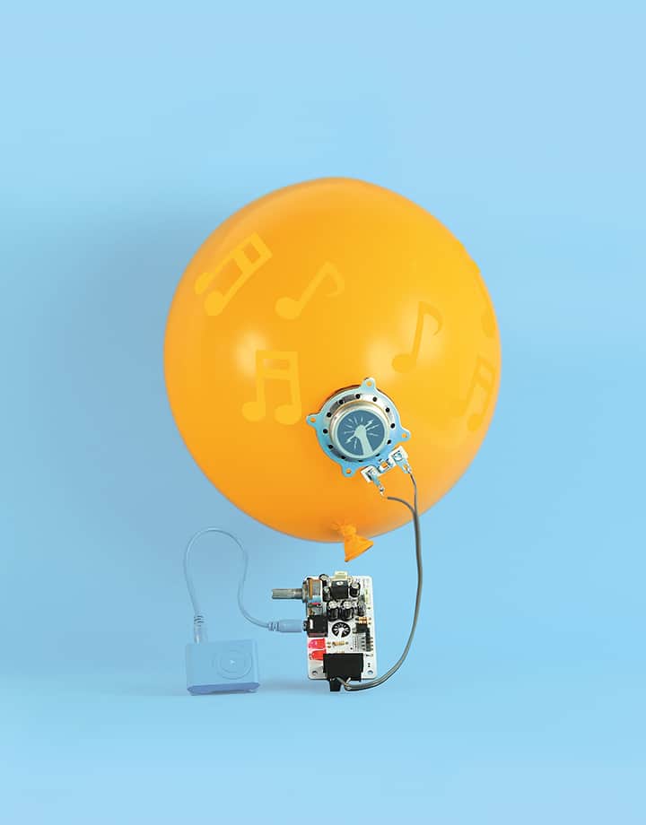

Those sizes are a little big for my taste. I was thinking what if you use a plastic bag or balloon instead. They would only be 1/2 filled, and ideally, the slightest pressure will change their shape, creating no resistance on the speaker. It seems this could be hard to pull off since such a thin bag will transmit sound. And if you make it thicker, it will put as much resistance on the speaker as a rigid enclosure?

Your method of calculating appropriate size will only be right with very small probability. Sealed, once big enuff is pretty tolerant of size thou.
Are you suggestting substituting a balloon for a box? It won’t work.

Yes, I'm asking if a balloon can approximate an infinite sealed enclosure, but at a much smaller size. Can you elaborate why it won't work?

Putting a driver in a plastic bag is not much different than just using it naked. It does nothing as far as being a box goes.

I'm not an expert in speaker design, but from what I do understand, you're trying to set up a tuned suspension system using the driver and the compliance of the air within the sealed box. The problem with your balloon box is not that the sound escapes, it's that the walls of the "box" stretch. That changes the suspension. If you've ever driven a car with bad shocks, you're familiar with how "well" that works. I doubt it would work any differently in the acoustic domain.

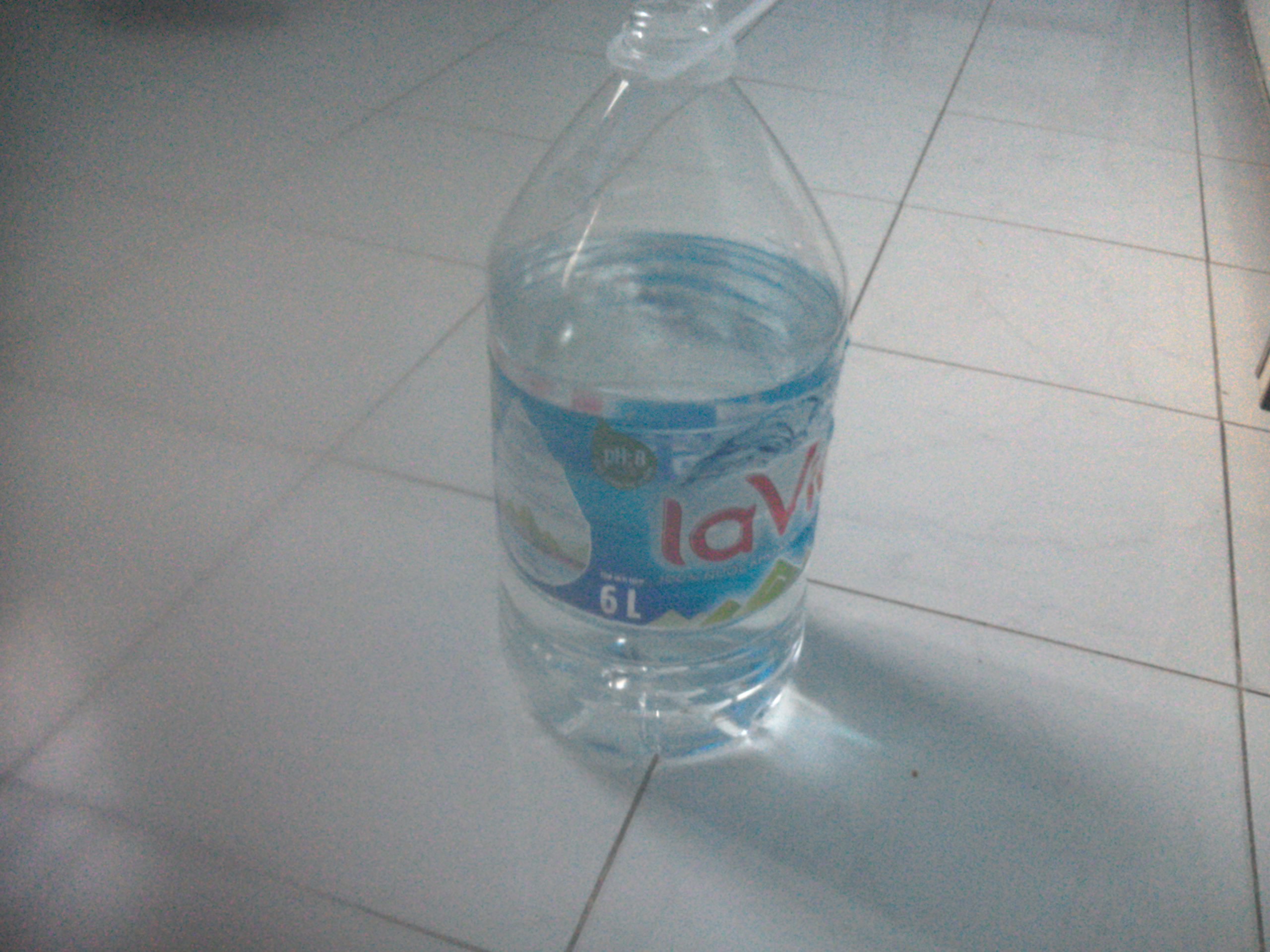

How about plastic jar as shown bellow. The speaker mounted on a wooden crown screwed upon the plastic jar, the cylindrical plastic acts as passive radiator. By painting layers of liquid rubber , used to waterproof decks of building, the resonant frequency can be adjusted. for damping, use a 5cm wide band of linen canvas or denim "jeans" clothe cut in diagonal fibers, impregnated by liquid rubber and glued around the jar.

FWIW, use to [tightly] wrap the driver frame with duct tape or similar to make it a sealed back for sealed mids, wide range tweeters, compression horn drivers, punching sufficiently small holes in it as required to ~aperiodically tune it if needing to lower its Q, Fb, so might want to try it since it's easy/cheap/reversible.
