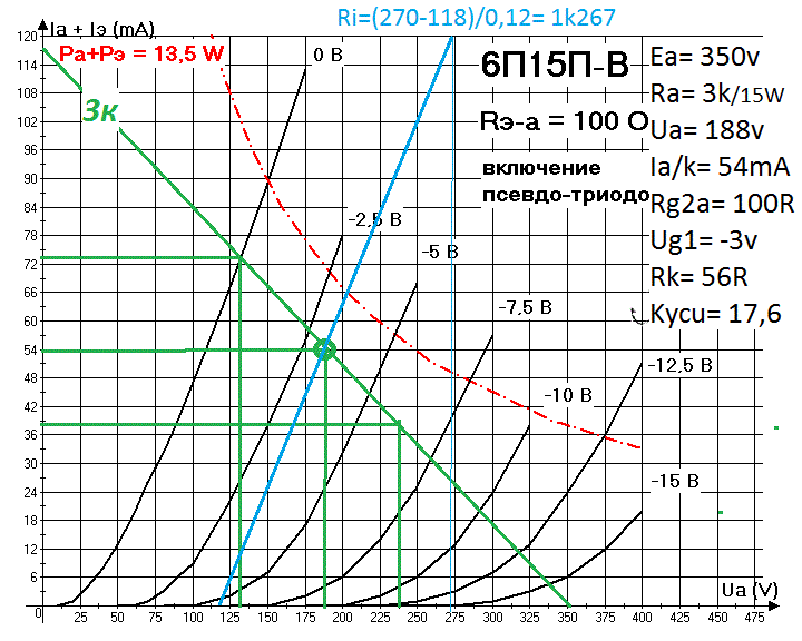

There's some confusion about the G2 rating of this 6P15P. Some data indicates 330V for both anode and G2, while other comments suggests the G2 is "fragile" and should be de-rated, maybe down to 160V like the EL83.
So for those wanting to use this in triode e.g. in a PSE amp, how to proceed? A hefty resistor on G2 or what?

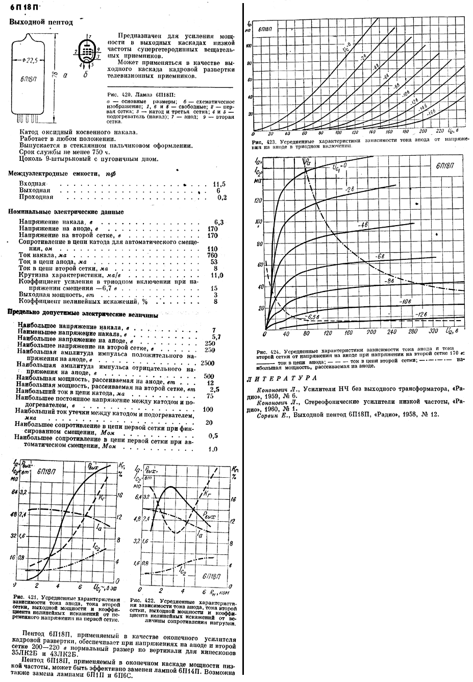

There's a thread on the 6P18P which contains some information but nothing conclusive. Francois G was going to test it but no further info. Maybe he can update?
https://www.diyaudio.com/community/threads/russian-6pi18pi-6-18-any-use.391138/#post-7146682

Based on the Russian datasheet that states limiting values 330V for both anode and g2, I would say you are fine. Taking into account that those are limiting values it would be better to go no further than 300V
Ale Moglia has 6P15P triode-strapped curves:
https://www.bartola.co.uk/valves/2015/05/10/6p15p-triode-strapped-models/

Typically, in triode connection, g2 can take more volts than its maximum pentode rating. For example, 300 and 400 V for 807; 250 and 400 V for 6146.

I run them with 320V as triodes using 220R for screen to plate. No issues in years.

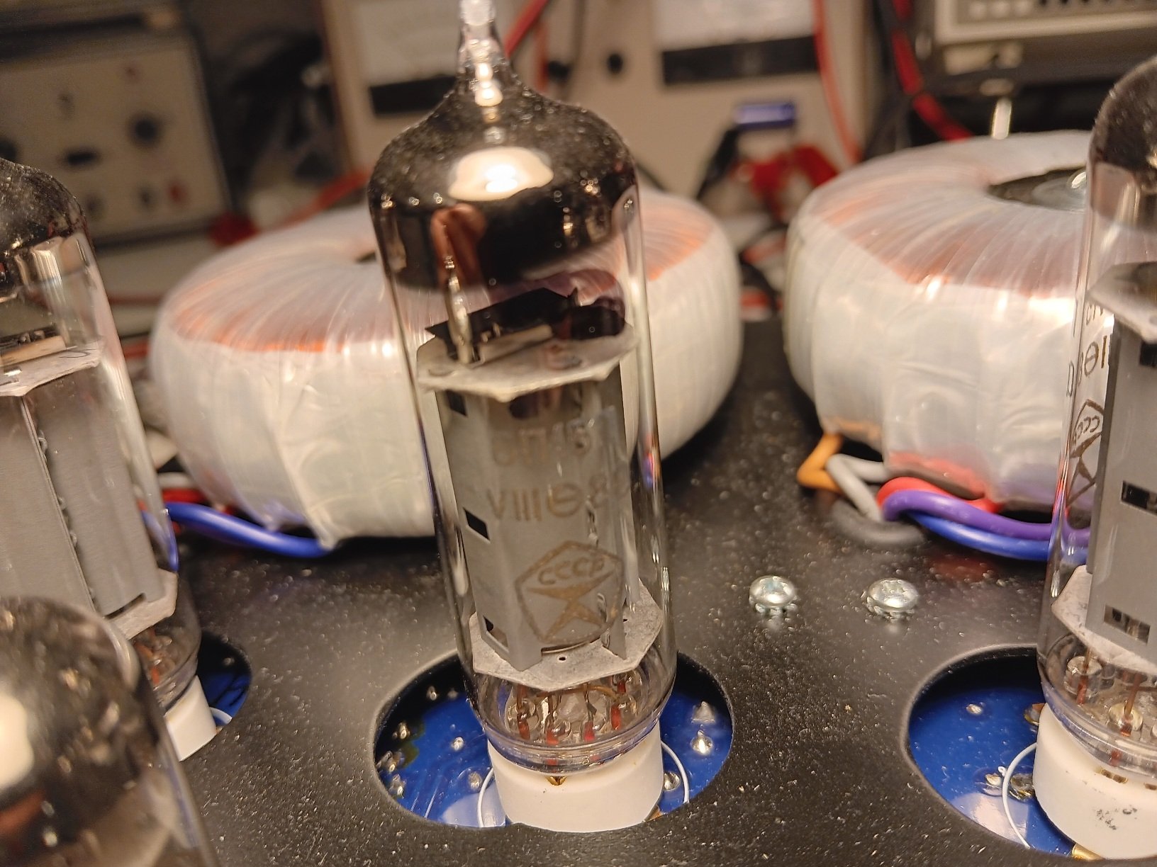

6P15P is not an EL83. We have the original Russian datasheets, I don't know why we keep mentioning the EL83.
But the OP question is about the 6P15P, not SV83. We do have the data for the 6P15P, therefore I do not really understand why is **83 relevant at all.

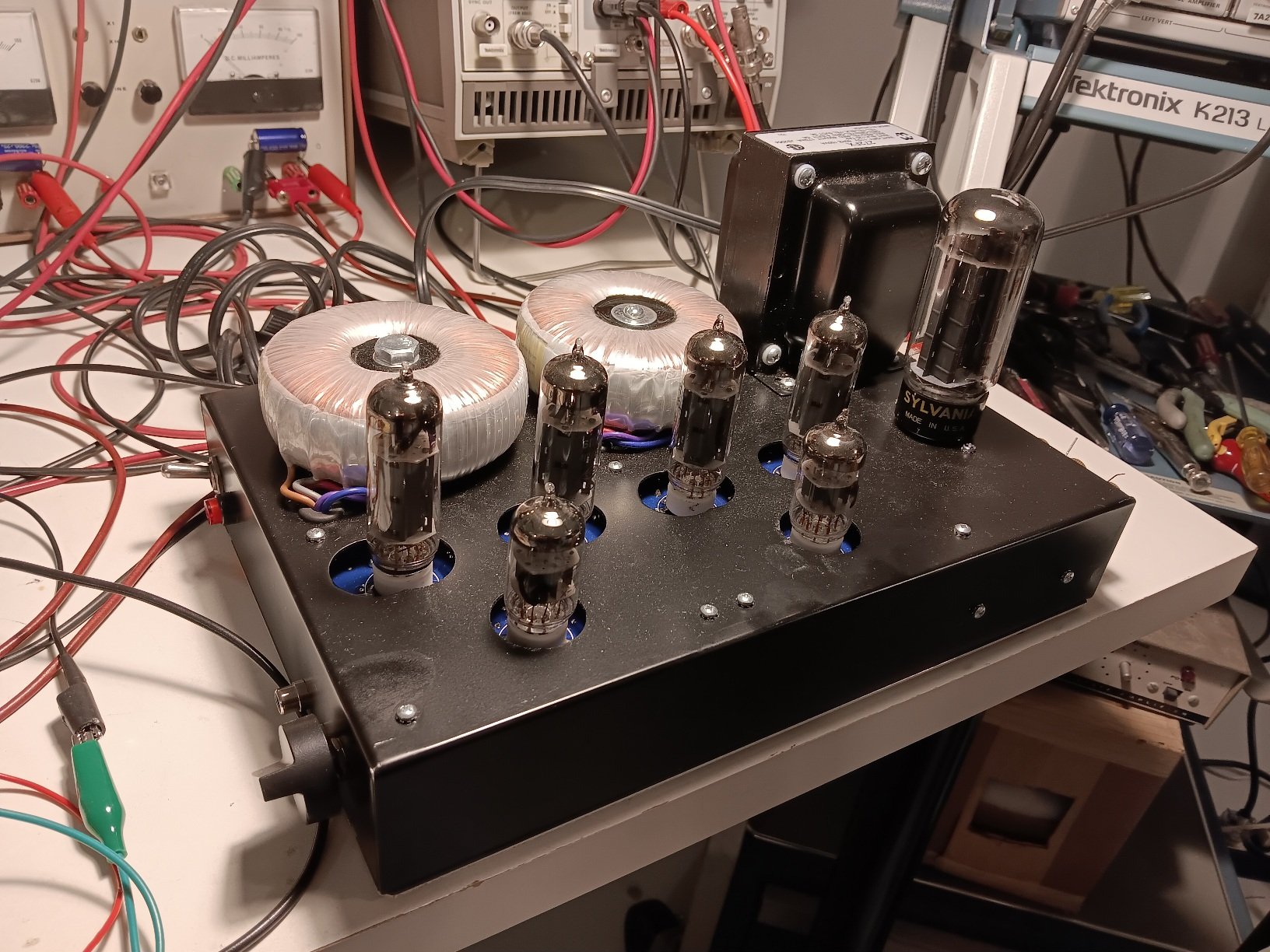

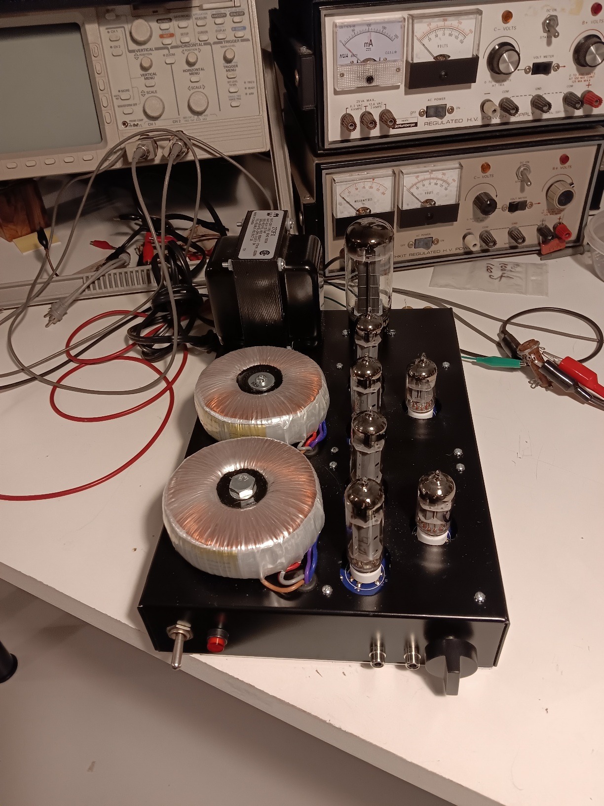

Here is a picture of the resulting amplifier. It provide a pleasant sound with modest power around 12 to 14 watts.
Distortion is well below 0.05% before clipping. The toroidal output transformers work extremely well down to 20HZ providing full power with the same low distortion as at 1KHz. I however was not so happy with the interwinding capacitance of the toroidal transformers as the 20Khz power level is down about 3dB from 1KHz as the 6P15P runs out of plate current trying to drive the transformer capacitance. First time I have tried toroidal output transformers and overall I think I prefer a conventional laminated type.

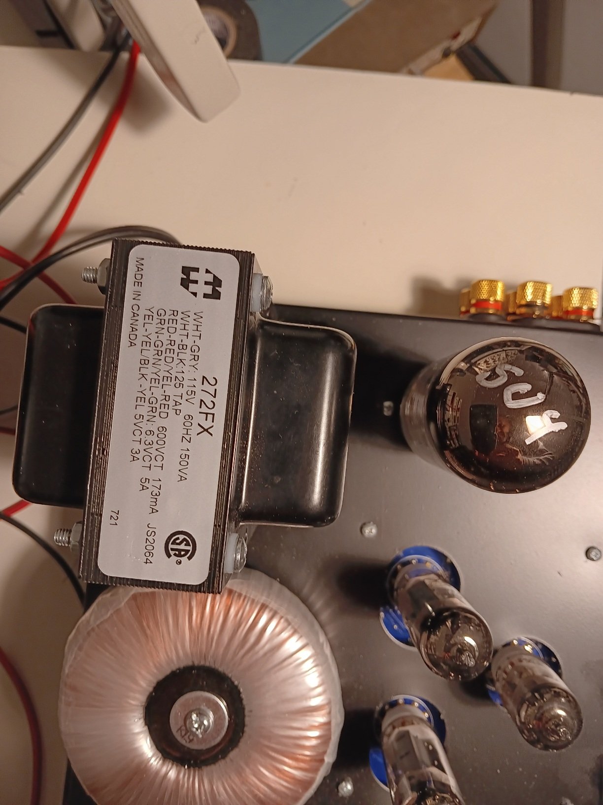

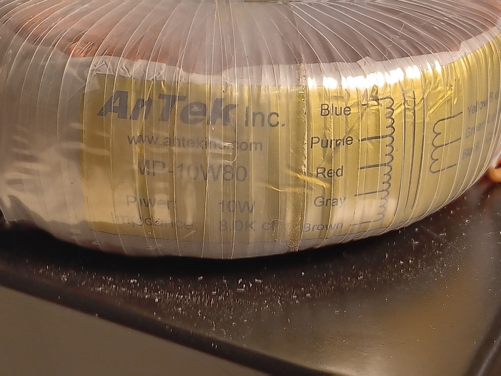

Many thanks for the detailed explanation! The toroidals you are using as OPTs are 115+115V to 6V designed for mains (50/60Hz) operation? In my experience these do indeed not reach 20kHz, mine were down by about 2dB, triode Output tubes and no GNF. Next test will use the secondaries as cathode feedback, I think that could push HF a bit up.
The toroidals are AnTek, model MP-10W80 sold for tube output stages, 8K P-P and rated at 10 watts.
Not sure they are much different in internal construction other than the winding values from the power transformer versions but I have not wanted to cut one open to see how they are made inside. The 10 watt rating seems very conservative as I see well over 10 watts of clean power at 20Hz from this unit PROVIDED the output tubes as well matched and the bias current is matched perfectly (to 1mA or better) in the output pair. Distortion in these transformers rises quickly as the output bias current match between output pairs becomes less accurate. As I said I found the 20KHz performance less than hoped for due to increased current loading of the output tube plates.

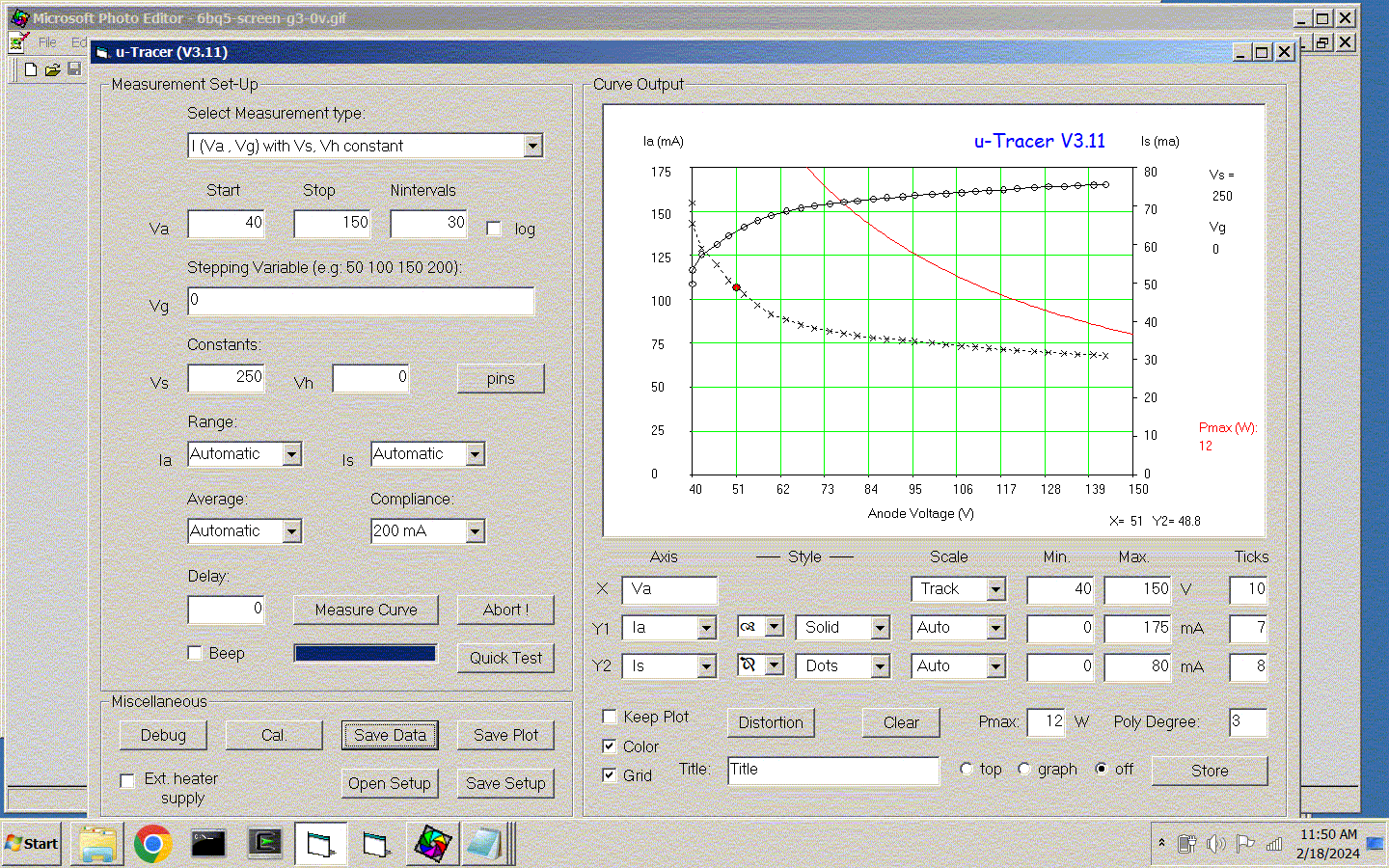

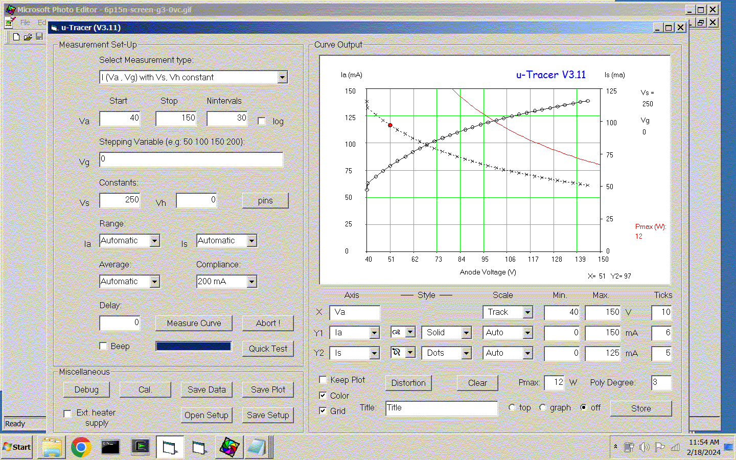

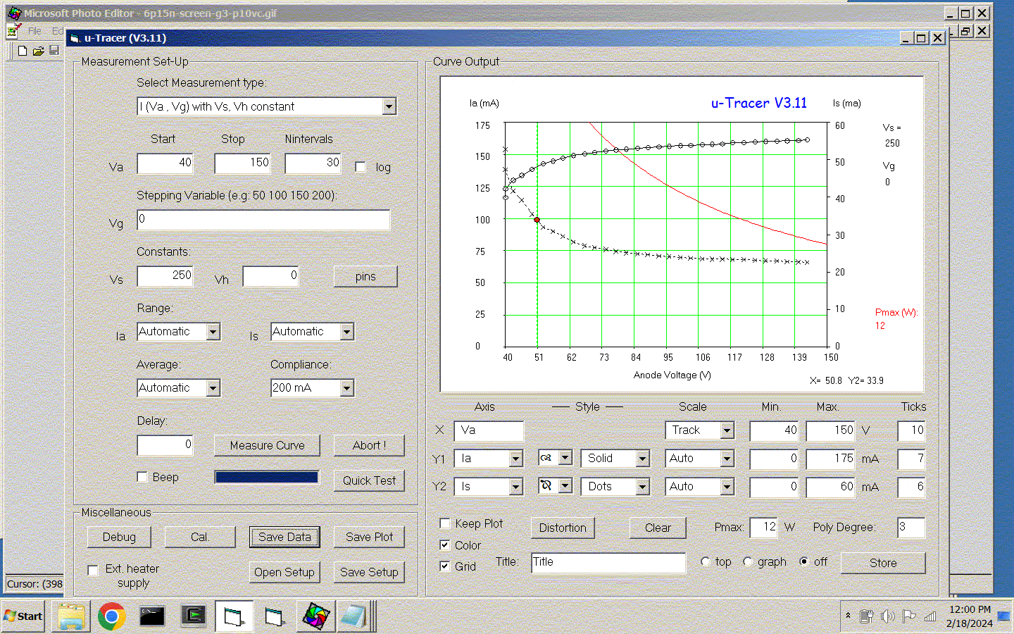

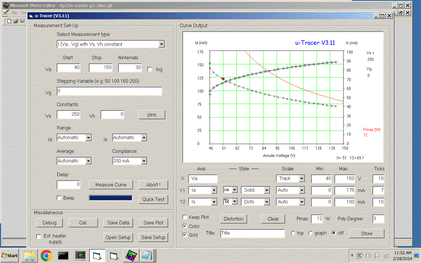

Today I remeasured the 6P15P tube's screen current while varying the voltage on G3 vs a older RCA NOS 6BQ5 I have on hand I keep as a reference as to how tubes really were once upon a time.
The quick summery is yes in fact the screen current in a 6P15P with G3 connected to the cathode is much higher than the screen current in a 6BQ5 under the same operating conditions.
Reducing the 6P15P screen power margin more is the power rating of the 6P15P screen is lower at 1.5 watts Vs the 6BQ5 at 2watts (4W peak). Admittedly comparing Russian data sheets to Western data sheets does seem like apples to oranges but this is what I have in information.
So with higher screen currents and lower rated screen power in the 6P15P it is not hard to imagine some failures may occur when used in 6BQ5 circuits.
Looking at the attached anode and screen current curves for a 6BQ5 and a 6P15P with three G3 voltages 0V, +28V, and -10V, it can be seen the pentode suppression levels are quite different on a 6P15P with G3 connected to the cathode (G3=0V) compared to a 6BQ5.
My guess is the 6P15P was optimized for linearity and the 6BQ5 was for power output.
Having G3 pined out separately is a bonus on the 6P15P allowing the tube to be tuned for linearity vs power output.
A 6P15P with 0V from cathode to G3 shows a loss in peak anode current at lower voltages and a rise in screen current compared to the 6BQ5 showing the 6P15P is a over suppressed pentode.
Compare the curves between the 6BQ5 and a 6P15P with 28V from cathode to G3 the anode. Adding a small positive voltage to G3 has the effect of making it a less effective suppressor. Go too far in voltage and G3 starts to attract far too may electrons away from the plate creating problems again.
With 28V on G3 the 6P15P anode current has now increased and the and screen current decreased to levels are at their closest match between a 6BQ5 and a 6P15P.
Going one step further to show the continuum that pentode suppression is compare the 6P15P with -10V on G3 relative to the cathode and a 6BQ5. The -10V makes the G3 suppressor grid more effective. This curve now shows a large loss in anode current at low voltages and a steep rise is screen current showing a very over suppressed pentode.
In my amplifier design I set G3 for each output pair at +28V by a 1N5255B zener bypassed by a 47uF capacitor connected between the output pair cathodes and G3 with G3 pulled up by a 39K resistor connected to B+. It is important that the zener and capacitor negative end is connected to the cathodes of the 6P15P output pair NOT to ground in the case of self bias. Testing showed it is important the G3 impedance to cathode be kept low thus the zener and capacitor over a simple resistor divider.
With this setup I found the 6P15P happily tolerates 350V on the anodes with 250V on the screens. I used a regulated screen supply with split fixed/self bias for operating point stability. As I use my design amplifier for HiFi I have no idea how well this would work out for a musical instrument amplifier.

The 6P15P seem completely happy in UL mode with 337V on the screens.

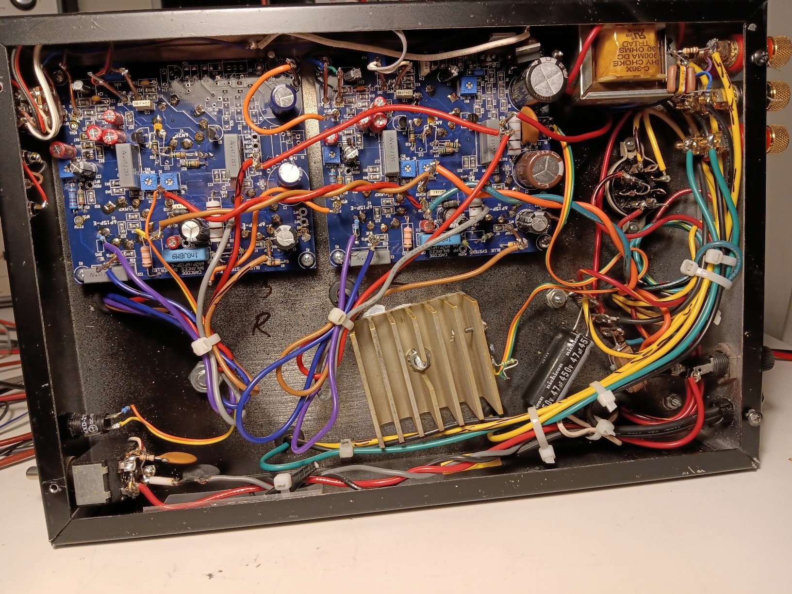

I have set G3 to about 28V above the cathode to limit the screen current (and screen power!) at full out power as otherwise the 6P15P screen current rises to high levels when the plate drops below about 100 volts.
The PCB incorporates a built in high voltage regulator for the low level section providing a totally stable and clean rail.
Perhaps over kill but for me a high regulator is a acceptable added complexity to eliminate concerns about power supply rejection ratio concerns.
The driver stage is a balanced cascode using a BJT and provided with a current source on the cathodes.
This driver stage produces a lot of gain that is low in distortion.
The driver stage output impedance is a bit on the high side for ideal high frequency performance but it kept the parts count down for a fully balanced design.
Fortunately the 6P15P is about as easy to drive as a 6BQ5 and can be quite linear and giving the driver stage a easy time.

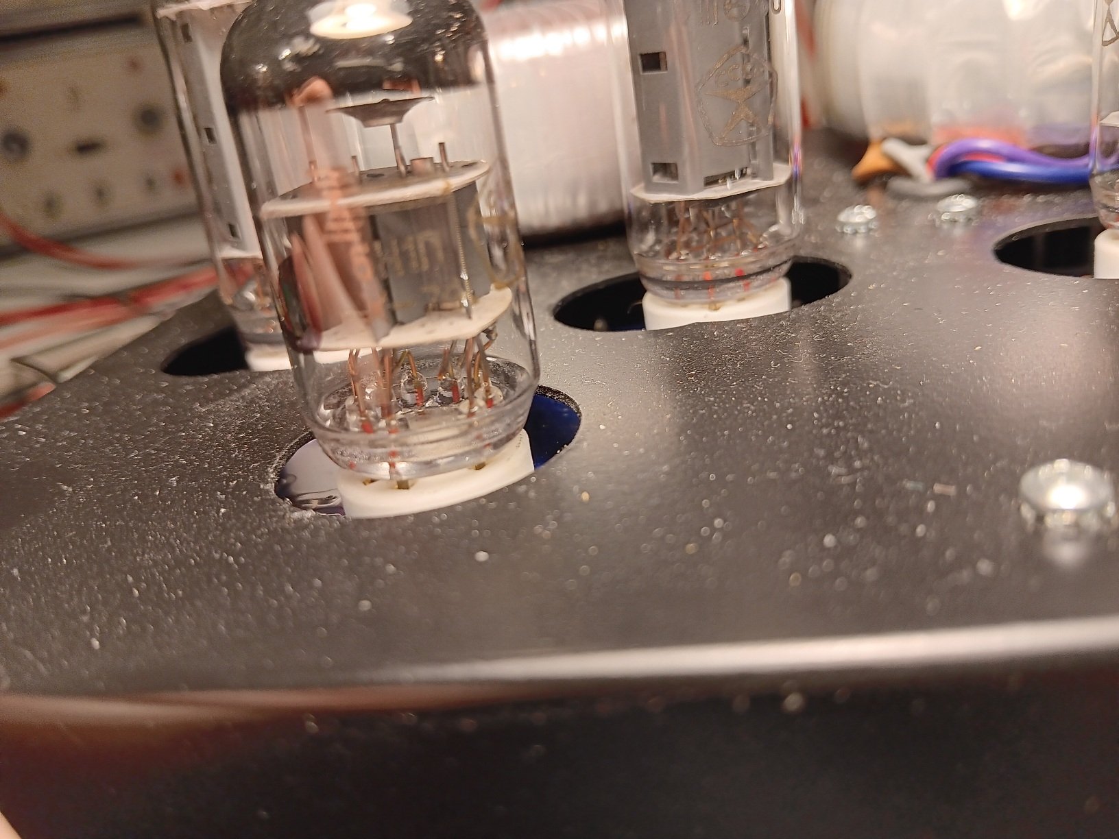

I have attached pictures of the last version I settled on.
This was my first designed from scratch push pull tube amplifier and I learned a lot during this project. Great fun!
I hope you find this of interest.
