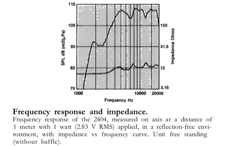

The 2402's really shouldn't be crossed much below 4kHz, it's acoustic response drops off below 5kHz, ~-12dB @3kHz. It's (expensive) tiny aluminum annular diaphragm will shatter at relatively low SPL if crossed lower. Below 2 kHz it's input power should be limited to 5 watts (6.3 V RMS) or less.

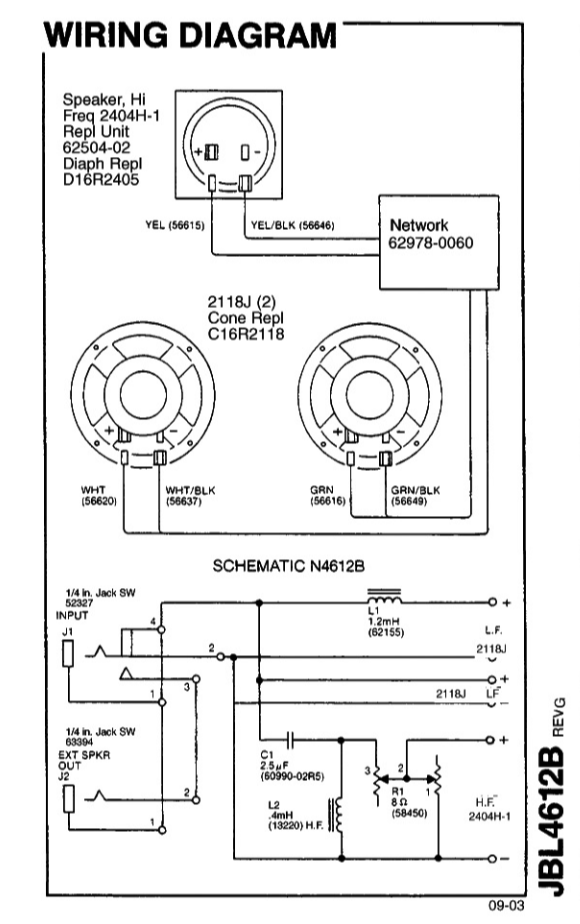

The 4612B runs one of the 8" "full range", no crossover at all, the second has a series coil to roll off some of it's highs, a "2.5 way" crossover of sorts.
I'd suggest running the rolled off 8" below the "full range" 8" on the front of the cabinet for a home theater or music presentation similar to what it was mixed for, whether you use active or passive crossovers or not.

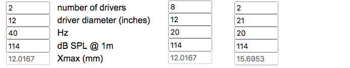

This piston excursion calculator makes it easy to see how much displacement is required (disregarding room gain) for sealed subs:
http://www.baudline.com/erik/bass/xmaxer.html
It is surprising to hear how much musical content there is below 40Hz, and movie soundtracks often extend into the single digit range.
As you can see, takes about eight 12" drivers to equal the SPL of two if your goal is 20 Hz rather than 40 Hz, while a pair of 21" could do the same SPL at 20Hz with a bit more excursion.

If you actually 'have your hands on' a pair of 14mH inductors as indicated in the circuit diagram above >
I have a very adventurous project for you to try >
1. You separate the "Lower (sub) Woofer" and its 14mH inductor from all other crossover components. This means the 'sub' will be its own independent
circuit connected to the amplifier. [ with the possibility of a series resistor needed ]
2. You mount the 'sub' Face to the rear of the speaker box. In this way, you slightly add some volume to the enclosure, rather than subtracting.
3. You add a 'blanket of 1cm felt' > glued to the interior of the wood cut-out > this makes the 'sub' think it is seeing a larger box.
This scenario could be called "an actively assisted rear port" OR "an actively assisted rear passive radiator" but with far more output >
Giving you SUB output
When such a design is located in the region of a room corner, a horn-loading effect can come into play greatly increasing Low Bass output.
[ a resistor or EQ may be required to customize/tame things ]
The Phase orientation/wiring of the rear driver WILL be immediately obvious when you get it right.

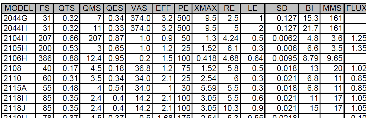

Thanks Audio>X I am not sure I fully comprehend this approach. Would the extension still not be limited to the Fs of the driver, which is pretty high ( can't recall exactly what). Do you have any links to arcticles on this or any sketches images? Very interesting I love to try something unusual. Onslo
Yes, I do understand that your drivers do have rather high Fs and are identical.
I was really just re-posting 'Food for Thought'.
I was thinking that you could use both your 8" 16ohm drivers in parallel on a front baffle [ maybe too loud ? ] and then also incorporate a
rear mounted 10 or15" sub that has reasonably high efficiency and low Qts.
There are actually quite a few Car Subs @ reasonably low cost that can work well, so long as you use a very high value inductor with useful DCR.
Of coarse, you need an amplifier that is happy with a 4ohm load.
PS.
If your 8"s are too loud, then series wiring could be the way to go 🙂
Yes Audio>X they are monstrous drivers but doesn't look like they will suit this application as the ported enclosure calls at 200l and sealed box over 2000l. I am wanting a small enclosure so need to explore other options. However two of these in an isobarik install in 100l box would be useful.
