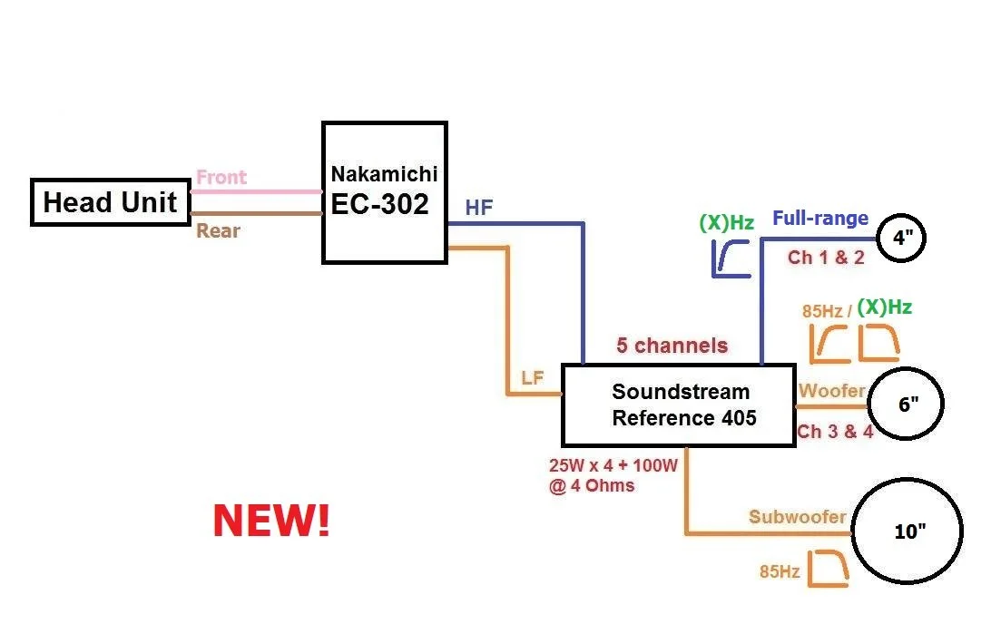

As can be seen in the diagram, there are green labeled (X)Hz. They are meant that there's still no information about crossover frequencies on them.

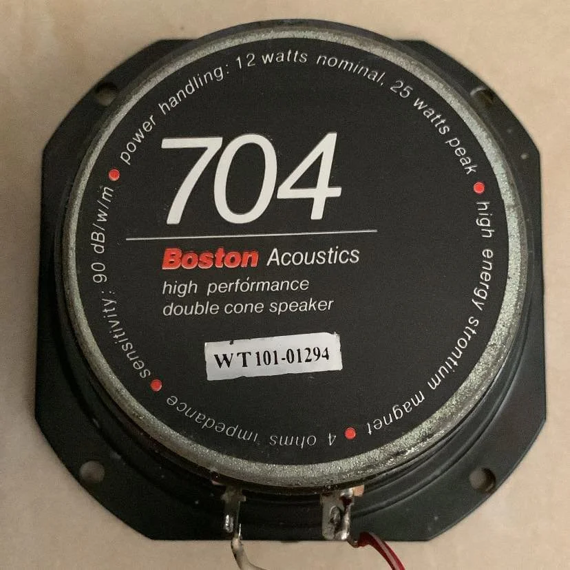

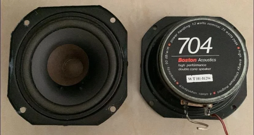

The cone drive units will be used are full-range 4" Boston Acoustics 704 speakers, see pictures attached for specifications. Here is the question: what frequency should be applied to the 4" full-range driver as a high-pass crossover and the 6" mid-bass drivers for a low-pass crossover?
