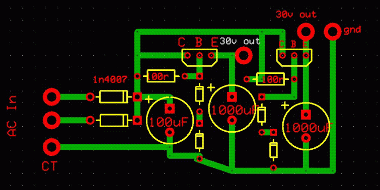

Hi, so would something like the attached curcuit work??
It uses two 1n4007 diodes for rectification and two 15v zeners in series to get the 30v regulation, I also added a Pass transistor ,i"m thinking i"ll use a 2n2222 which is a 600mA NPN transistor......
I also made it 2 regulators to share the current....
so does the curcuit look OK?? are there any changes I should make??

the 100r feeding the Zener string needs to be re-calculated.
If you use 400mW Zeners Imax=400/15=26mA.
Add on a little base current say 4mA.
the voltage drop across the 100r is V=(0.026+0.004)*100=3V
Vinput =Zener string +3V=33V
this is the maximum voltage that that the input can take before the zeners are overloaded.
They will be happy running at 10% to 20% of maximum rating.

Be carefull with that large 1000uF at the emitter of the transistors. That thansistor has to charge the cap at turn-on which can draw a LOT of current and damage the transistor.
The 1000uF doesn't do anything anyway because the output Z of that emitter is very low and parallels the 1000uF and is MUCH smaller in impedance than the cap.
For stability you may use a small cap there, say 10uF

If you are trying to power all 6 modules from the proposed circuit, it won't work. The power rating of a 2n2222 is around 1 watt so at 200 mA the voltage needs to be less than 5 volts.
