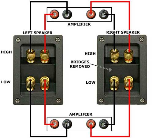

I have two NAD 3020 and I would like to to use both of them for more power. If thats not possible, maybe use them in a preamp- poweramp setup.
1. Is it possible to setup 2 amps to the loudspeakers (Heresy III) getting more power? For the Heresy loudspeakers biwiring is possible.
2. If above isn't possible to setup would it be good for the sound to use one 3020 as a preamp and the other as a poweramp?
All ideas are welcome!

Bi-wiring and bi-amping is not the same .
In bi-amping each NAD 3020 will feed ONE set of speakers --either the LHS or the RHS --thats feasible and that will give you more perceived power.
Bi-wiring is two sets of wires from the SAME amplifier for each channel for the high frequency section and the low frequency section --please bear in mind a tweeter is easily blown and will ( normally ) only stand a few watts but if you have a FULL RANGE loudspeaker unit then that is a different matter.
On the other hand this is disputed and bi-amping is classified as using a dedicated power amplifier for the lot - woofer /tweeter by REMOVING the crossover and using a built in specially designed amplifier feeding each section aka--- an ACTIVE crossover .
This subject has started "flame wars" elsewhere and I am not about to get into one but the NAD 3020 has separate preamp and power amp connections so some sort of arrangement is possible .
If anybody has a different opinion I am not going to get into an argument over this as books have been written on the subject.

So how would the setup look like bi-amping and are my amps functional/similar enough, as it is important? I guess there can be some differencies even if it is the same model.
I understand how to wire between the amps and loudspeakers. But from the source? I use turntable and mobile , Spotify.

Great! And then, refer to NAD manual, put the source Into first amp? Or do I also need a preamp and a active crossover?

With the ingenuity and knowledge, you can connect one amplifier to the input (crossover) of the subwoofer.
The second amplifier in the mode without preliminary amplification, turn on the line output of the first. Connect the amplifier output to the midrange input (crossover). It is advisable to put a non-polar capacitor at the input of the second amplifier, limiting the band below 500 Hz.
I do not recommend bridging because of the minimum impedance of 4-5 ohms
In this case I would definitely need a preamp and a active crossover. Are there cheap crossovers that is good?
There are many analog graphic equalizer units for sale used for ~$40 plus freight. You can use two channels of a stereo to set up low and high pass bands. Most pros now are using digital units and programming them with cell phones.
Else buy something new from parts-express or even behringer. 12 db/octave give sharper cutoff than 6 db/octave crossoevers. Note speaker crossovers are not suitable for bi-amping.
I will bi-amp as in picture. But I don't know how to setup the source, I guess to first amp.
