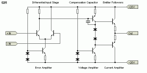

Look the picture attached, there are two diodes to drop VBE in output stage (class-B),to a greater bias simply increasing the number of diodes, would be better that resistors?
Adding another diode is too large a voltage jump, thats why most use Vbe multiplier wich lets you dial in the exact amount of bias. The main reason diodes or transistors are used to bias the out put is so the bias becomes temperature stable. These diodes are mounted right on the out put tranies or on the heat sink so they are the same temp. these diodes do not have the same purpose as the other diode chains. the other ones in the above cct. are V refs for the current sources.
