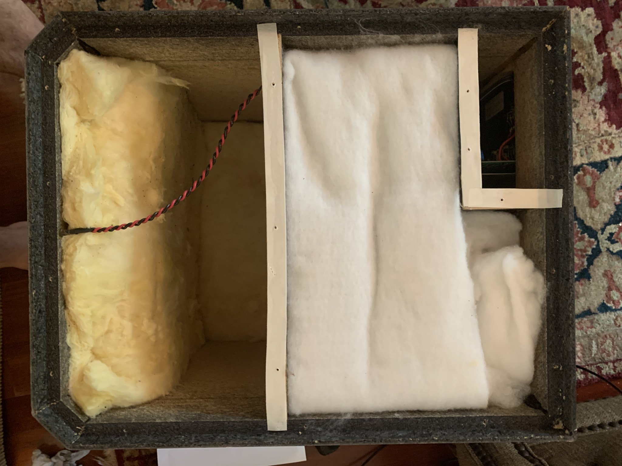

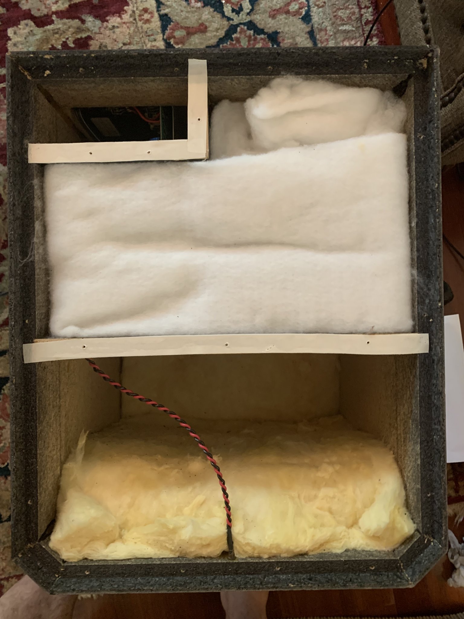

I have carefully measured all dimensions of the bandpass enclosure and I have removed the original 12" driver for the Paradigm PS-1200a (Part # B156WFPS01200A 0299) and will refoam it. I could not find parameters for it online so I will contact Paradigm to see if they have them.

OK, parallel 6th order (BP6P), so once we have the dims of everything, should be able figure them out by 'trial n' error' in Hornresp or WinISD, especially if there's frequency/impedance plots.
looks like they isolated the amplifier section so there is no air leaks.
unless I am missing something it looks like 4th order?
front chamber looks a little large, but after subtracting the amplifier section, ports , and driver
the volume will make more sense.

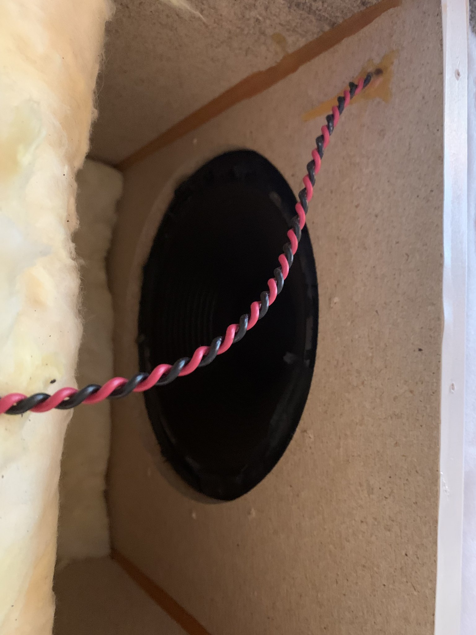

Note the three vent tubes with the top one running through the white damping to the low pass filter chamber.

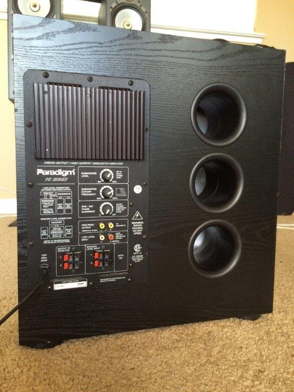

To clarify, I think it is a 4th-order Bandpass design. The three 3.5" diameter ports all extend into the enclosure 5". None extend into the low pass filter rear chamber. Please see the additional pictures below. The enclosure internals are seen by removing the bottom of the cabinet and I rotated that image so that directionally aligns more closely with the other images.

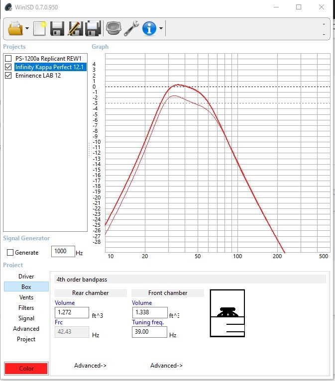

I still have not heard back from the folks at Paradigm. In the meantime, I have calculated the volume of my ~35 year old Paradigm PA-1200a, 4th order bandpass subwoofer. The built-in amplifier puts out 130 watts RMS. WinISD modeling of someone's suggested Eminence LAB 12 driver is seen belowOK, thanks! Late night insomnia did me in again. 🙁
The rear, ported area = 1.338 cu. ft. (I accounted for the .128 cu ft displacement of the 12" driver)
The front sealed area = 1.272 cu. ft.
IMHO the Eminence LAB 12 is not a great driver for this subwoofer. Your thoughts?
Vent diameter = 3.5", length= 5"

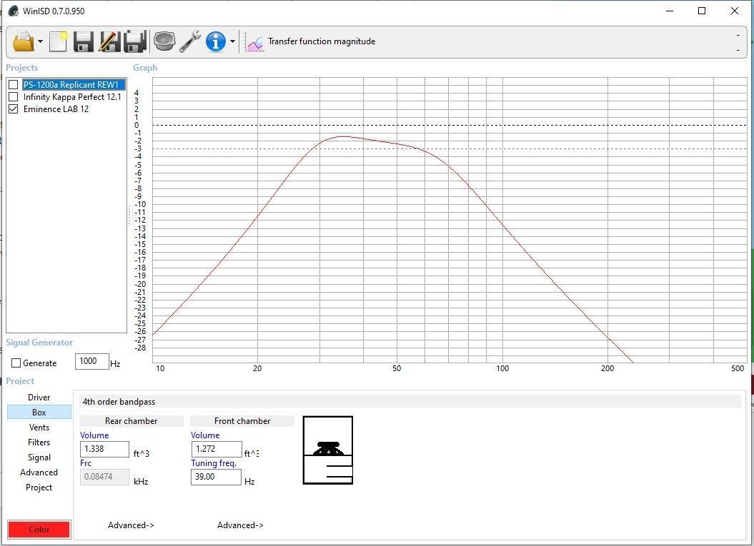

I also note that WinISD describes the "vent" as being in the "Front Chamber". (See second image below). As a result, I have changed the entry of my dimensions to match WinISD.
I have now entered the ported box dimensions into what WinISD calls the "Front Chamber" and I entered the sealed box dimensions into what WinISD calls the "Rear Chamber". Is this now correct for using WinISD?
The graph for the Infinity kappa perfect 12.1 driver looks better than the Eminence, yes?

3.5" x 5" port or 8.89 cm x 12.7 cm
cross sectional area of single port is 62.2 cm2
total cross sectional area 186.6 cm2
WinIsd and Vituix Cad both give a Fb of around 87.6 Hz
with .850 end correction ( dual flare)
so
36 liters x 36 liters 87 Hz Fb
unless of course these are 3" ports? and you included the flare
then Fb would be around 77 Hz
for the most part this is a pretty straight forward 40 Hz
sub designed for drivers good for around 150 to 200 watts
-3 dB response is going to be around 40 Hz
with many different drivers.

My numbers are negligibly different, but I did misread the Wizard's displacement minima due to needing stronger reading glasses for HR's plots, so ~75 Hz Fb in lieu of ~65 Hz with the 3.5" dia. with whatever end correction HR uses for a summed ~6.06"/15.4 cm dia. (assume basic 0.732), so no clue why the discrepancy.
Re the Infinity Kappa; it's a 'one note wonder' @ ~83 Hz ditto the Lab12c.
Changing the Lab12c's specs to a 34 Hz Fs, 0.39 Qts + 0.5 ohm (Rg) for wiring losses yields a ~50 - 110 Hz F3 flat response, so at least a starting point if we can get the various program's discrepancies ironed out.
