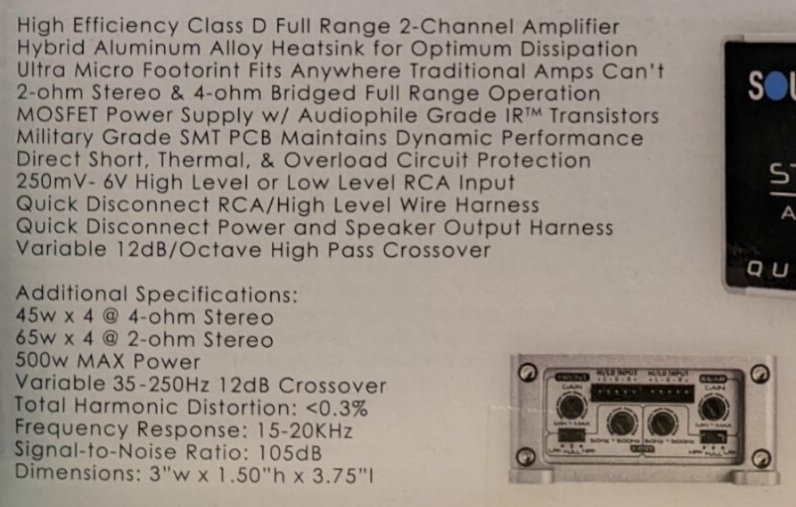

Anyone use their leftover / extra Car Audio stuff for home HiFi? One would think - by now - the name brand car audio stuff would have specs that far exceed what is considered good for noise, distortion, frequency response et al. 12V power shouldnt be a mountain to overcome...
I picked up a Rockford Fosgate R-150 / 2 at a gamble price; the blue light came on when I powered it up. Sounds good to my ears in my garage system. I'm going to try a FRFR for guitar / vocal with it, with two FR speakers and amp / cab models upstream.

The particular amp I found says it'll handle 12 - 16V DC power. I assume that's to accommodate the racket in a 12V auto power system.
If they can guarantee operation at 16V, what's the actual limit on the switching regulator inside the amp, assuming there's probably still some margin on top? Thinking 4 LiPo cells, at 16.8 full charge, falling to maybe 13V at end of charge.
Worried about that 0.8!
