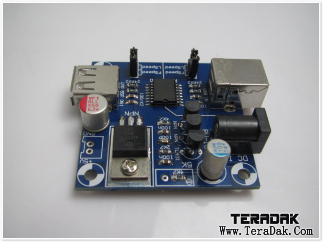

ADUM4160 USB Isolator
I ordered one of these recently for T&M purposes....AUD$26.00 including postage.
It hasn't arrived yet so I don't know how well it works.
This board isolates USB data lines, isolates earths, and allows injection of +5V to power the peripheral device, ie USB soundcard.
