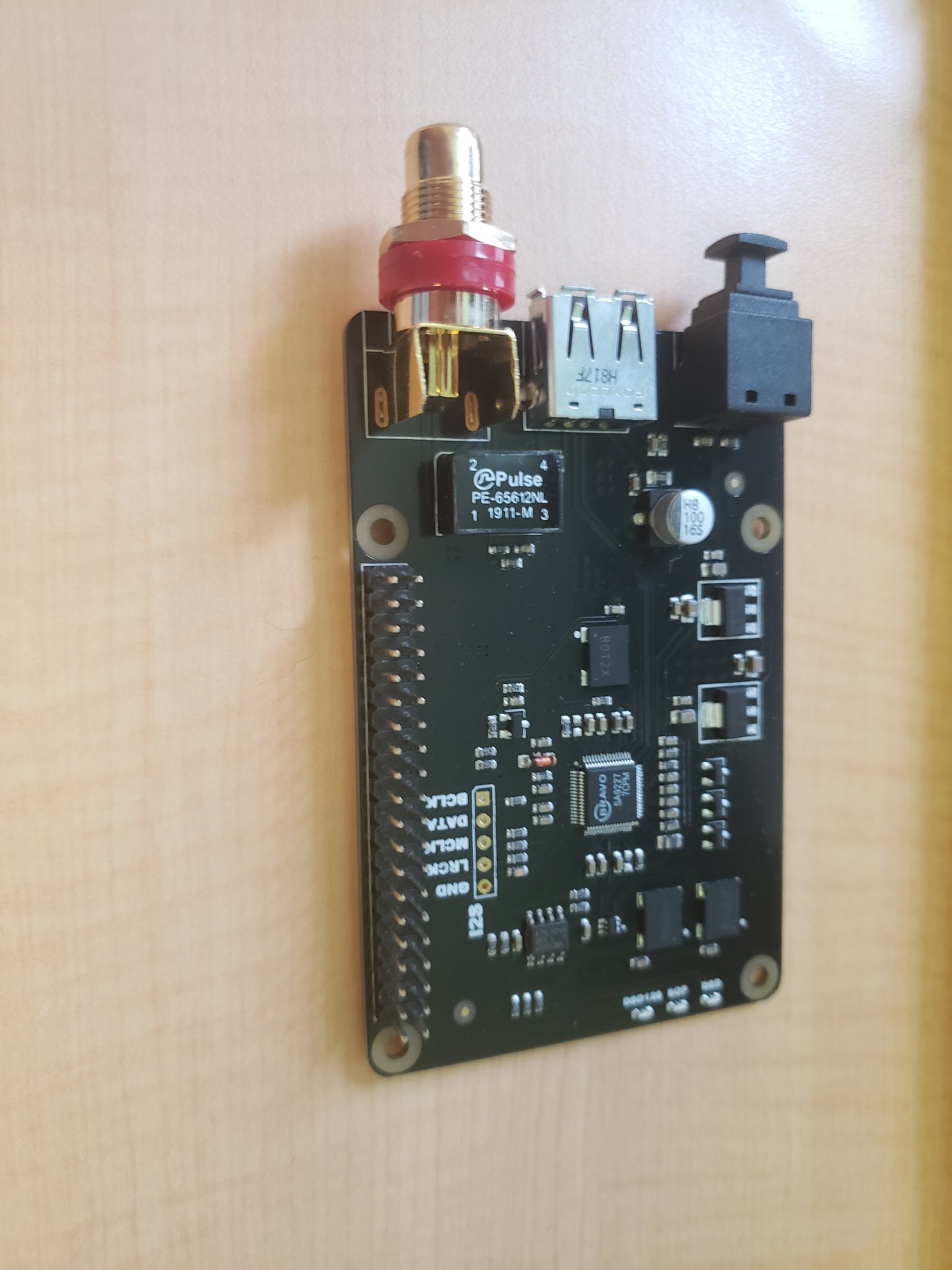

Hello, Guys.🙇♂️I am using Pi3b+ with picoreplayer OS for my main audio system. I have different DAC hats for my Pi but it can use one hat only at once. Thus, I want to use the inactive one as a stand alone dac for my PC. I purchased a usb to I2s converter from Suptronics and plug-in with my dac hats and power hat. However, there are no response from all my dac hats. I tried the coxial output from this converter and it worked. Therefore, I don't know how to fix. Does anyone use it before? Thank you so much.
Many of the DAC hats need initialization/control via I2C or GPIO, performed by their respective RPi linux driver. Also some use I2S master, some I2S slave. Have you checked your DACs conform the plain I2S-USB bridge?

Which R2R DAC do you have? Exact specification is important. Even if no extra control lines are required (I2C, GPIOs), the I2S can have a number of incompatible configurations (e.g. master/slave, LJ/I2S format, 16/24/32 slot width).

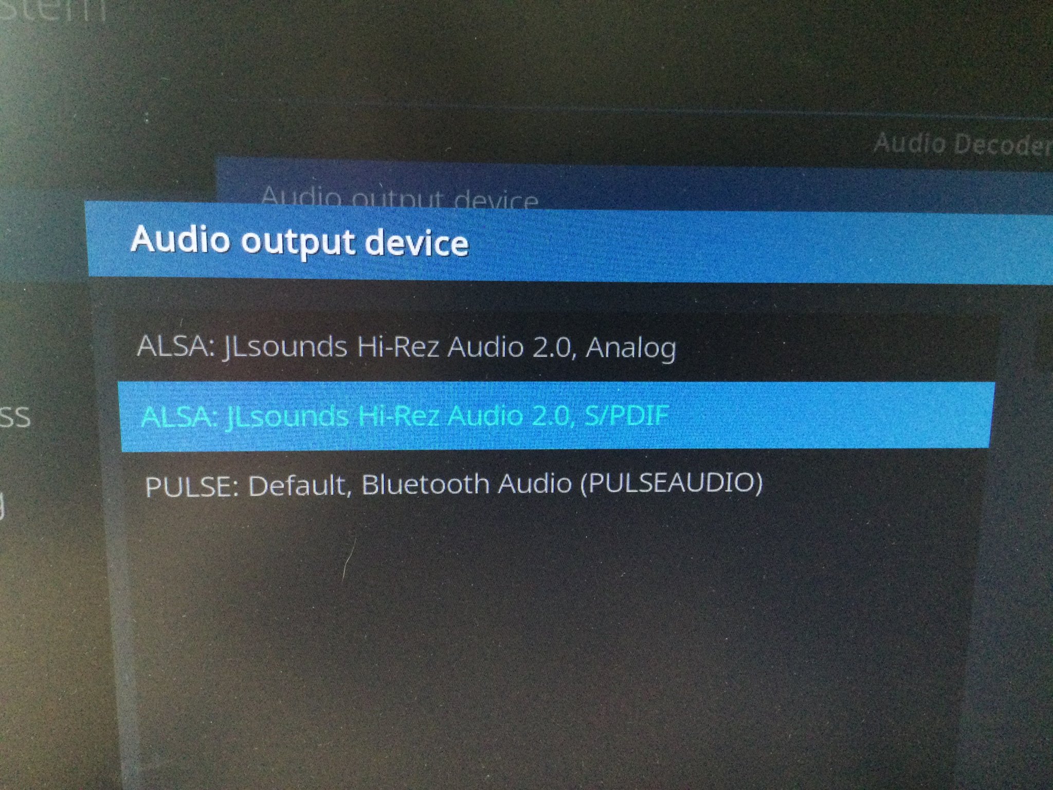

Have you checked that the USB IF has been recognized by Linux and a driver has been installed for it?

… or install e.g. LibreELEC and check system audio settings. IF should show up.

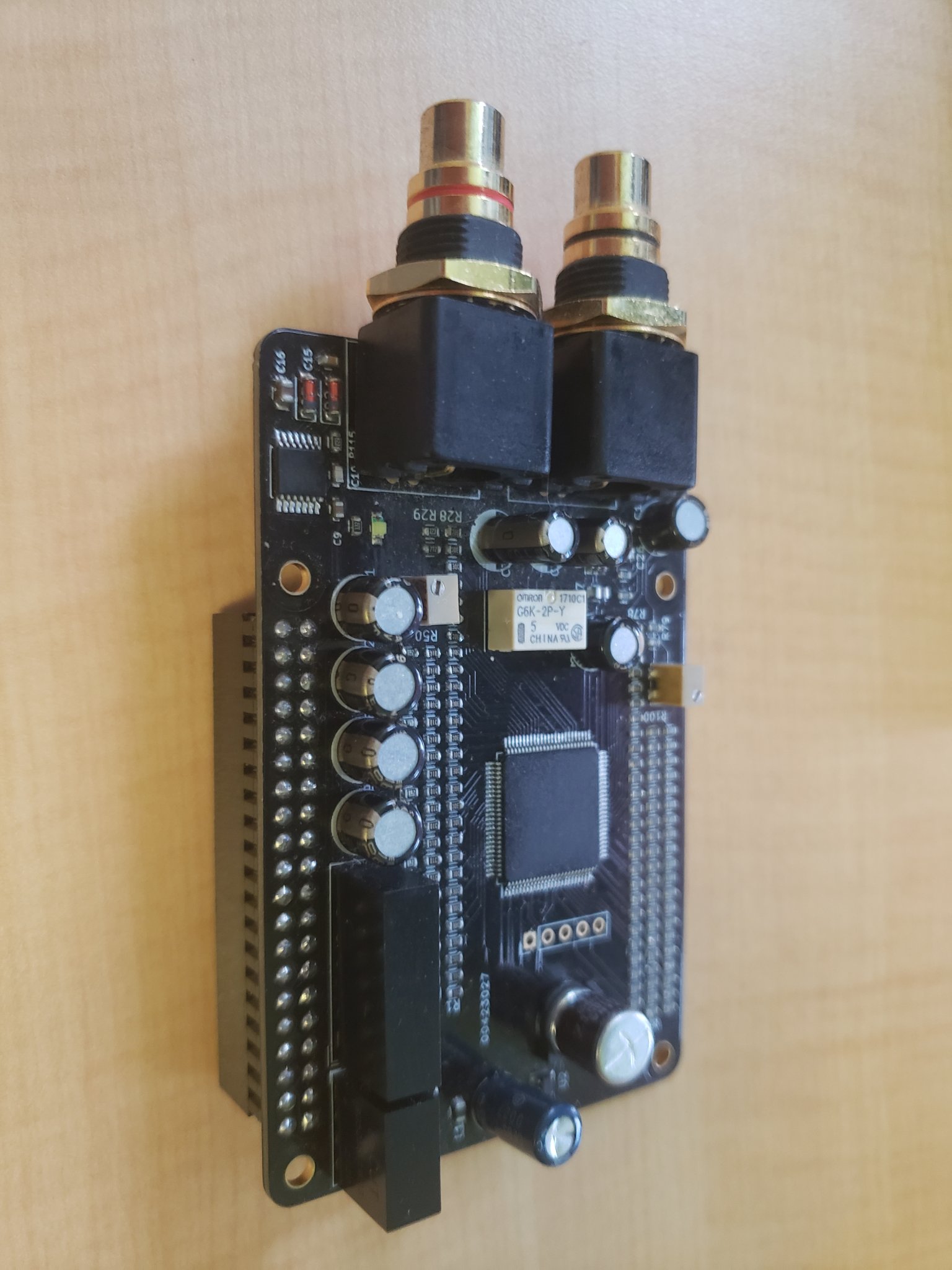

This is my another R2r dac🙇♂️🙇♂️Which R2R DAC do you have? Exact specification is important. Even if no extra control lines are required (I2C, GPIOs), the I2S can have a number of incompatible configurations (e.g. master/slave, LJ/I2S format, 16/24/32 slot width).

The usb converter can be recognized by my PC automatically. It works when I am using the coaxial output.Have you checked that the USB IF has been recognized by Linux and a driver has been installed for it?

… or install e.g. LibreELEC and check system audio settings. IF should show up.View attachment 1069660
