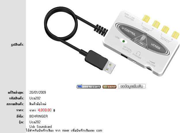

Helmuth,29 euro its very cheap but when it comes to thailand. its very expensive(around 85 euro) diy in thailand thiks a lot when theywill buy.
