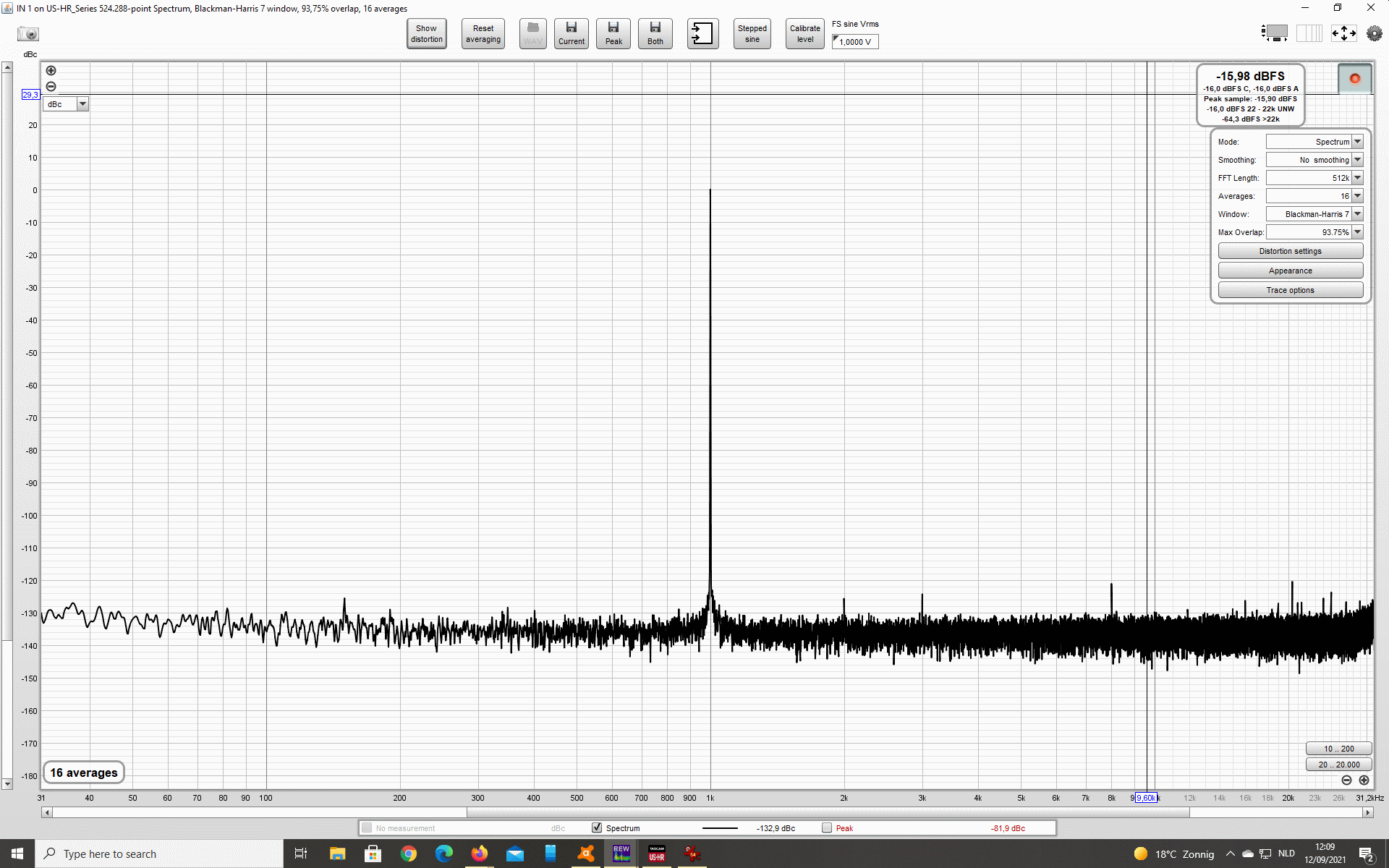

I just checked that and found THD+N of the ADC only .017% i.e. >2x worse than your "0.0007 THD+N loop-back". How could that be possible?Check audio science review for tests on the MOTU M2. It has around 0.0007 THD+N loop-back.

Sorry. I thought it had the same specs as the M4... (they advertise it as having same spec, right?). I have an M4 and am very happy with it. I haven't connected to my AP yet, but Audiotester suggests the -104dB THD+N figure.I just checked that and found THD+N of the ADC only .017% i.e. >2x worse than your "0.0007 THD+N loop-back". How could that be possible?
https://www.audiosciencereview.com/forum/index.php?threads/motu-m2-review-audio-interface.19911/
thermionic, I see that test as well https://www.audiosciencereview.com/forum/index.php?threads/motu-m4-audio-interface-review.15757/
ADC THD+N -104db then loopback should be 103db or so.
