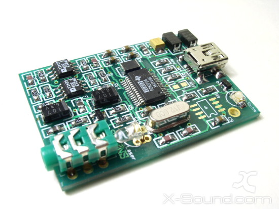

What I'd like is something in the middle. A kit board with the USB controlled and DAC chip(s), but DIY power supply and analog output stage.
Maybe get a cheapo commercial thing and rip the board out to do my own mods?

So the samples come with an evaluation board do they? That wasn't clear from the web site. It looked to me like the evaluation kit cost $149 US.
Looks like the PCM2707 is a nice option to use with a separate DAC chip. For the built in DAC then the PCM2702 seems the way to go.

No, they dont come with an eval board.
But its not difficult to make up a board using somthing like vero-board (strip-board).
Wouldnt be pretty, but then again, neither would be the hack jobs you would have to do to other products.

Here's a couple ideas
The first is a real product: the TwinDac Plus, also available as a kit
http://www.diy-systems.com/
click on "Electronics"
The other DAC is not available yet as far as I know, but the folks at Ack! dac are working on a USB version of their dac.
I have not heard either, but Bert at bd-designs is one of the few people whose opinion on equipment I trust.

Good it may be. Good it better be since it costs $2000 US!
I was rather thinking on something along the lines of this product:
DIY Eden USB DAC
But is seems (I can't read chinese) to be no longer available.
