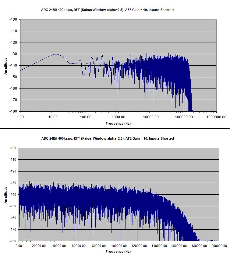

I'm going to try to capture the output of some of these with a 24bit 400Ksps ADC board here at work. Not saying the THD, IMD of this ADC would be better, as the plan is to test the ADC board with these DAC's. Should be an interesting test to compare all around, tho.

P.S. Attached is a quick noise floor of the ADC board here. It's quite easy to see the roll off of the anti-alias filter in the linear frequency plot. Overall, not too bad considering it's powered with a couple of switching regulators 0.5 inches away on the same board... 😉

Attachment didn't seem to make it through...
