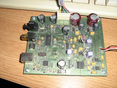

Hi all
Here is my work.
Some specs:
USB 24 bit 96KHz
TAS1020A
SPDIF 24bit 192KHz
CS8416
DAC CS4397
PGA2310 volume control
volume and usb/spdif switch controlled trough usbaudio classes requests (you can set these from your windows or linux(alsa) mixer)
If you are interested, let me know.

HI,
seems to be interesting.
can you post some measurements ? RMAA / noise @ fullscale
is it a real 24 Bit / 96 KHz signal ?
thx!

Yes you can do 24bit 96KHz with TAS1020 a little tricky but you can.
http://www.diyaudio.com/forums/showthread/t-49204.html
The board is still in development you can see some wires in the pictures.
When its done I post the schematics and the gerber files.
I'd only be interesed in a separate TAS1020A USB/I2S board. The CS4397 is pretty average and the PGA2310 really unacceptable.
