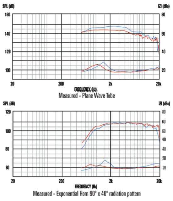

so it is a 1745/6 with a polyamide diaphram?
Yes, that appears to be the difference. What intrigues me is the response below 3000 Hz compared to PETP film models. I'm looking to replace the CDX1-1425 with a driver that will have better response below 3K. The 1425 is a fine driver above that 🙂
Thanks for that dumptruck, the 1747 appears to be a step up to my 1425's too with the exception of the some wiggle in the top octave. I'm looking to use them in 350 Hz flare round tractrix horns from 2K up. The 1425 sounds great in them but is a bit weak in the lower presence area. I think the 1747 will be better.
