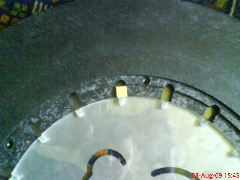

Not sure how many I'll need. It will depend on whether or not I'd be able to string them together end to end on the 2mm side and be able to get consistent lighting between units when butted up against some white diffusing plastic.
They're to illuminate a 2" long by 1/16" wide slit in a faceplate for power on indication. So if I'll need to run them side by side instead of end to end, I'll need at least 50 of them (there are two chassis).

You would most likely get a much more even distribution of the light, if you used an acrylic light guide. It is easier than you might think.
A 2mm sheet of acrylic, will sure get you there. I have made something similar for my new amps, to avoid irregular light intensity over a surface of like 6dm2.

This is how I got around the issue.
