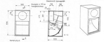

I may have misunderstood the question, but it seems like you can derive the cuts from the angles they provided (I highlighted them in yellow).
I wrote the final angles assuming a straight right-angle cut as "90" although depending on the tool you use straight up and down might be 90 or 0, so adjust accordingly.
Perhaps somebody would be kind enough to check my work, but I think it's correct.

Oops, I'm sorry - I did misunderstand, and did the easy part that you probably already knew.
OK:
The first one should be 1/cos(30) * 270
cos(30) = 0.866, 1/0.866 = 1.155
So the length should be 1.155 * 270 = 311.85
The third (longest) should be 1/cos(15) * (656-152)
cos(15) = 0.966, 1/0.966 = 1.035
Length = 1.035 * (656-152) = 1.035 * 504 = 521.64
I don't really know how to approach the shortest piece, since there are no right angles. I know it's possible to calculate, but I'm not confident enough in my skill in this area to give it a go. Sorry.
And again, I wouldn't go cutting a bunch of MDF based on these numbers unless you can get similar results in software, or somebody comes along and agrees I've done it right.

I think i found the solution .. thanks for you time !!
My result's were :
The first one ( the front one ) : 365 mm
The second one ( the longest , it face the scoop ) : 515 mm
And the small one , the bridge: 140 mm
I got a milimetric paper and draw a 1:5 scale model ... they i mesure those number's..
The value are close , i think the best is to cut them bigger and adjust them with my saw .. ( circular saw )

if there is no right angle,use the SINE rule
it looks like
sin a/A = sinb/B = sin c/C
i did it in 5th form but cant remember how to use,very simple with a calculator,but again,if u use CAD<the program will tell you angle in a matter of seconds,assuming you drew correctly.

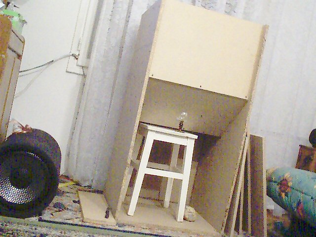

The scoop isn't finish yet ... it's an 15 " version made out of 18 mm MDF .
The scoop curve isn't finish , also i have to cover the whole box with a textile material , recomanded for speaker's and some connector's .. and the most important a driver ... hope it will be an selenium driver or an eminence one .
Promise to post a picture with the finish scoop's and the windows of my room breaking 🙂)
