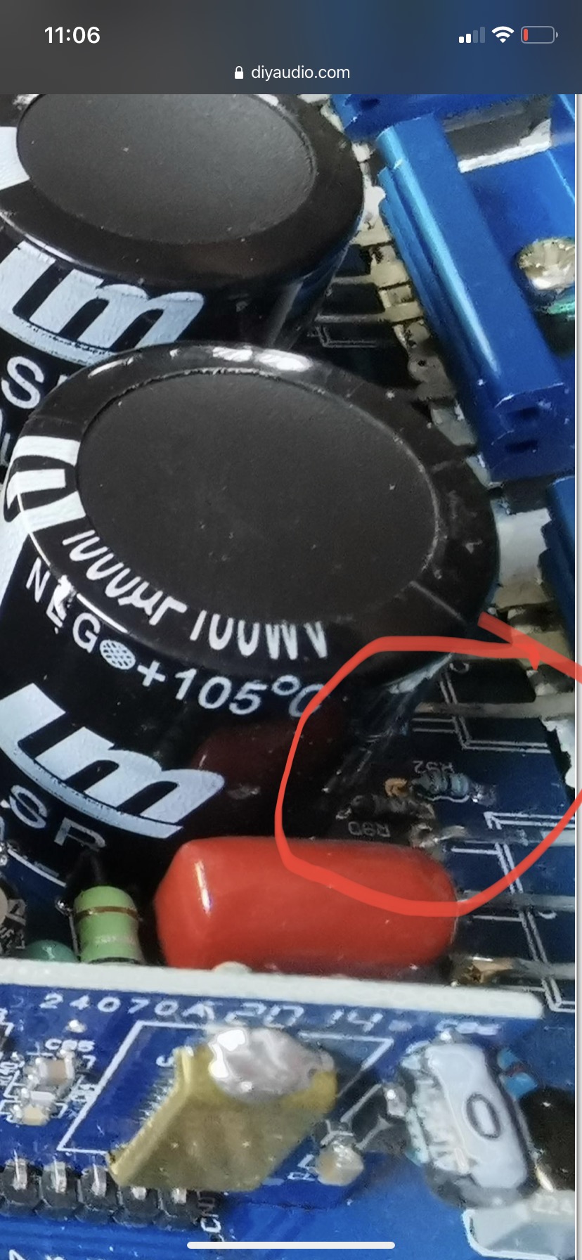

Hello, i received this amp. It starts clipping very early. It seems, everything ok.
Tested at 2.4 Ohms, input current 130Amps, 12,3V, the amp starts allready cliiping, and railvoltage drops from 88V to 70 Volt.
Railvoltage looks also very low to me. Railcaps 160V, Railvoltage +88V, -88V.
It looks, that one transfomers is damaged, but i cant desolder, because plenty glue arround..

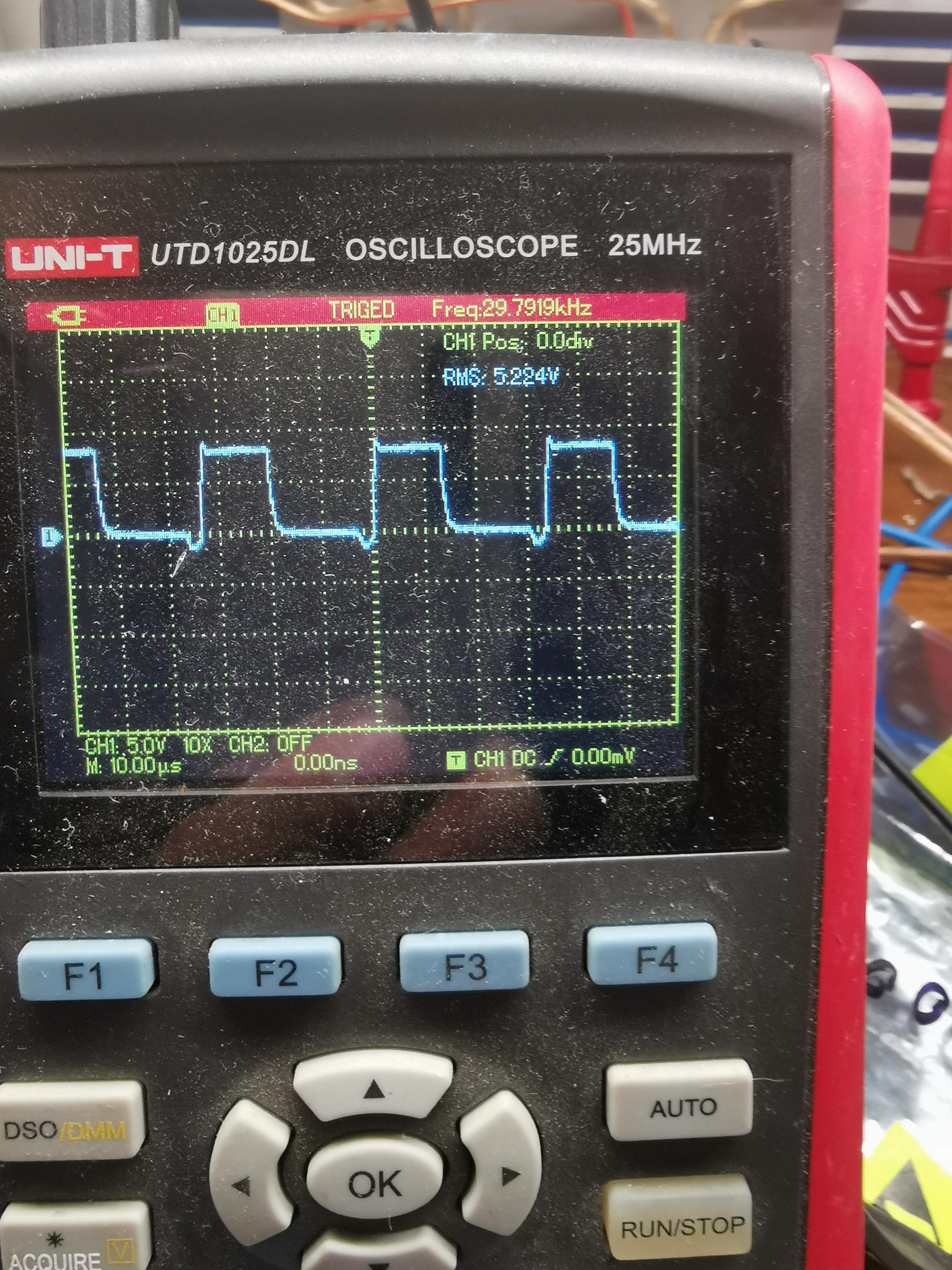

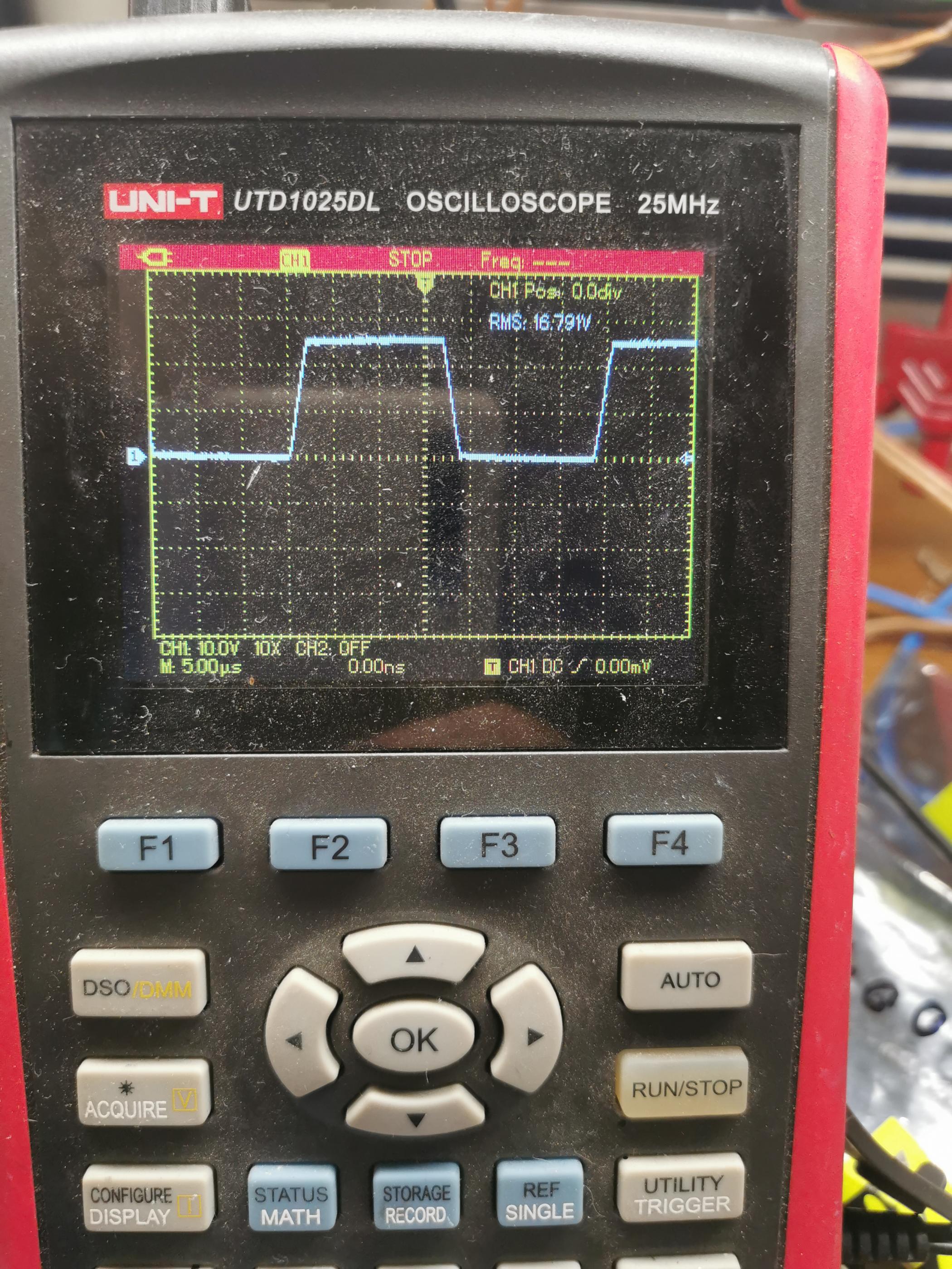

On the gatepad PS i have only 9V, also at the driver transistors for PS 9VDC,
maybe thats the reason.
Is that 9v measured with a multimeter or is it the amplitude seen on a scope?
What is the duty cycle for the drive circuit?

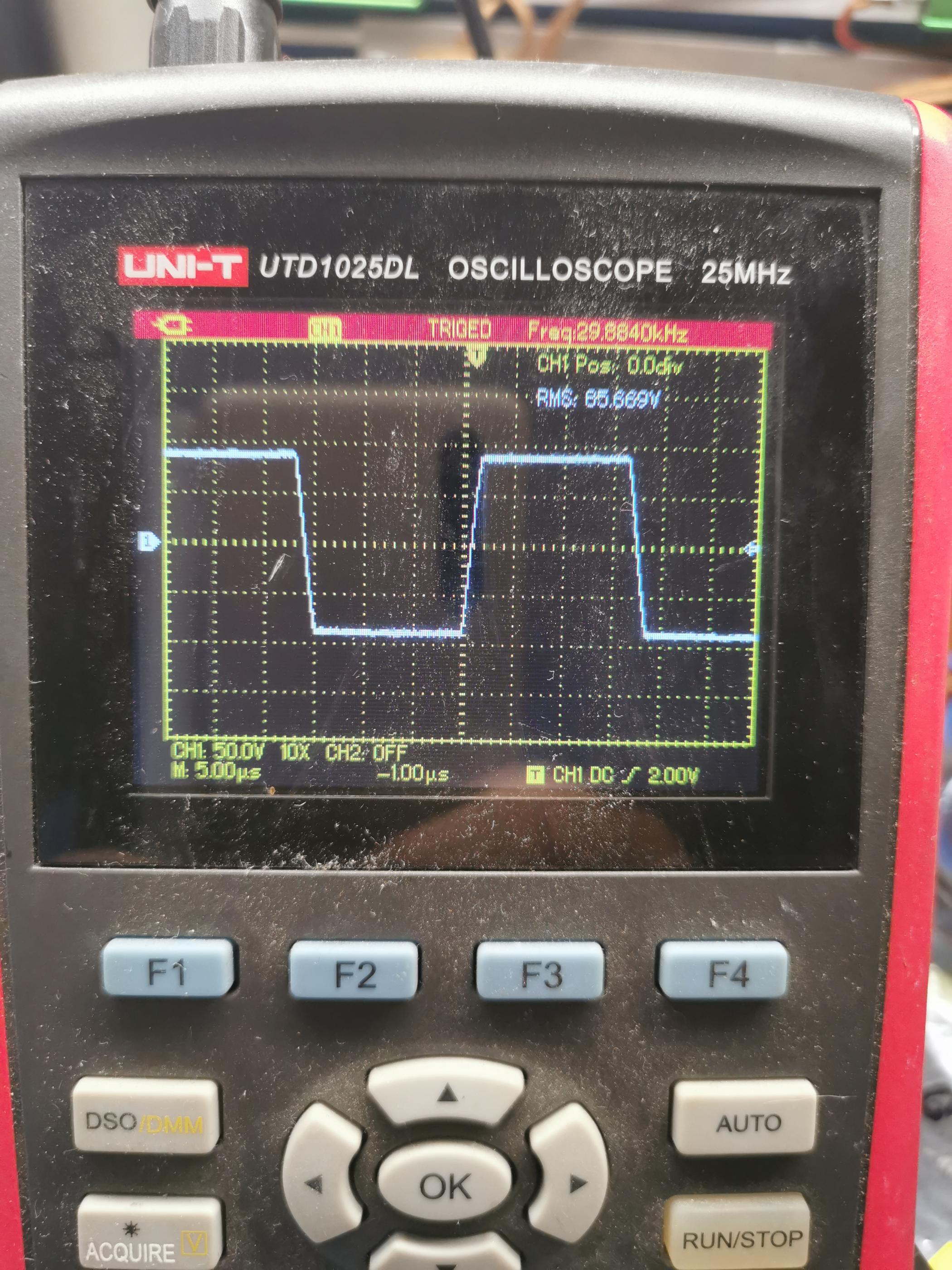

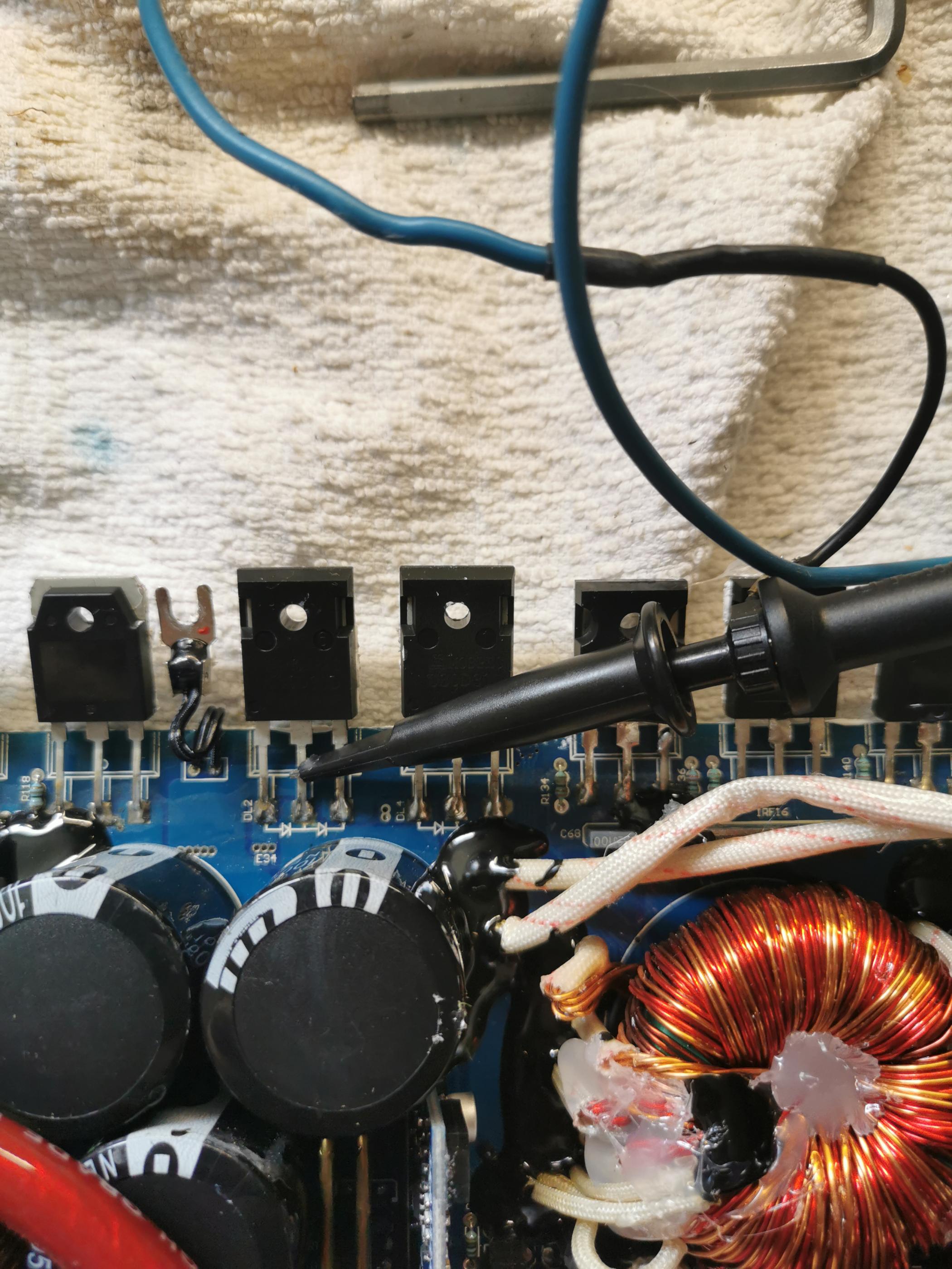

If you still have the amp, what's the ± amplitude of the waveform on the input to the rectifiers?
Use the secondary ground for the scope ground.
If you have that same waveform on every rectifier, I don't think you have a transformer problem.
